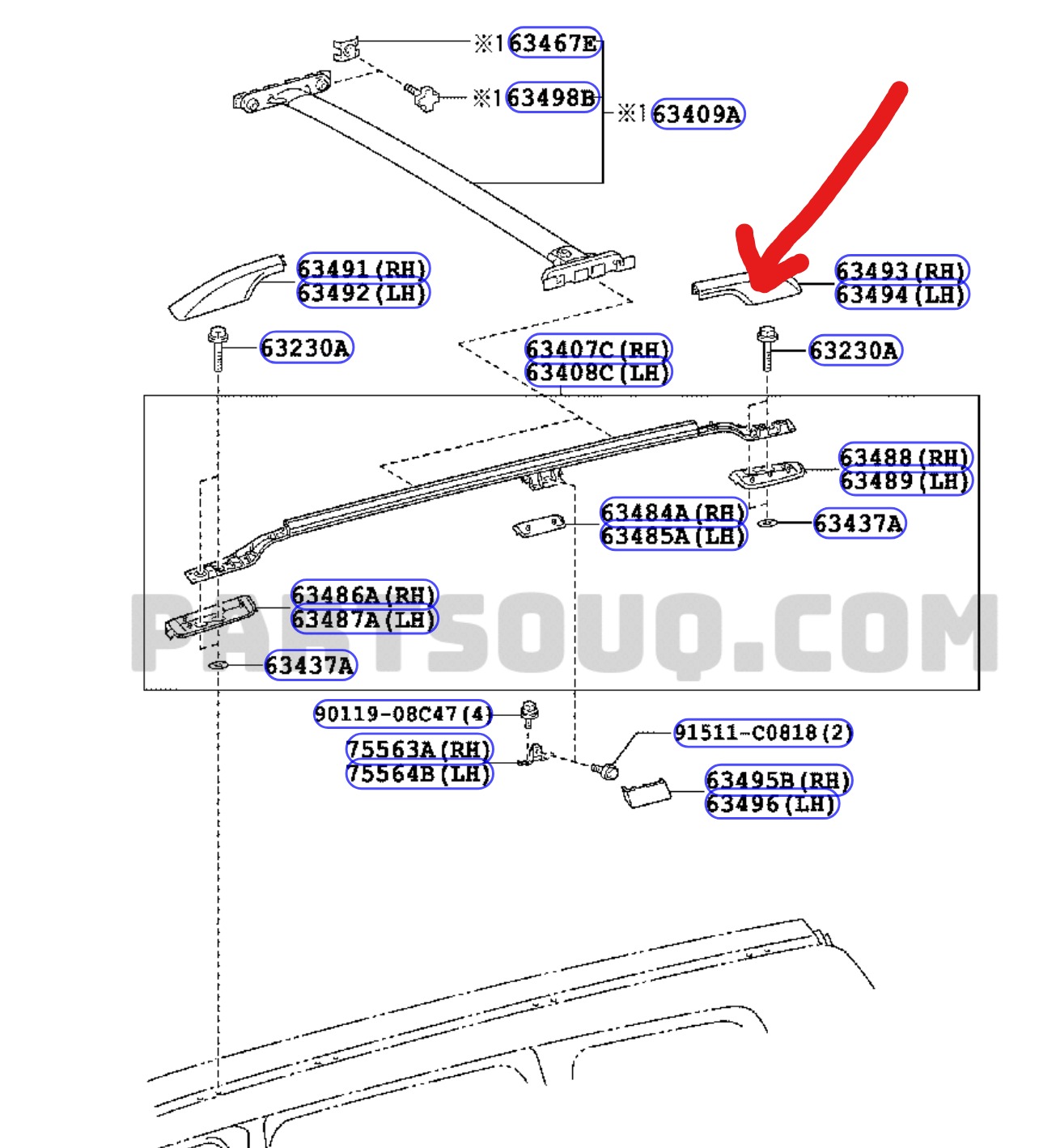

No tools needed. Remove the plastic cover at the rear supports on both sides. That leaves the end of the track open. Slide the rails out.
For those visual learners among us, this is the part that snaps off:
I found the easiest way to remove them is:
Gently pry up the outboard rear edge of the part until the outboard edge is up enough to slide the whole part straight back to remove.
HTH

A plastic pry tool is helpful to get the little catches released.
HTH

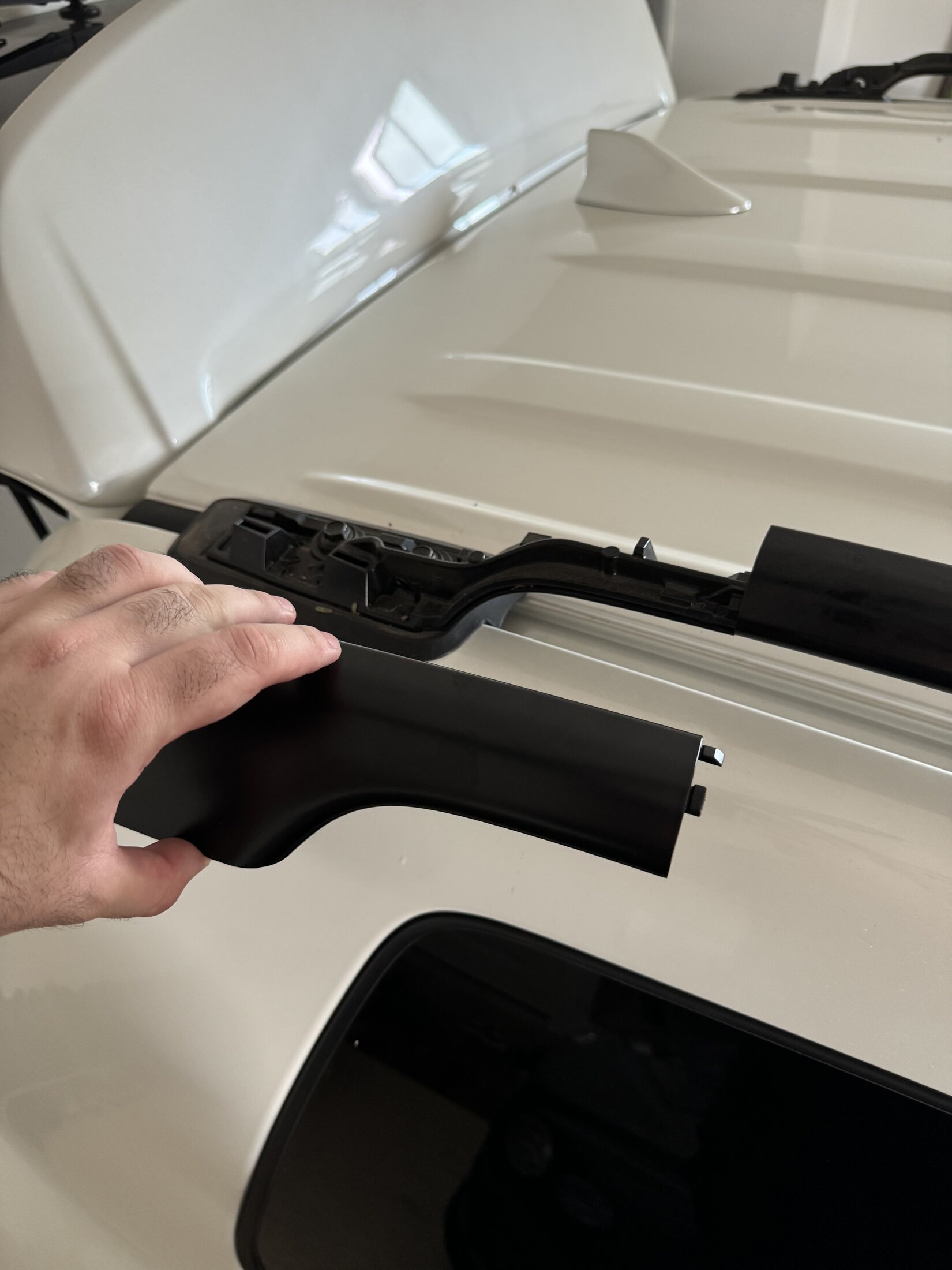

Used metal screw driver to loosen it then pulled it out with my hands. Then you just loosen the cross bars by hand, and then slide them out. Sliding out the front crossbar is much easier with two people (sister helped out 😂)
Not bad, took about 15 minutes, can be a lot quicker with experience
