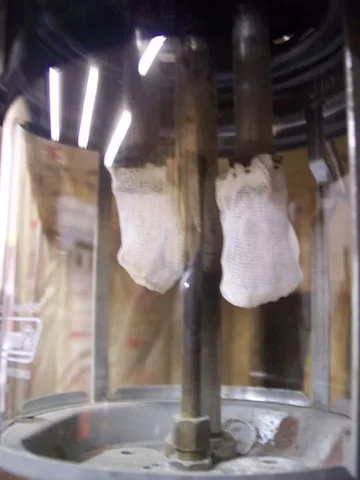

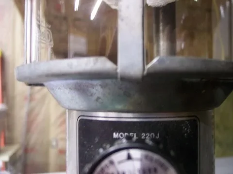

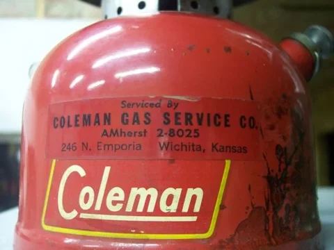

Anyone done it? I inherited the red one (model 200A) from my grandparents, and just got the green one (model 220) from my neighbor. Both need to be rebuilt from what I can tell. I put fresh Coleman fuel into both and got the following results.
The red one starts burning at the base of the brass feed tube and then lights the mantle, but it doesn't make it bright. The mantle glows (about 50% of it), then there's a fire around it, and black smoke coming out of the top of the lantern. The cleaning spud thingy in the back of the lantern is difficult to spin. The pressure pump seems to work.
The green one works (or did), but definately could use a thorough cleaning. The mantles weren't glowing as bright as I expected. The cleaning spud thingy is easy to spin. The pressure pump is very difficult to push back in. It doesn't seem like it wants to pressurize.

By the way, the red one is seeexxxy!

:lol: On fleabay, I saw a couple labeled "Sunshine of the night"......
Haven't seen one with that heat shield/reflector and handle combo thingy though.
