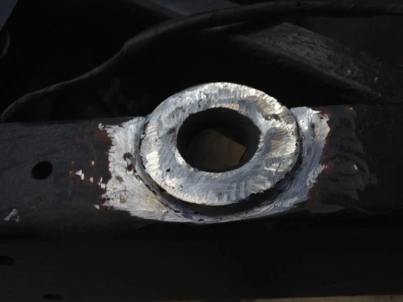

I trie my luck on a thick body mount today. Thanks for the tips guys. I had to turn the voltage way down. I have a hobart on a 220. I am going to test some pieces before i try my hand at sheet metal.
