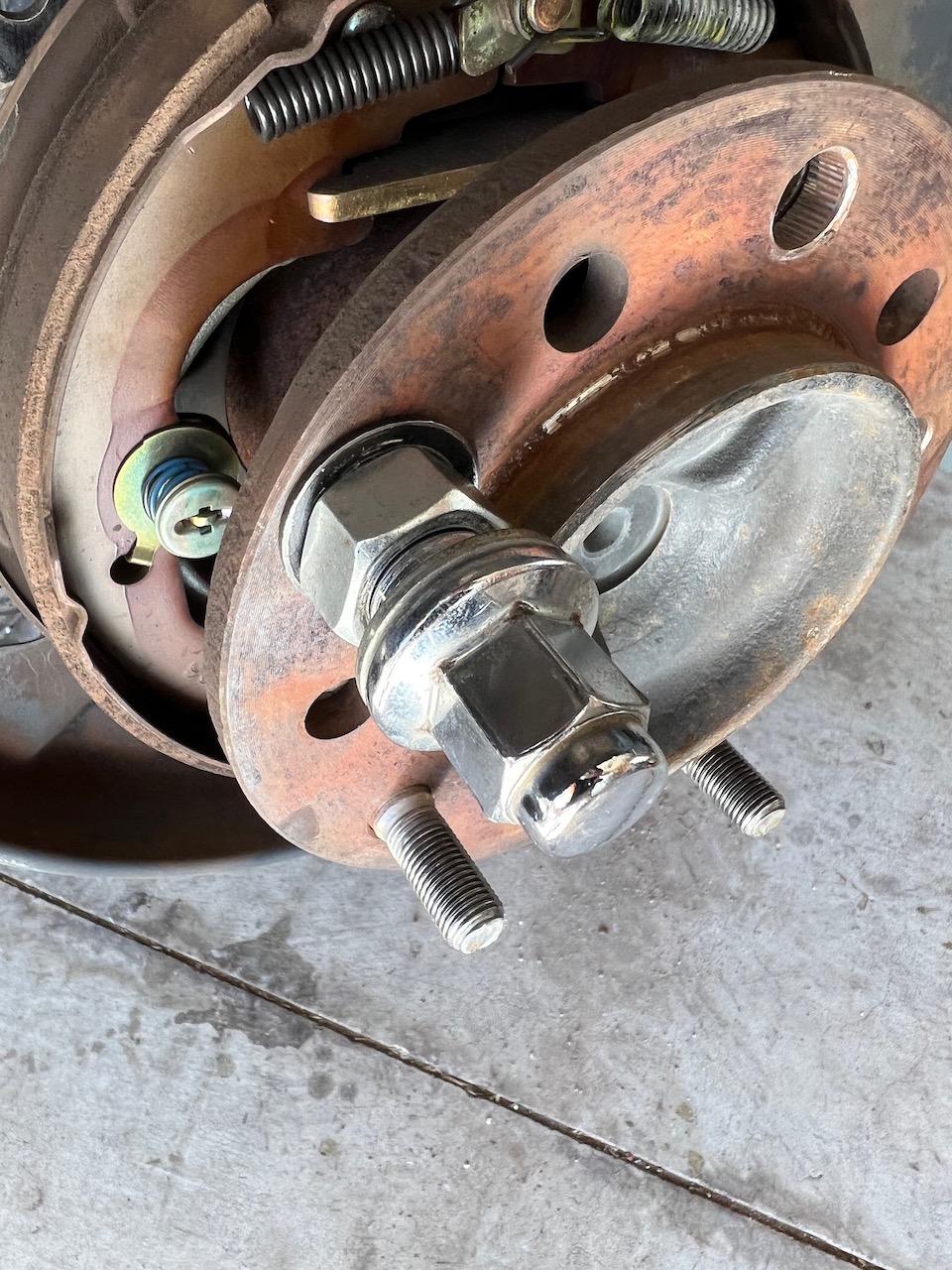

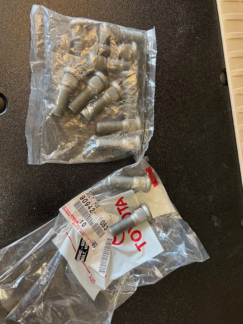

I ended up buying a wheel stud installer, heated the hub with a torch, and froze the studs installing. My spacer was too large the first time and didn't allow the nut to get threaded on enough threads causing them to strip from the pressure. I used a torque wrench to tighten the nut down and pull the stud through.

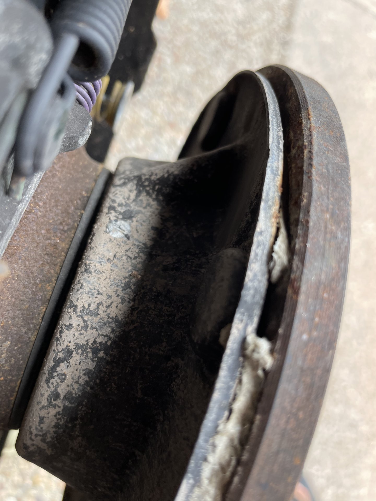

Dumb question, but on the rear hub there appears to be a cover for the wheel studs (my guess is that it’s the axle flange). How do I go about getting it off so I can get the new stud in?
If you are talking about the round part, that is just the back of the wheel stud.
Nothing else to remove except popping that wheel stud out now.

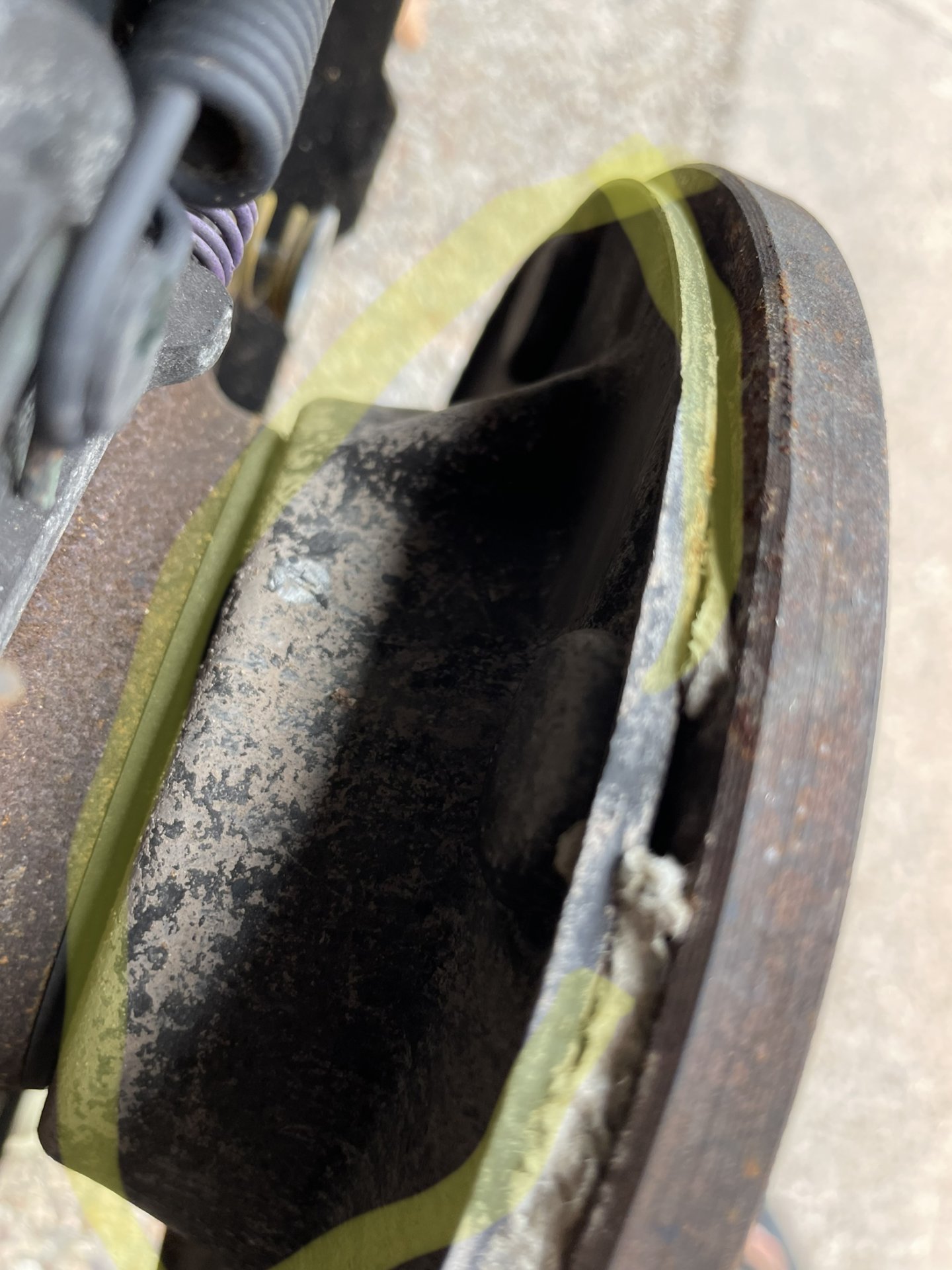

I’ve highlighted the backing plate. It appears to be covering the backs of all of the studs. It also seems like there is some kind of gasket sandwiched in between that plate and the hub.
That does not cover the back of the studs. There are holes in that plate where the studs go through.

Update: Came off w/o issue. And got the new one on in under 10 min using a 5/8 nut as a spacer! 😎
