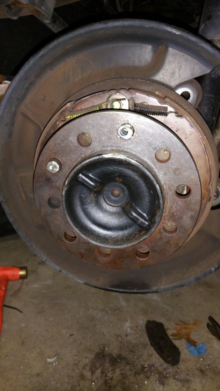

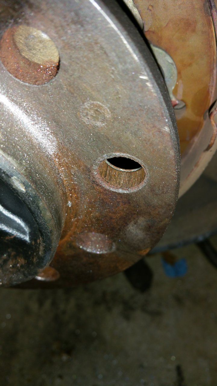

I posted previously in the "replacing rear rotor" thread, but I'm past that and stuck on two broken wheel studs. I think thesee last two studs are welded in, lol, at this point I'm trying to keep my sense of humor. I tried lots of heat and pb over the last 3 nights. tonight I added wax, which did draw into the stud hole but isn't doing anything to help. Tried an air chisel, and lastly drilling through, which BTW, was a ton of work but didn't relieve any pressure, still won't budge.
So, Im thinking I can put everything back together and admit defeat, or pull the axle, have the stud pressed out and do the rear wheel bearings "while I'm at it".
I have lots of new parts I'm adding, and I'd like to do all the work myself. I can live with taking a part to a shop with a presss and luckily I have another car to drive.
First pic show condition of one of the holes of the other studs.
Second is where I am at right now.
Any insight or encouragement is appretiated :)
Ouch, doesn't sound fun! I can't believe they are in there so tight.
Since you've got that hole in the one, can you follow up with a drill step bit? That might be what I'd try next. Would remove more stud material at least.
.... You see, that right there is what I needed. Step drill seems so obvious this morning....ARG! Thanks n55luvr!!!
I was just so worn out and frustrated last night. I got the hole started with a center drill and used slightly larger and larger bits till there was no more counter bore left, and my drill wouldn't cut new metal at the larger drill size. I figure if I can get to the side with a file on one side might be able to get it done.
Broke out the 1/2" corded Milwaukee drill, put the step drill and snuck up on the wall, switched to straight drills, worked up to 1/2". tried to peel the stud head off the back with a cold chisel, had to open th hole up a bit more by angling the drill till it finally succomed, WTF! Got one more, will get it tomorrow...

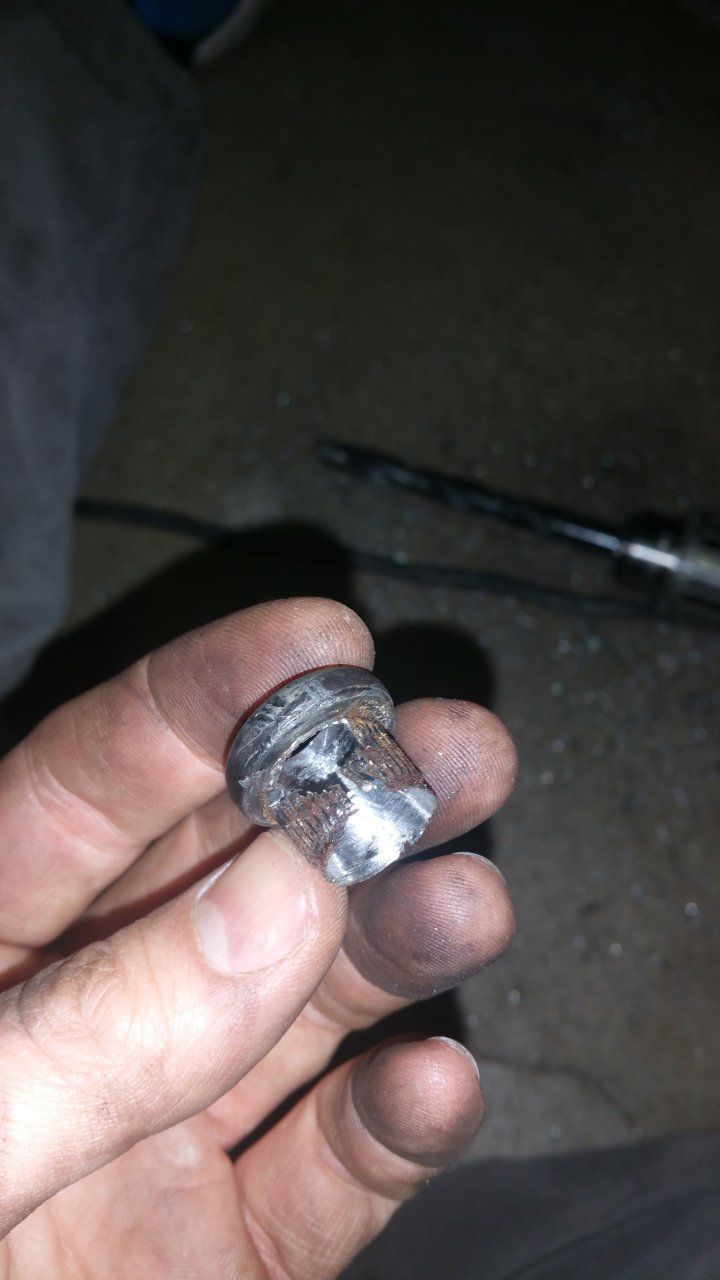

Got the last one this afternoon, alterbated between center-drill and straight drills untill i broke through the back of the stud. I don't think the strep drill will handle the pressure on its tip, that's why I drilled all the way through first. Took the step drill to the diameter smaller than the edge of the hole, then straigjt drill through. That created a very thin wall, and allowed the chisel pry the stud out.

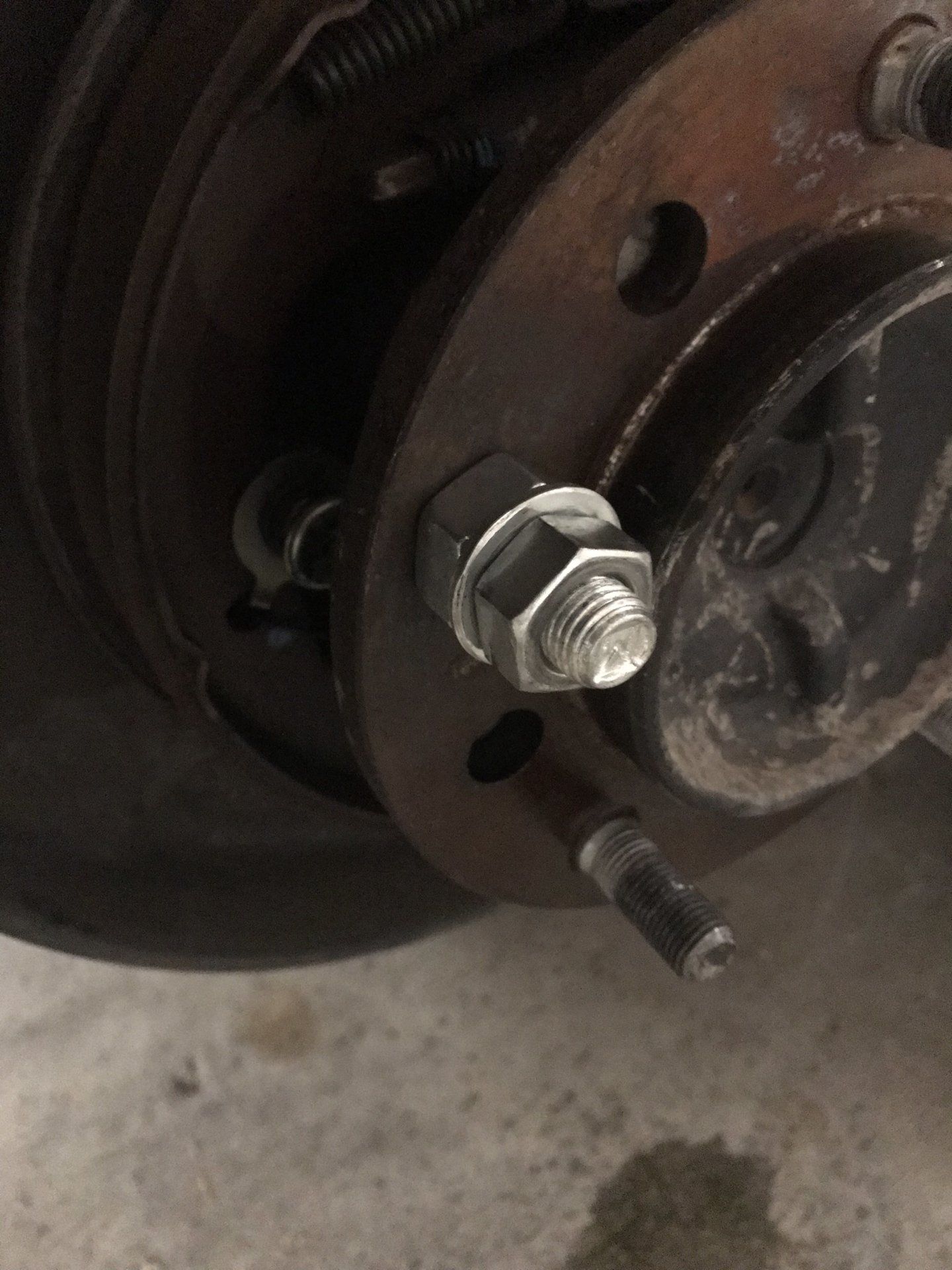

I nicked a lug trying to get the rear rotor off yesterday while doing the rear brakes. In hopes of having the car running on Monday I went to Autozone last night and got a replacement. Using the airgun / breaker bar I have managed to get most of the lug through. There are probably 2 mm left. These last 2mm seem impossible to get through.
My concern is that the threads on the lugnuts that I am using to pull it through are getting damaged. The lug itself is fine.
Any thoughts on what could be going sideways here?
Thanks
Albert
Thanks
Albert
What method are you using to pull the new stud through?
I've done a couple of these over the last month, and I'm using a M16 nut and a flat washer for a spacer, and then pulling it through with an M14 nut with the same thread pitch as the lug nuts. I then used a 22mm socket on a big breaker bar. It's worked like a charm for the ones I've replaced. I also installed a replacement stud from Autozone, so I'd bet they're the same PN.
