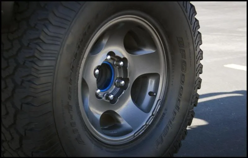

i think i bought 4 primer and 4 metallic gray. Didn't bother with clear coat. I still have 1.5 of each left over i believe. I did my spare too.
+1 on getting the old finish off. I used three cans each of high build primer and then Rustoluem Wheel Paint.

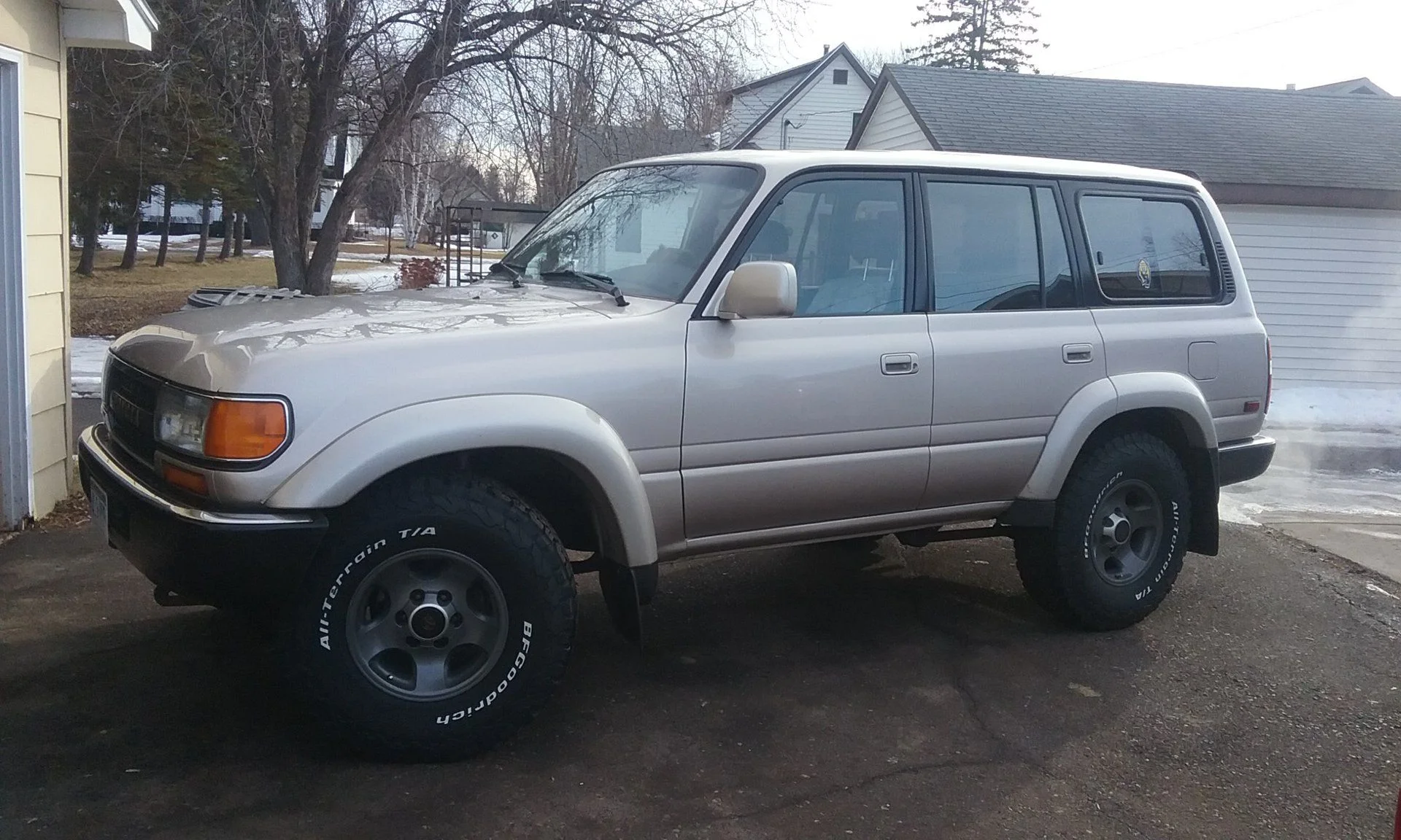

Those look way better than mine. Luckily I really never clean them.

I am a fuss budget about everything, but thanks :)

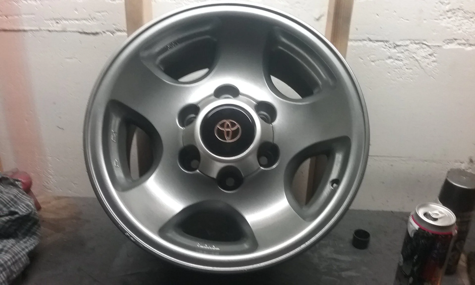

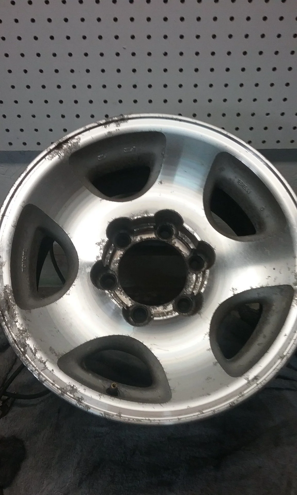

This is what they looked like when I started
Cool thanks for the tips. I was looking at the rust oleum stuff as well since it is much less expensive then others. How has it held up for ya?
It has held up really well! I did them about a year ago and they still look just like that. There is one really little gravel ding that I will touch up in the spring, but that's it. Like all paint work, prep is the key.

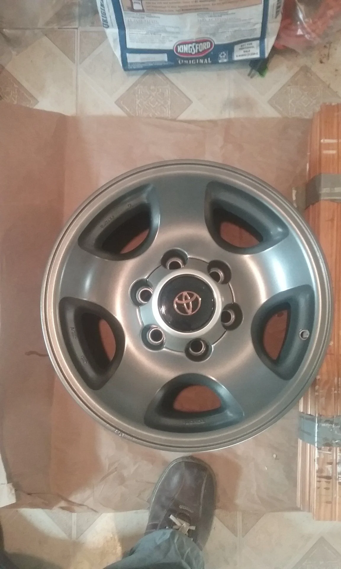

Here’s a stock set I did with VHT graphite.

Is the entire wheel panted the same color or is the surface of the wheel polished, etc?
Would media blasting be too damaging for that surface?
they look really good

It's not two tone. The finish looks different because the front of the spokes is smooth and the inner parts are more of a rough texture. It's all one color. Thanks for the compliment! I think they look pretty good too. I am still not sure if I want to stick with the color though as it seems to clash a little with the gold truck. I am thinking about repainting them and all the stupid gold trim to a dark, metallic root beer color to compliment the brown cloth interior.
