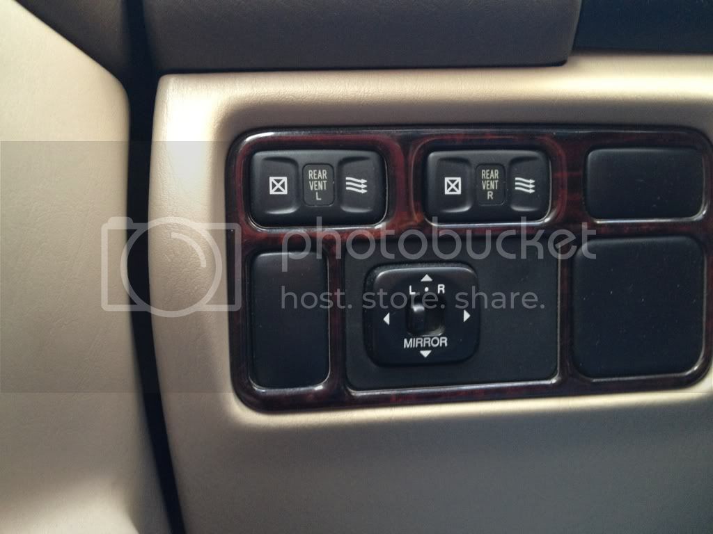

Im about to install my new bumper and will be mounting my HID lights on it. I plan on ordering a factory switch to go in one of the open blank spots here:
I started messing with it today but could not reach it from the back side and dont want to break any tabs. Whats the best way to pull this plate and install the switch? Or should I just pry out one of the blanks?

You can pry the blanks out from the front but you need to a small thin screwdriver or narrow knife preferably wrapped in thin tape to protect from scratching the front side of the fascia.
Or remove the lower dash panel to access the retention "wings" of the blanks from the backside of the panel...

The blanks can be pried out easily with a low profile flathead screwdriver from the top or bottom.

Great, thanks for the quick response. I have a couple of the blanks left over from the FJ but thought that plate might pull out like the surround around the stereo.

You can also use a credit card, it's less likely to damage stuff.
I picked up a cheap set of Harbor freight interior body panel tools. They work great and save a lot of wear and tear of the plastic fasteners.

Thanks, I just popped it out with my pocket knife without issue. Headed up to TRDParts4u on Wednesday to pick up my bumper and stock switch to fill in blank.
