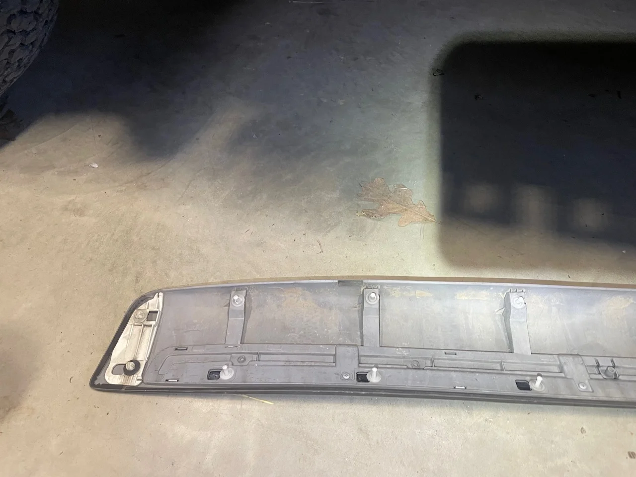

On my 2011 LX, it was double sided tape - daughters blow dryer and a pinstripe wheel (to remove adhesive) for a drill - problem solved.
I think 2013 is when the holes/clips started.
Just popped one off.
Easy using plastic pry tools.

Popping the moldings off is easy enough. Just go slow and let the plastic pry tool do its thing, i.e. don't just pull from one end and put too much force on the molding itself.
Removing the plastic inserts that remain in the door panel is harder and took me several attempts to figure out a method that didn't destroy them or result in broken plastic falling into the door panel. Here is a video on how I did it:
A couple times I was able to get the pry tool "fork" to push in the clips and the insert game right out. You just need to align the fork properly and to do that you need to see where the clips are. Most of the time, I needed the little screw driver like the video shows.
