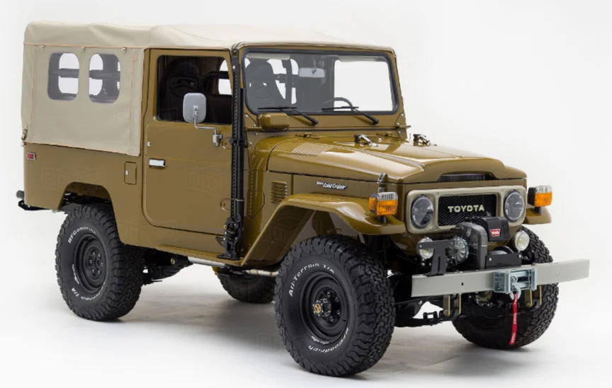

I don't want to use Rustoleum. I am pretty much decided on the Toyota Olive Green 653.
I think this is just a gorgeous color.
image_5baa4be78bd75_The-FJ-Co_smmpany-1980-FJ43-Land-Cruiser---Olive-68372---Studio_001.jpg
Also, the light bezel. I like that instead of white (which doesn't go with that green) or black (which I don't think looks good on these vehicles), it's a sort of tan/cream color. Beautiful!
