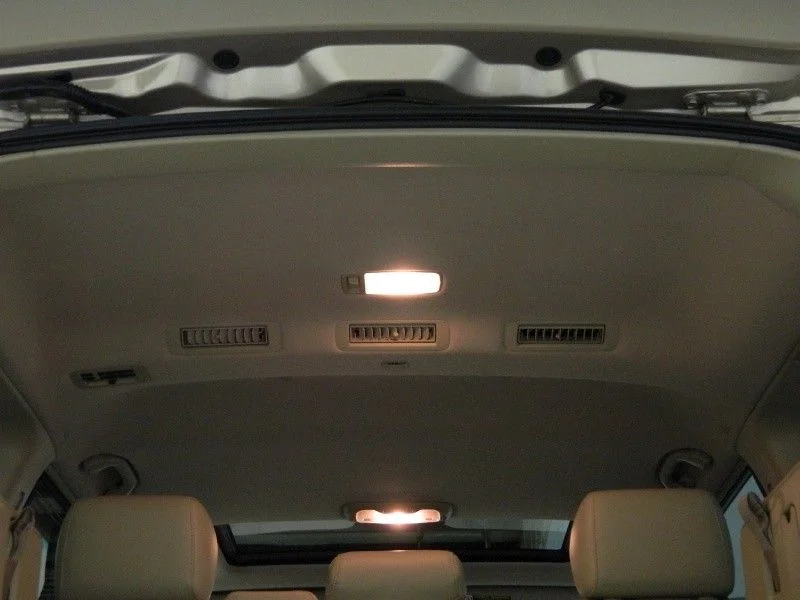

I have a 99 LC and the front was basically destroyed in an accident.I am down to my last part the AC Condenser. I ordered a used AC condenser and it is not wide enough for the mounts on the unit shipped. They claim it is the correct unit. I called a dealer and they were not able to tell me with the VIN #.I have no rear dials, just thet rear vent button.The old unit was basically destroyed. I checked the 10 or so pcs of the old unit and could not find a part number.Any help would be appreatiated. I lookinig to order a Denso unit today

You'll have vents in the headliner above the middle row (pointing at the 3rd row) and a temp control unit above the DS 2nd row passenger's head.

Here's a shot of the controls on a 2005, same as on a 99. The controls on the back of the center console are 2nd row audio.
