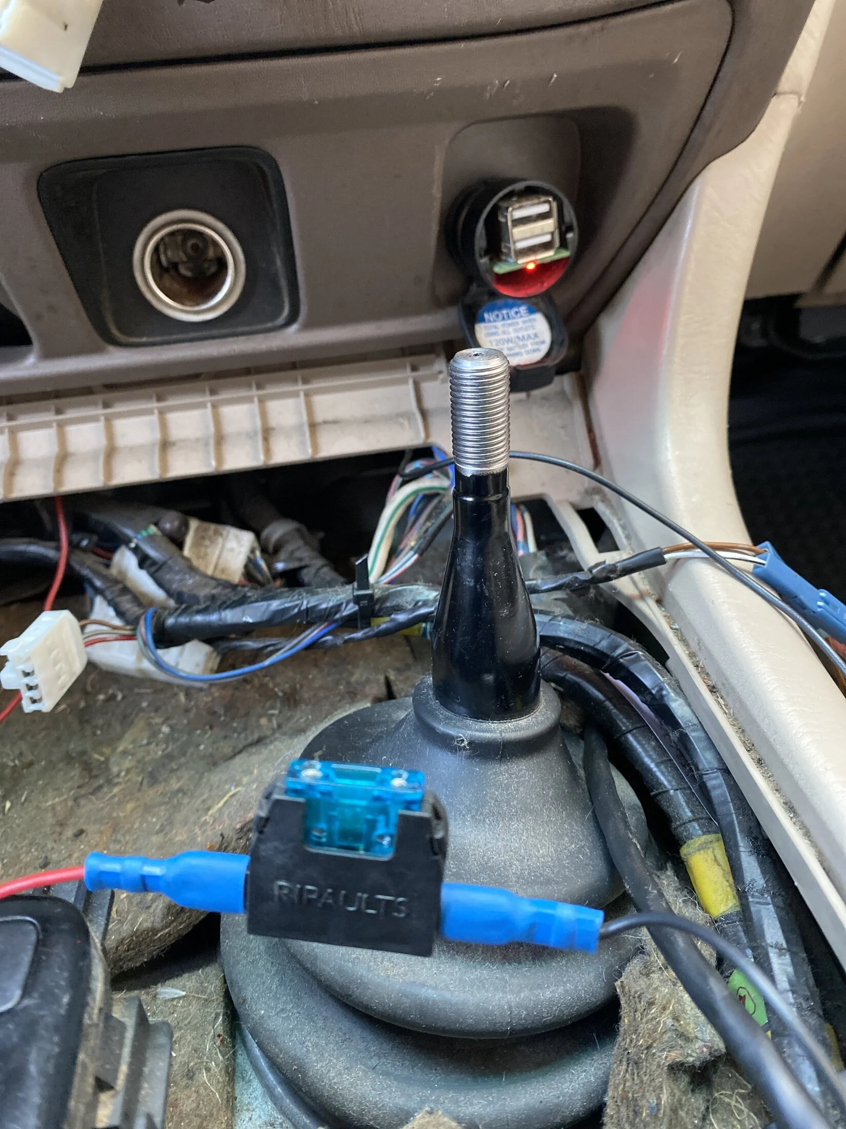

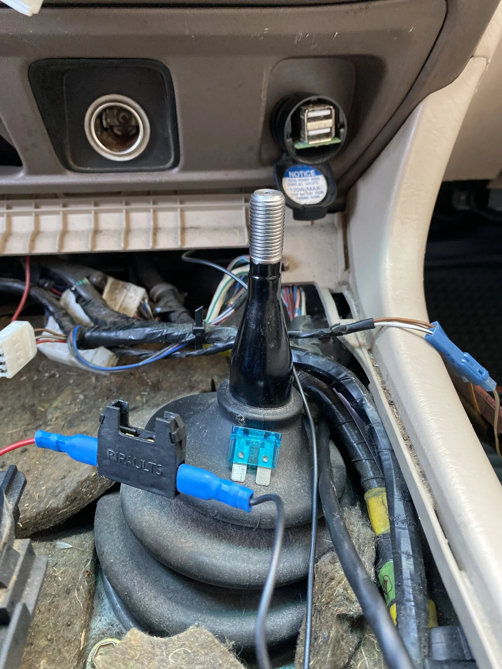

Turns out it wasn’t to the radio!
As you can see the red wire is for the outlet where you see the red light, right photo i took the fuse out and you can see it doesn’t send any power anymore. Anddd i’m probably going to clean the space there since it’s VERY dirty..

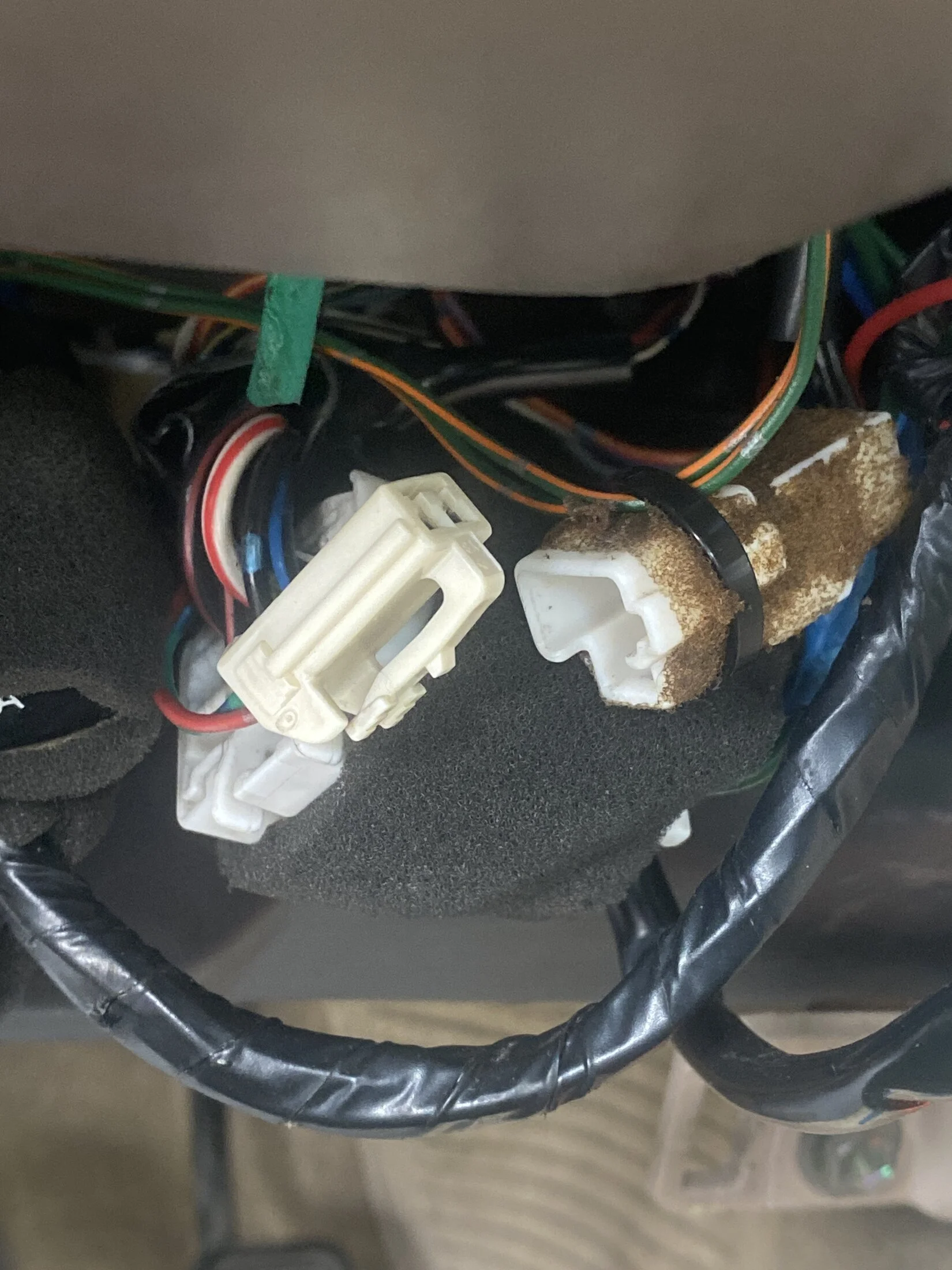

This car is a whole alien.. Anyways i found a way though to make the car shut up without pulling my horn fuse, i pulled this plug out around/under the steering wheel =
the honking stopped! I can still start my car normally and even use my horn again, this plug leads to the ignition ring light.. I don’t get how THAT’S setting the horn off, but this is only temporary because i’m probably gonna miss that light around the ignition but… My neighbors will thank me!
