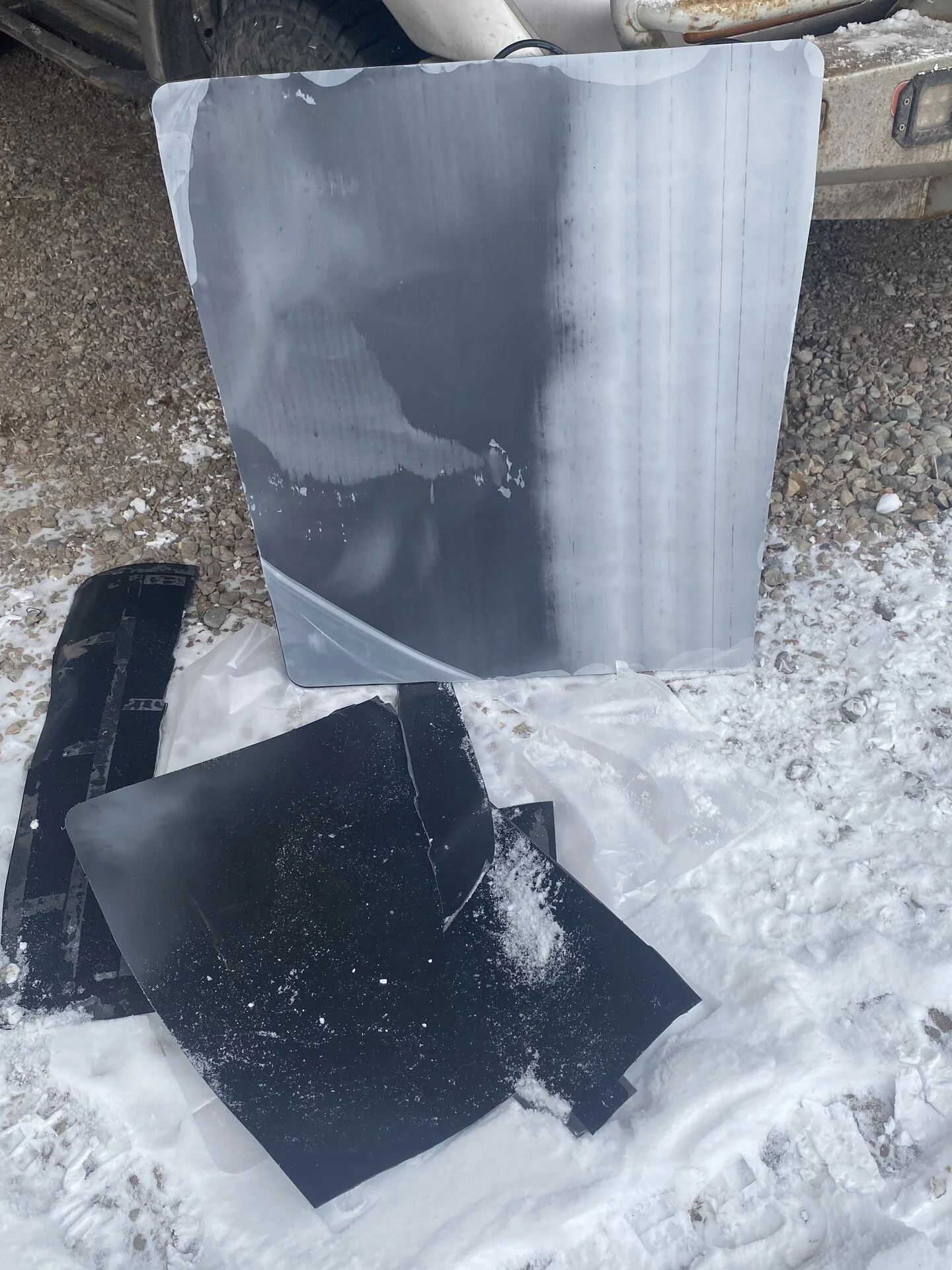

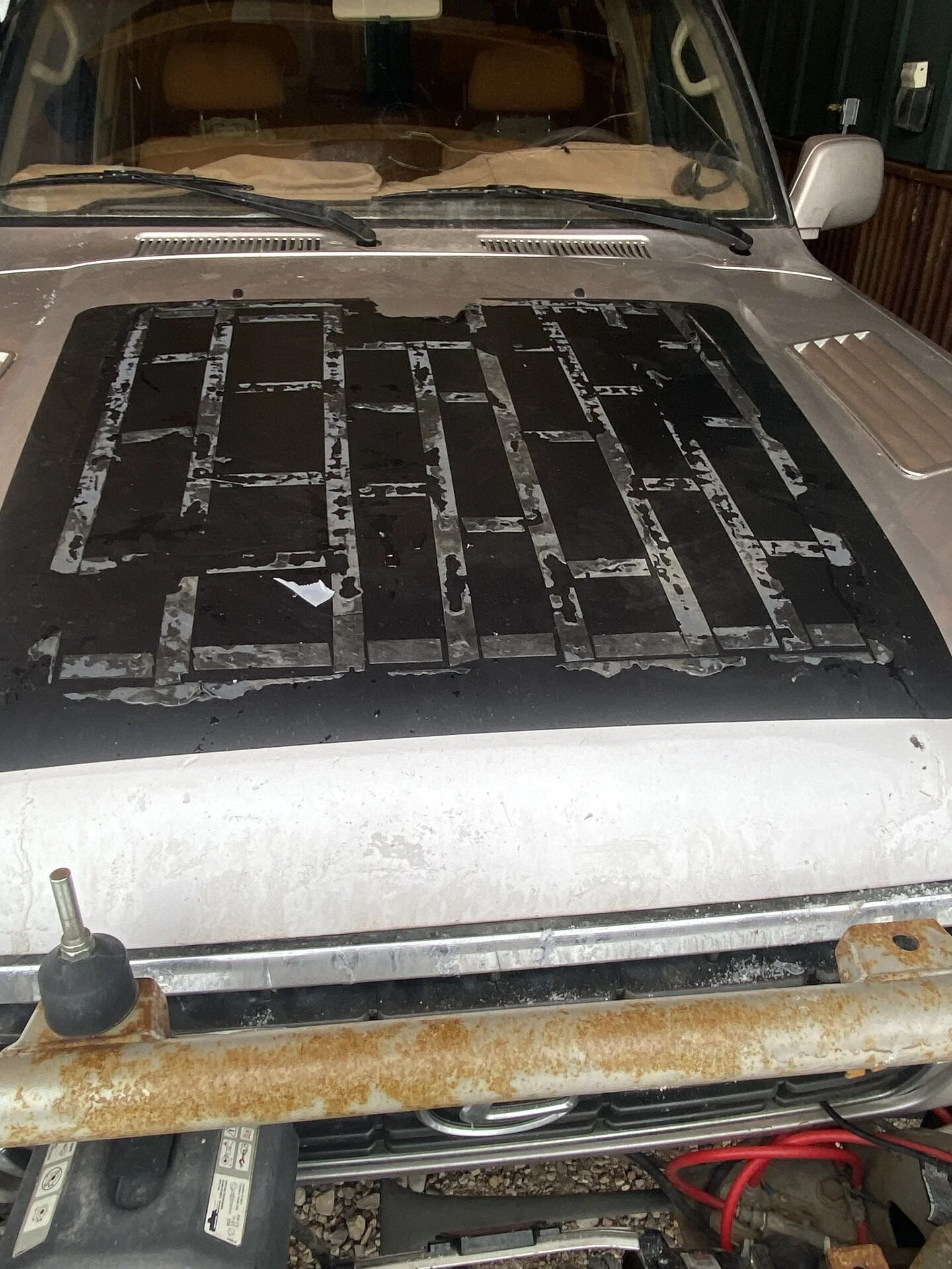

I removed the panel this afternoon, the solar panel portion came right off leaving a stiff plastic portion. I attempted the fishing line method with no results. I went to the heat gun by starting in the corner while continuously moving the heat source. It was a work out pulling up on the stiff plastic. I was mostly standing on my bumper and partially kneeling on the hood. Took about 30 minutes total.
Now the guy who installed the vinyl can steam it off.
Received another email from Lensun today, so my panel did not delaminate, a second backing panel stuck to the back/bottom of my panel. That’s the broken up piece in the photo. The foggy white plastic sheet is supposed to separates the backing panels during manufacturing/assembly.
There sending out another vinyl sheet and if the solar does not work, they will send out a replacement. I’m impressed with their customer service.
