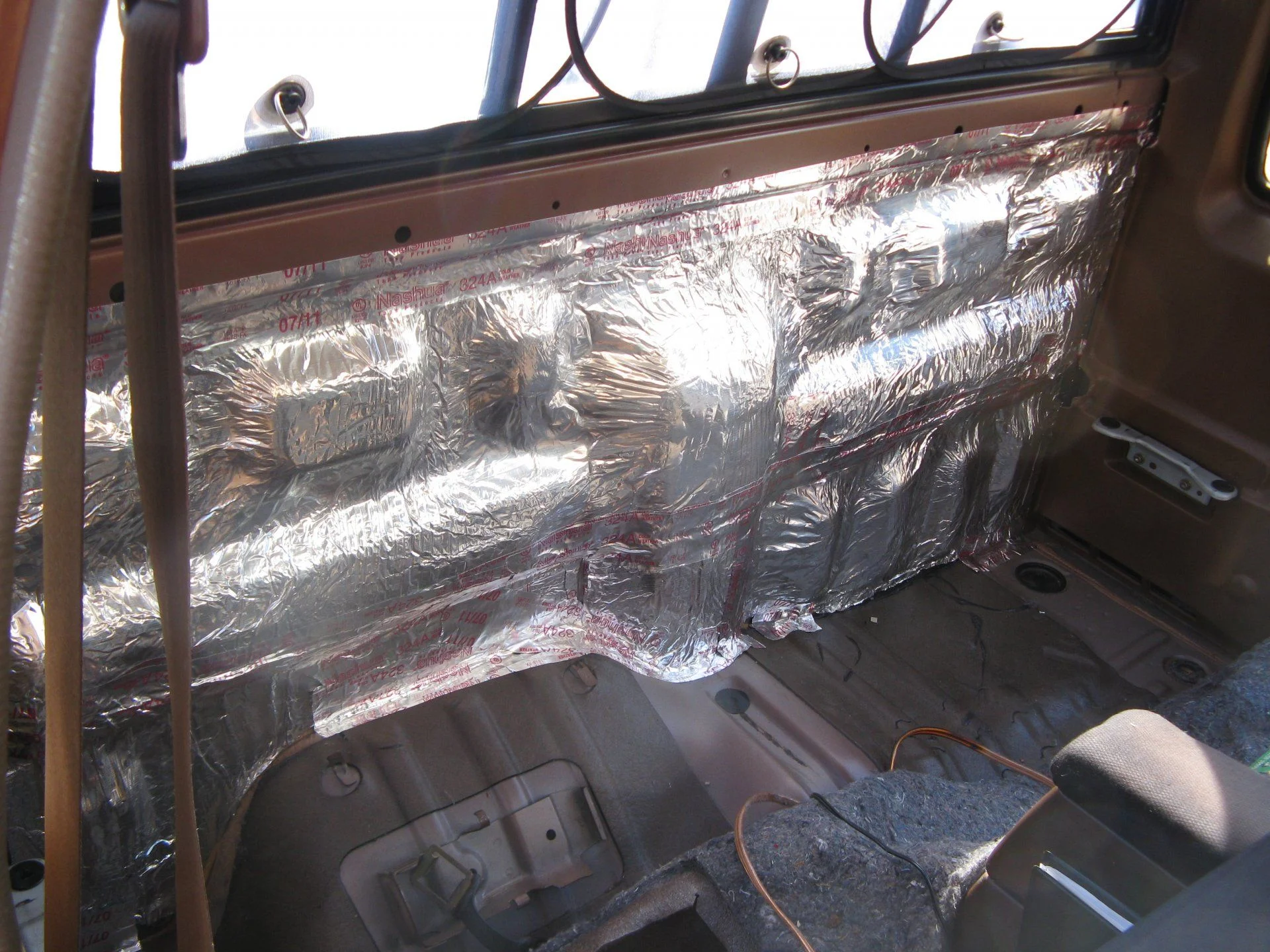

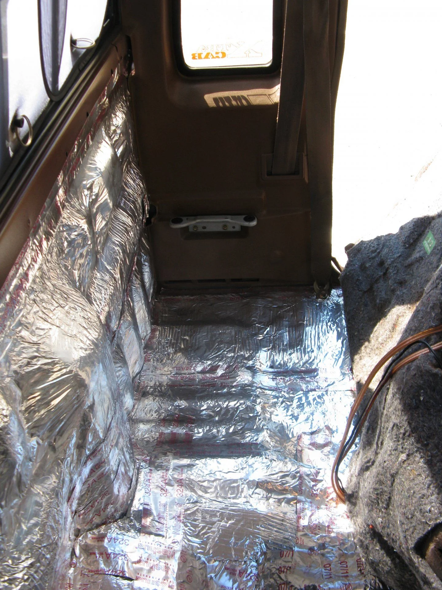

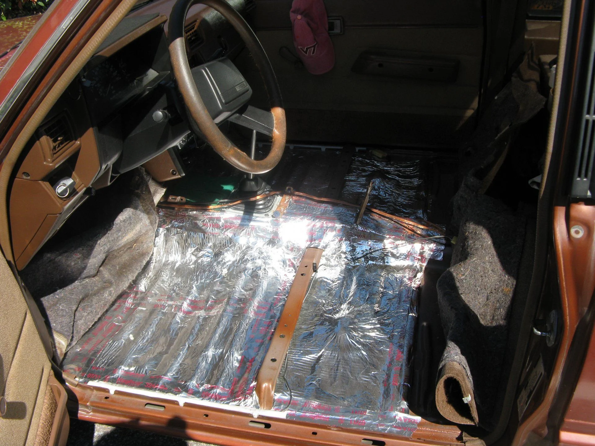

I used a home ventilation insulation material called Frost King from Home Depot. I added it under the hood as well as interior sound and temp insulation. It's a 1ft x 15 ft roll of 1/8" close cell foam, foil faced, with a self stick adhesive backing all for $20 with VA tax. It's called a poor mans Dynamat. Take your time and press it to the contours as you go along. Buy top quality aluminum adhesive tape. Not the cheap ass kind I used with printing on it in these picture as it doesn't stick to the foil face well. The plain thicker stuff does and I used that on the under hood insulation. Cost more but you'll find a use for it elsewhere. You can peel the heat foil off the initial layer to add a second layer if you more noise reduction.
I added it to the interior firewall, trans tunnel (2 layers). Closed-up the shifter lever tunnel hole (a lot of noise comes in there), floor, behind the door panels, and on the back wall. It dampens the metal and does block higher pitch sounds. It make the truck so much quieter. Had a shop press in new rear wheel bearings and the guy who took kit for a post install test ride couldn't stop commenting on quiet that truck was. I was playing the radio and actually heard more details in the music come through.
Give it a shot as the under hood layer I added did help quiet the engine bay noise. Sorry no hood shots as of now but looks similar
