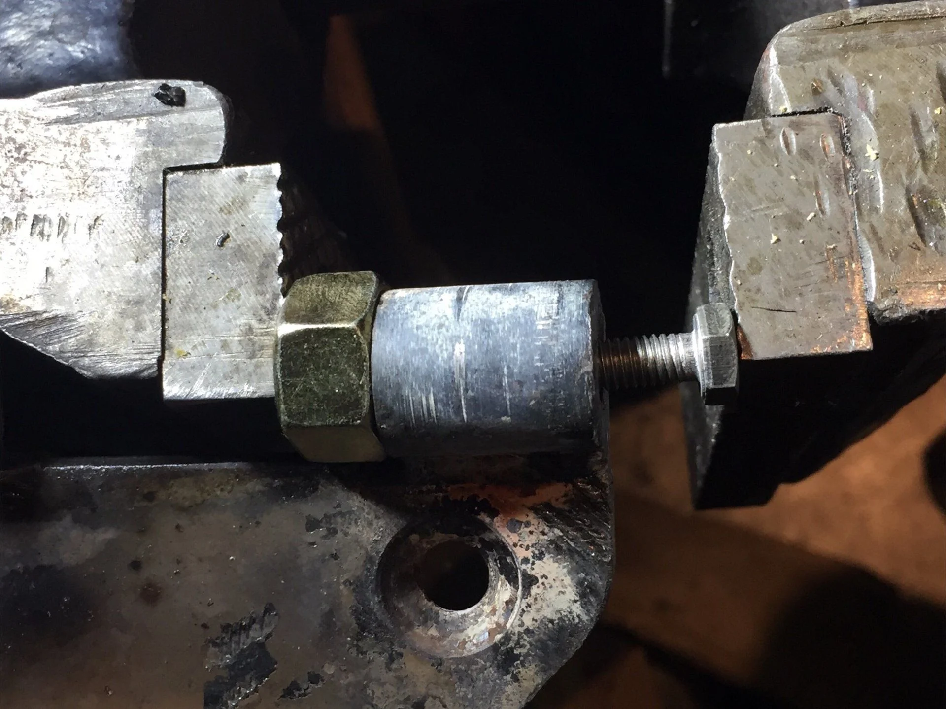

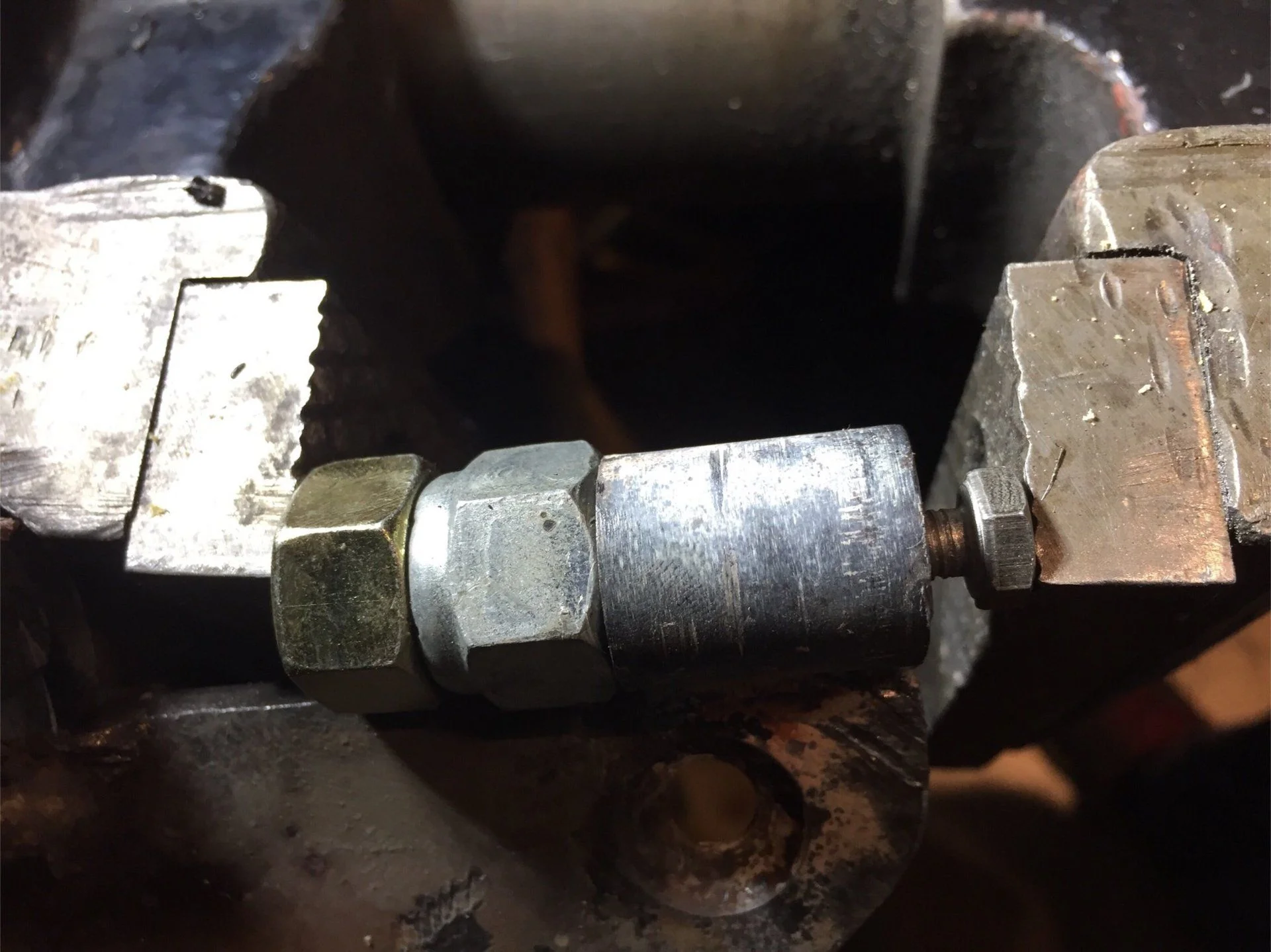

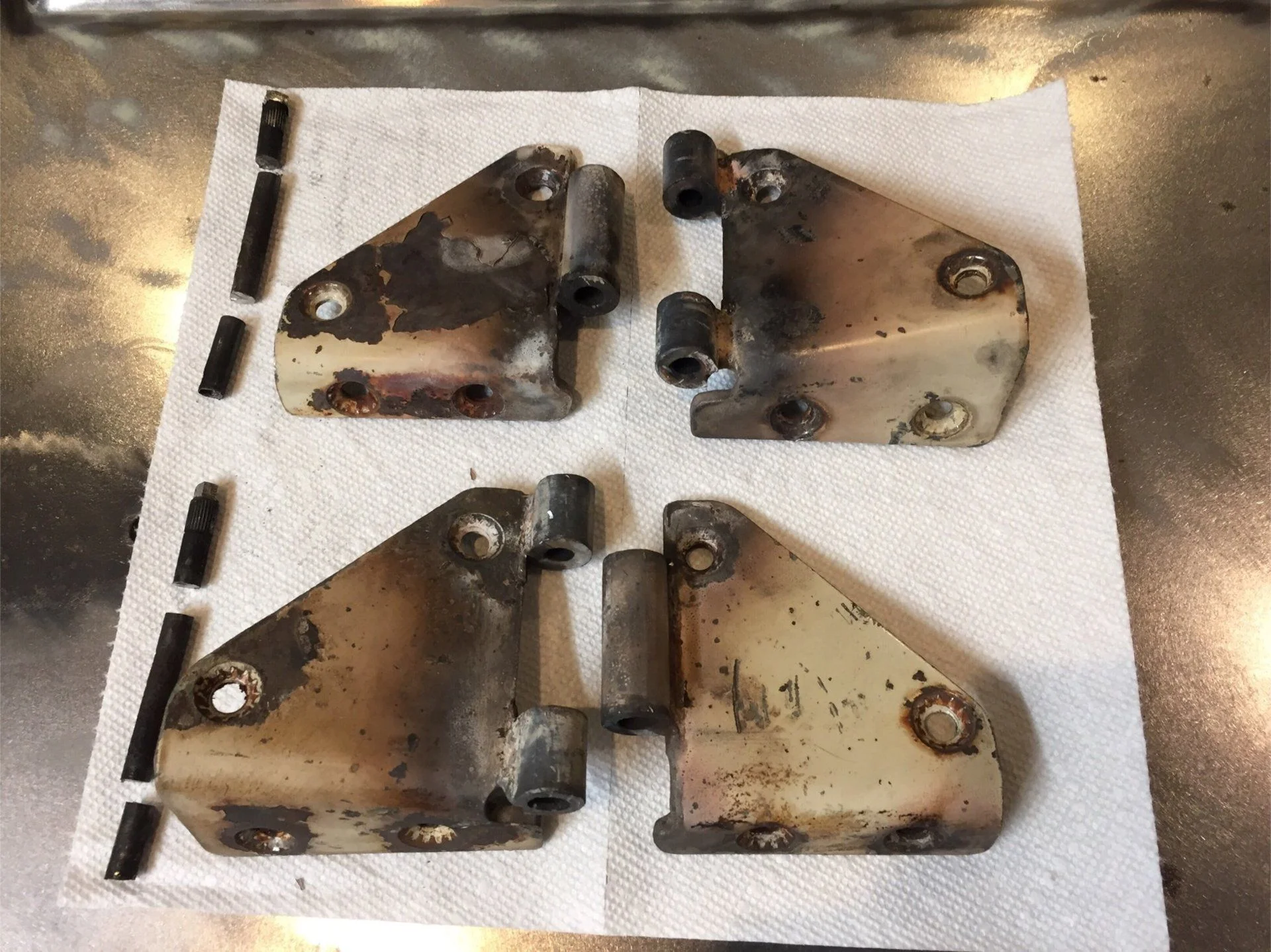

I did battle today with windshield hinge pins off my 71 40 today. Here's basically what worked for me. I heated the hinges to 1000+ degrees with map gas which melted the plastic bushings. I then sliced the pins where the 2 bushings once were. Used a Dremel EZ lock metal cutting disc to cut the pins. The discs are thin enough to cut just the pin and not eat up the hinge. This allowed the two hinge halves to seperate, the long section of pin in the center just fell out thank goodness. Next I drilled a pocket in the remaining 2 short pin sections and used a bolt to press the pin sections out. Squeezed my vise as tight as possible with a cheater and actually had to wail on my vise with a BFH for the pins to budge. Used a big nut or two on the opposite side to keep the pin away from the vise.
Photo of pressing pin segments out
Nuts as a backer
