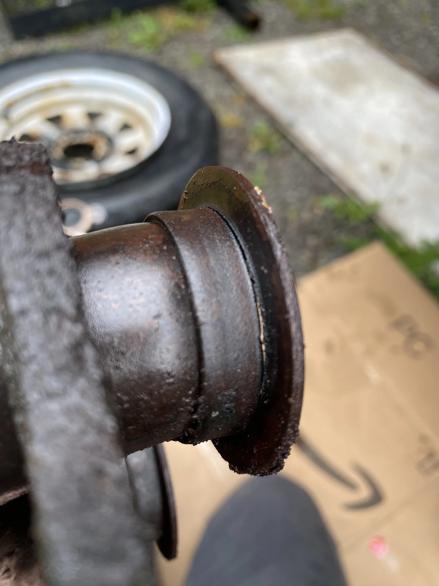

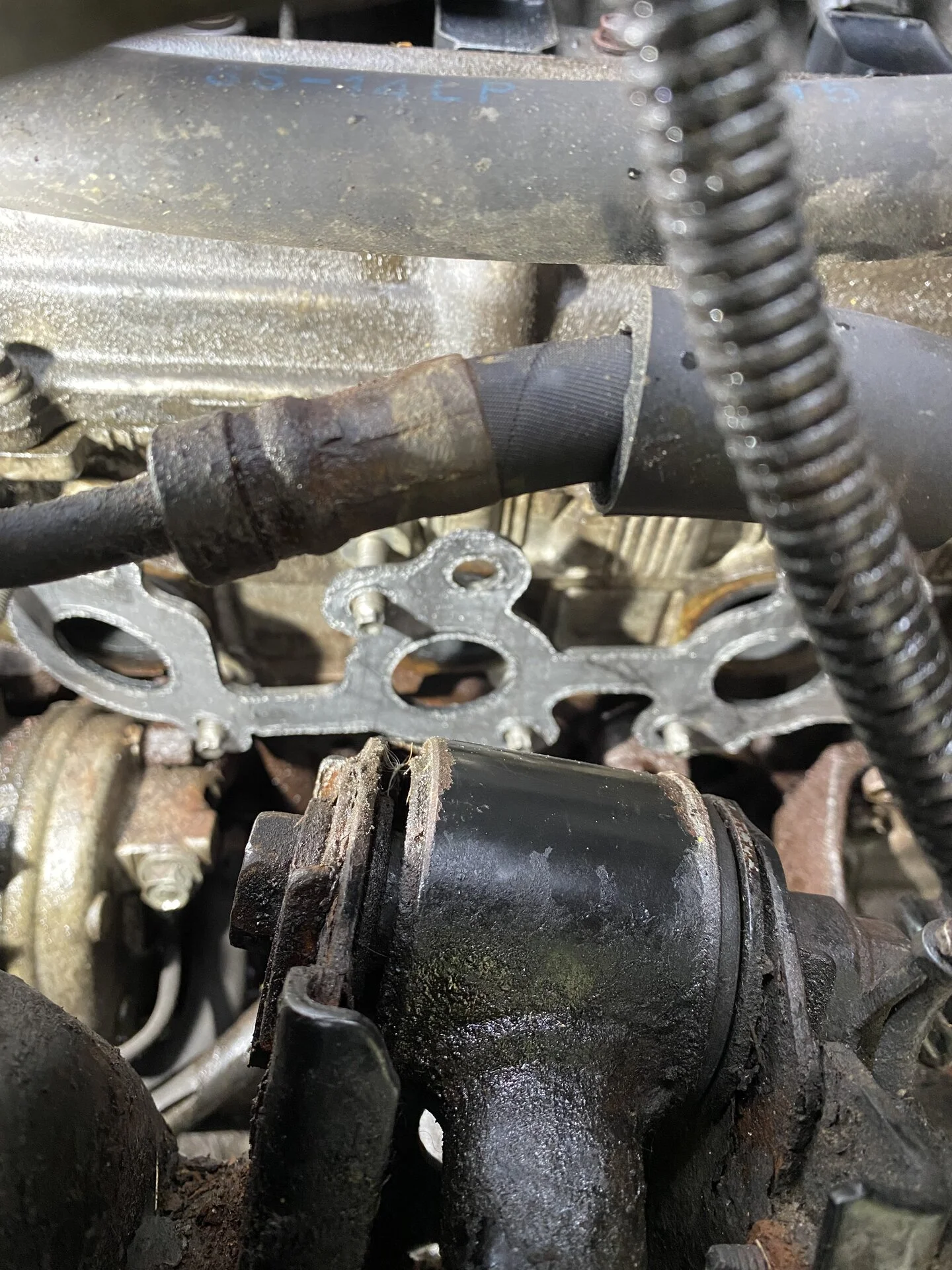

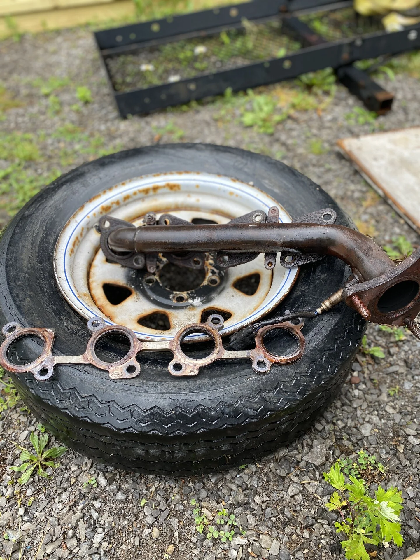

I did a write up of my DT header install. I didn't find it that hard, just tight working areas in some spots. I detail some tools that make it way easier.
I did them on my GX470 over a weekend (Fri-Sun). All-in wrenching time was probably ~20 hours in my cramped shop. I've done virtually all my own wrenching for ~25 years now and it's still the hardest job I've ever done. I'd put it in the "difficult" DIY category. It's not precision work like let's say building a motor, but you need enough wrenching intuition to be able to create a 2-ft long string of wobble extensions, U-joints, normal extensions, etc to be able to get at the manifold studs/nuts through the inner fender. My rig is also a VVTI rig which is undoubtedly more difficult. Maybe ya'll have a bit more room in a 100.
Other challenges were rounding off a few of the nuts due to a bit of rust and terrible angles. I ended up having to cut/grind the studs/nuts of the manifold with a flex attachment and griding wheel on a Dremel (took around 20 minutes put nut/stud), then weld a nut on to what was left to the stud (after manifold removal) to get it out. I also cut down a deep socket to make it a "mid deep" for putting the nuts back on. So you need a pretty diverse array of tools to get the job done unless your rig is in pristine condition.
I re-tightened the manifold studs after around a week of driving, nearly 2.5 years ago. Zero issues since then (other than some collector bolts coming loose). I used VVTI Fel-Pro manifold gaskets that were made in Japan and identical to the OEM MLS manifold gaskets, so I'm guessing they are indeed reboxed Toyota gaskets. The coated headers still look pretty good as well.
End result was totally worth it - my GX rips with the LT headers, CAI, exhaust, tune, and upgraded valve body.

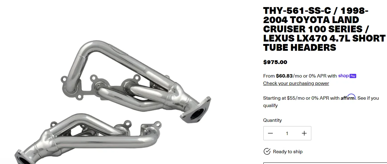

Why would these not fit an '06?
You might also have to delete or modify the SAIS system since the air tubes would be gone. It would be best off to get the VVTI headers.
