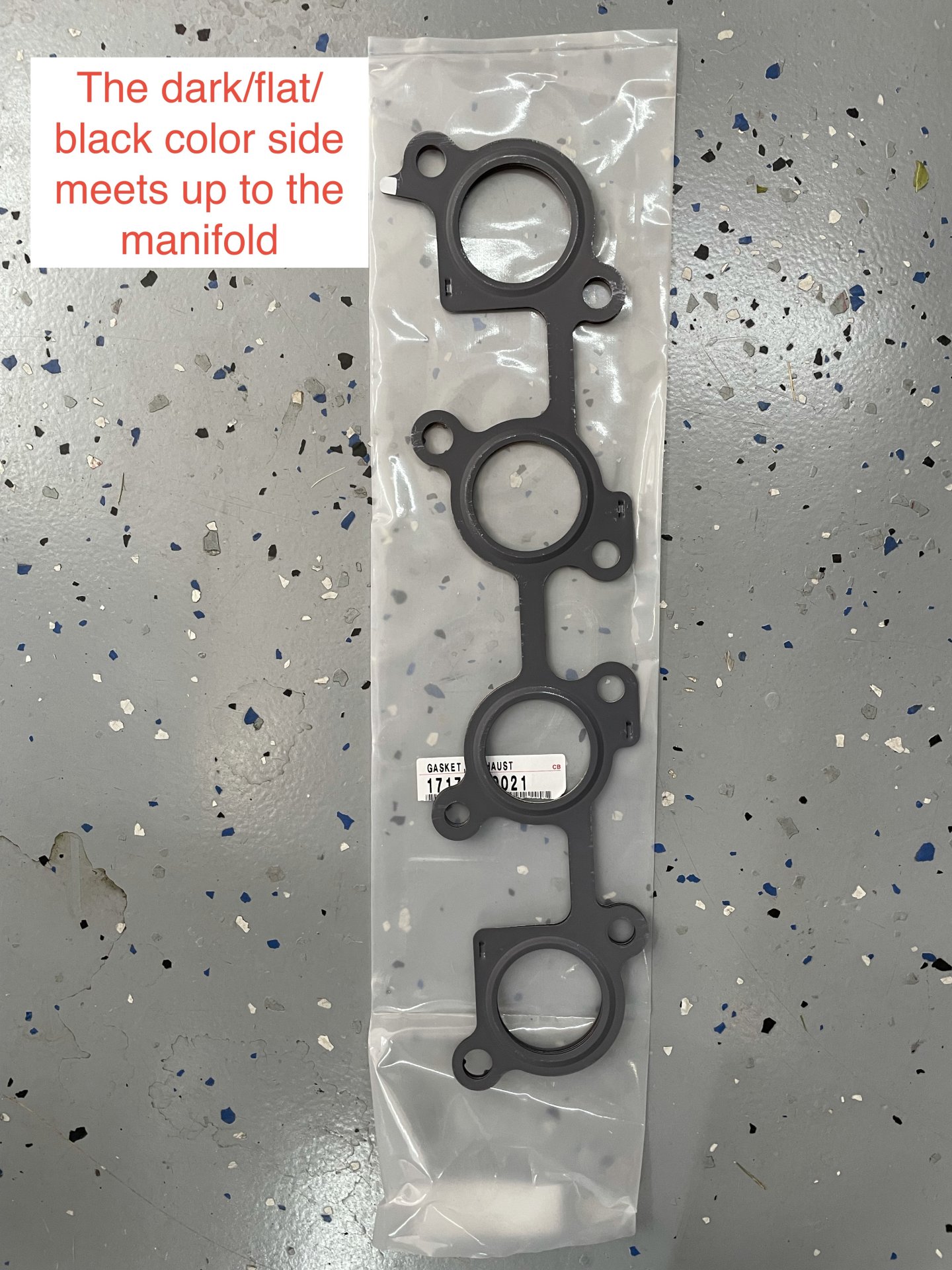

13. Remember that if you're using factory manifold gaskets, to have the white mark facing OUT towards the manifold.

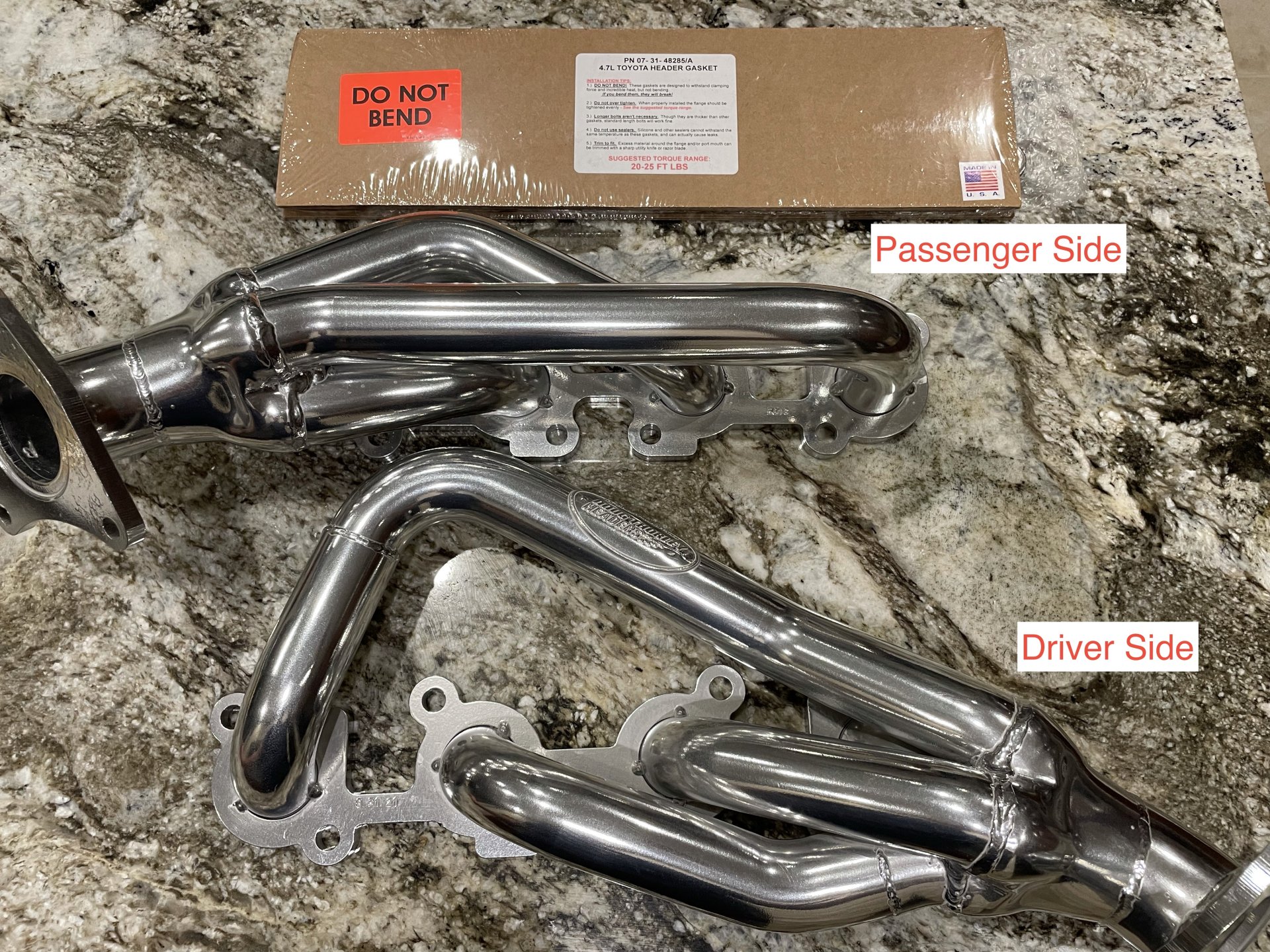

What I did notice is that DT headers are shaped differently. Driver side has a larger footprint and needs more spacing to install vs. passenger side. So, this makes working on the driver side harder because the space itself is limited and the new header is larger than the passenger side.

Here's the DT headers (right and left) to show the different shape/design. Passenger side is skinnier and easier to install into a small space vs. driver side.

Here's the OE Gasket used:
