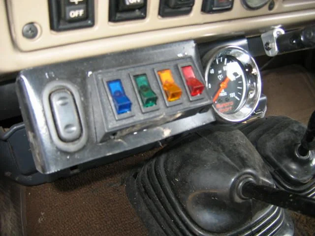

for the remote in out switch i used a window up/down button in series with a lighted swith, to arm the winch. there is no electrical lockout to the relays themselves so i obviously cant use both controls at the same time. this is in a 83 bj60 so its not quite as pretty as it would need to be if i installed it in a prado, but just an idea for your build.cheers.
