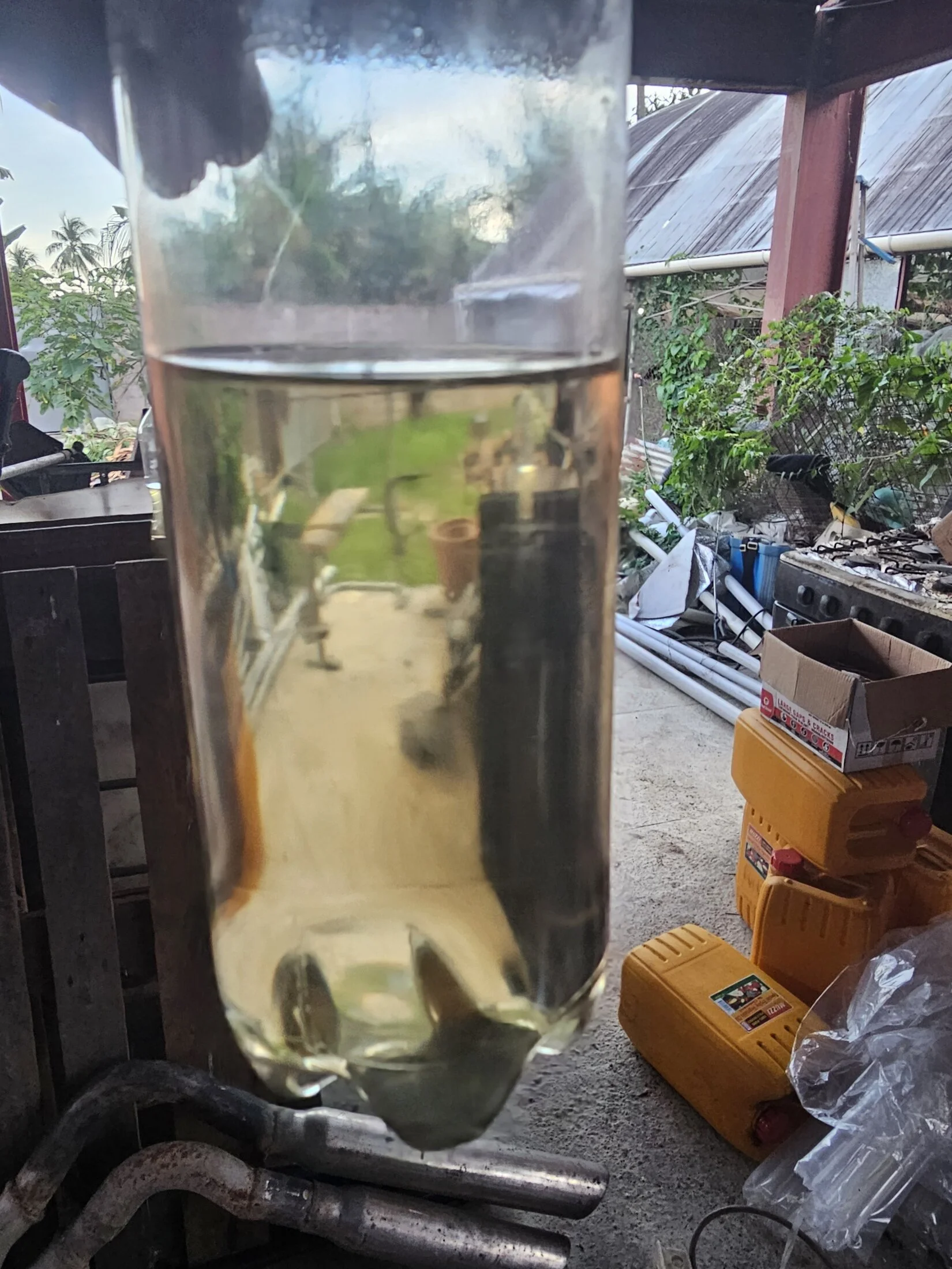

Poured some diesel in a clear bottle, no signs of any water.

Here's the diesel I put in a bottle from after primer pump
