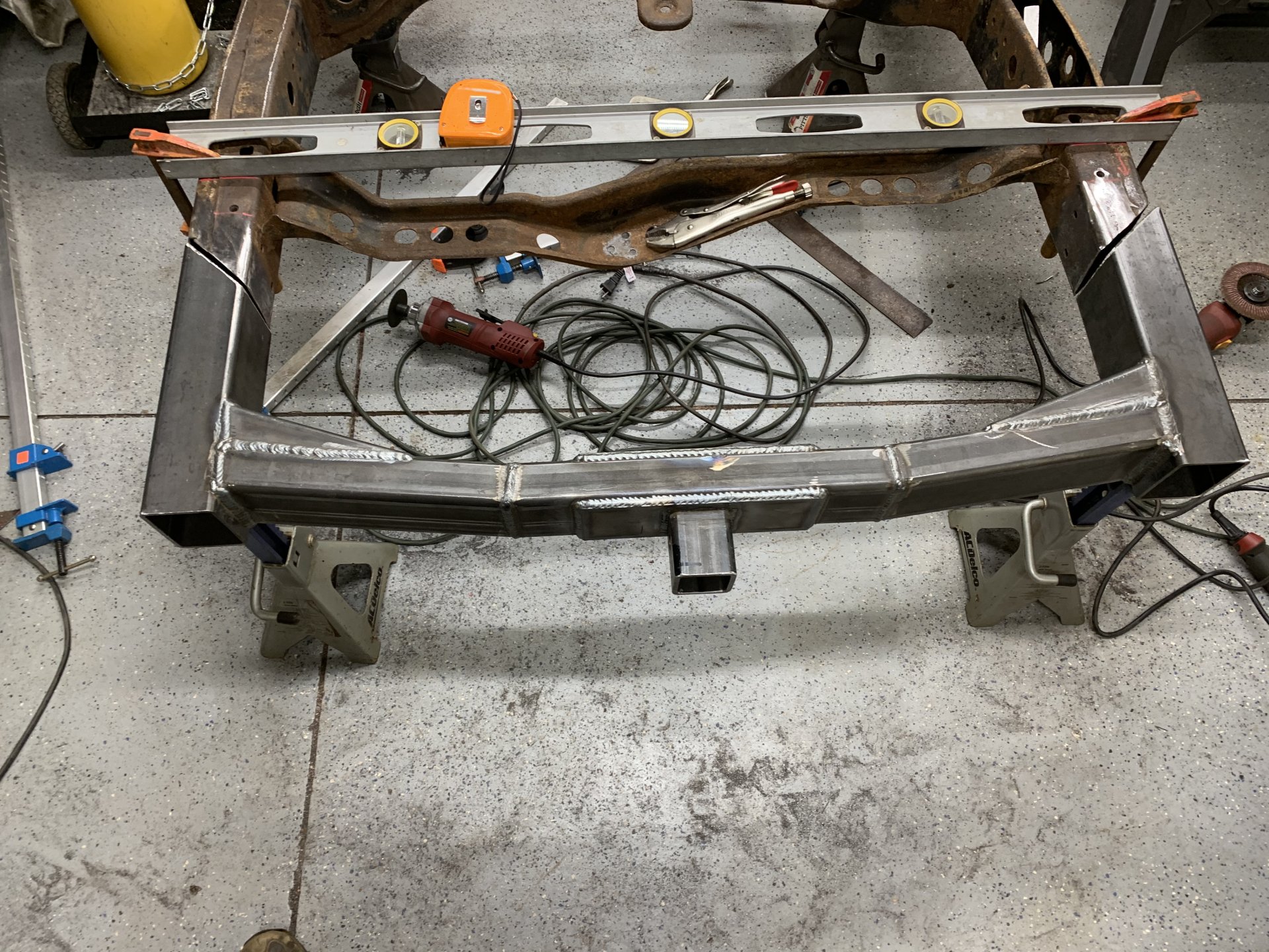

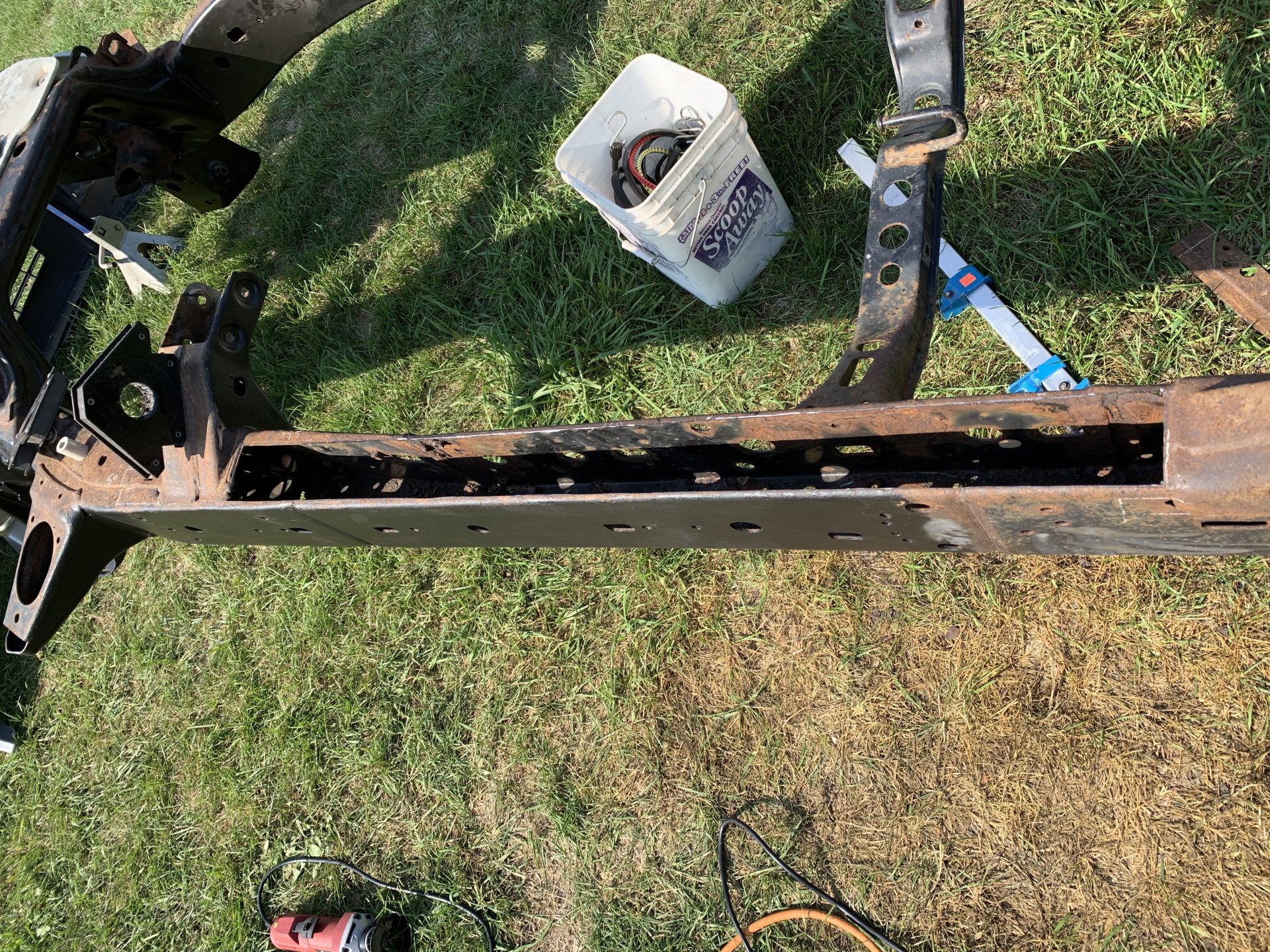

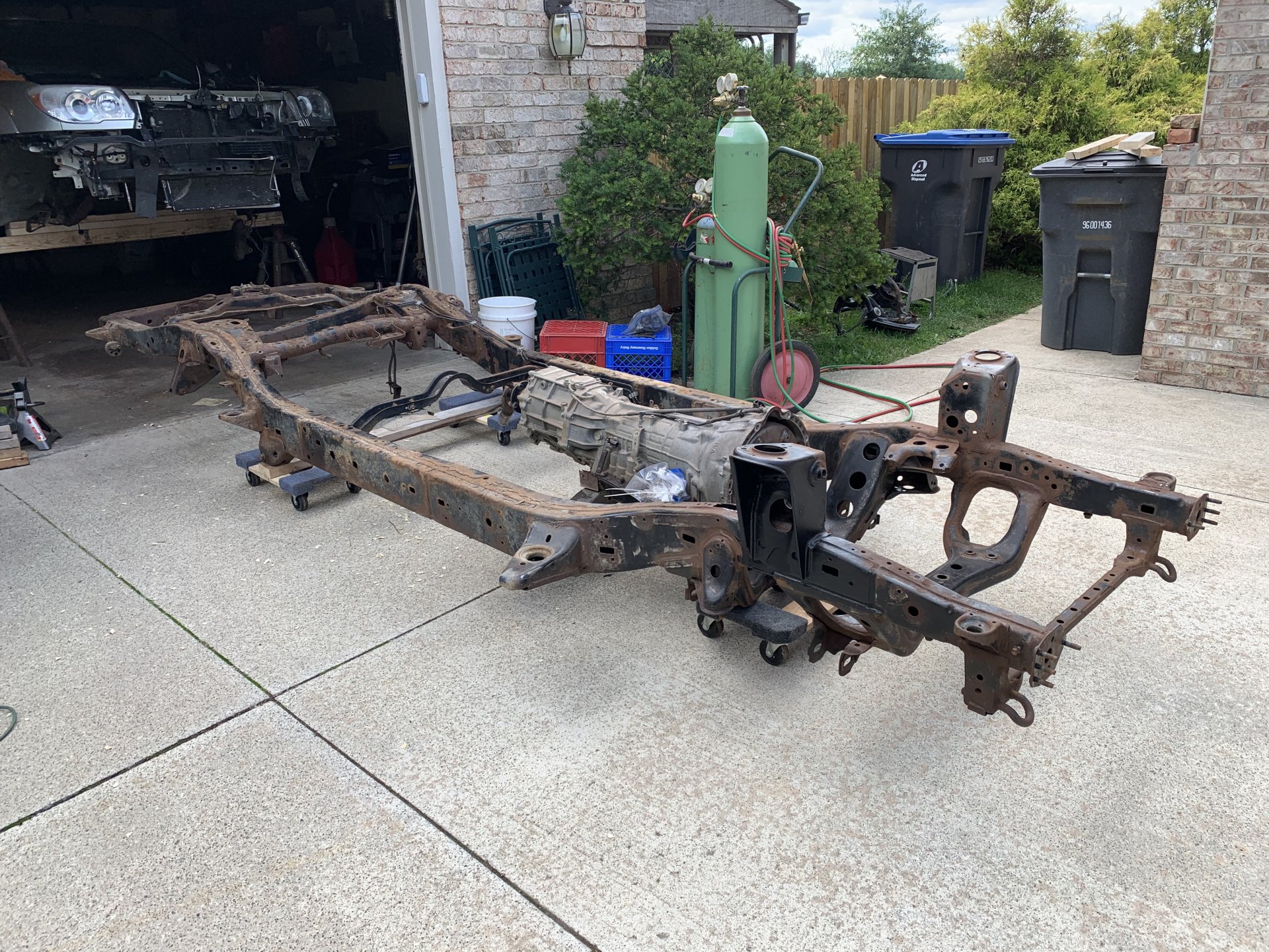

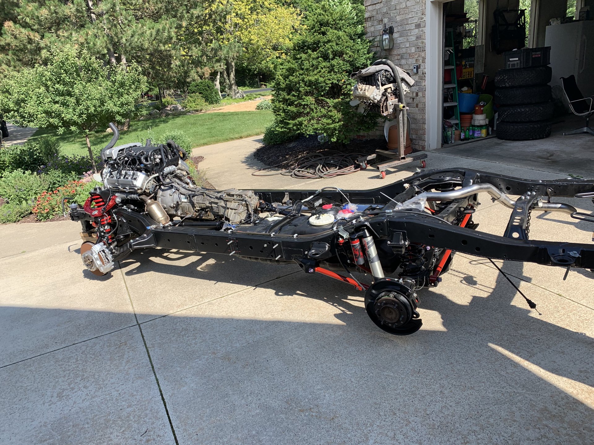

Nice one if you can do it!Just remove the body, cut out the cancer and weld in some patches. Can all be done at home.

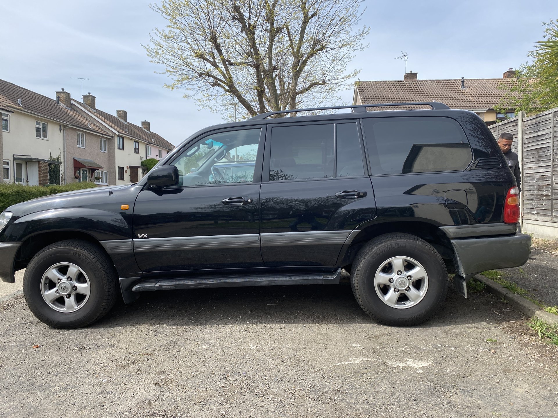

I will change the rear springsThe AHC Works perfectly but I don’t use it much. I am surprised about your comment on the springs tho. Here is a side profile of the car. Still I will book the car with local 4x4 specialist to have a look at the springs.

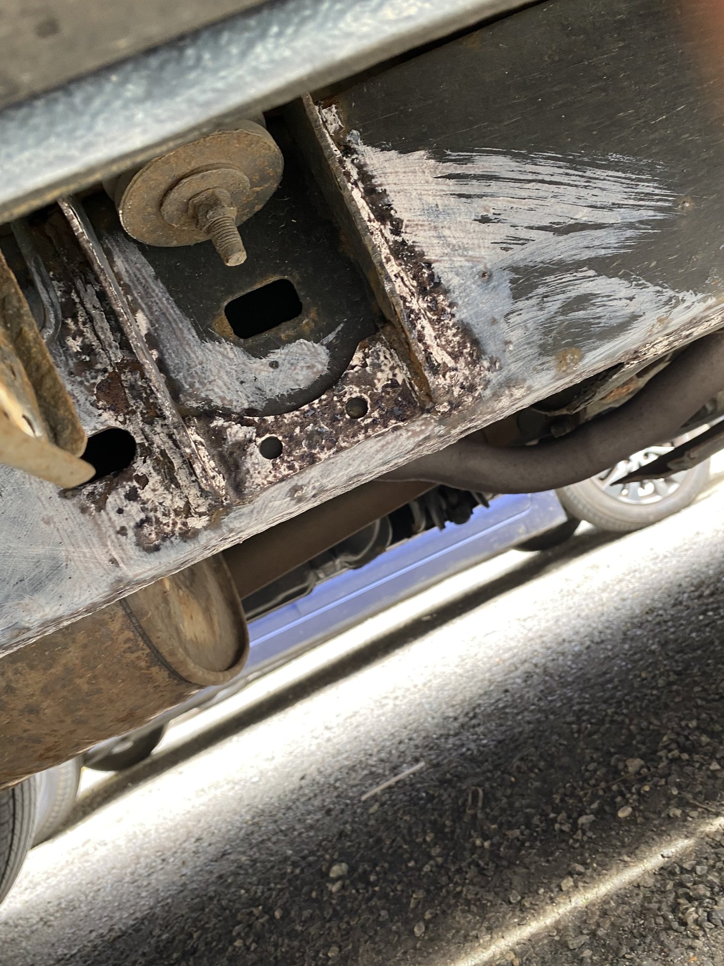

Weather was not humid. It was not too warm. About 16c. I thought it should have gone black. It still had white bits when I checked 4hours later. I am confusedthe rust converters I have used go on white, then turn black when dry. If wetted later on, they may turn partially white again. Was it very humid when you put that on?
Then again, maybe your kind is different.
You want to clean up the loose rust before applying (wirebrush, needle scaler etc) but not clean all the surface rust off, it needs some to react.
