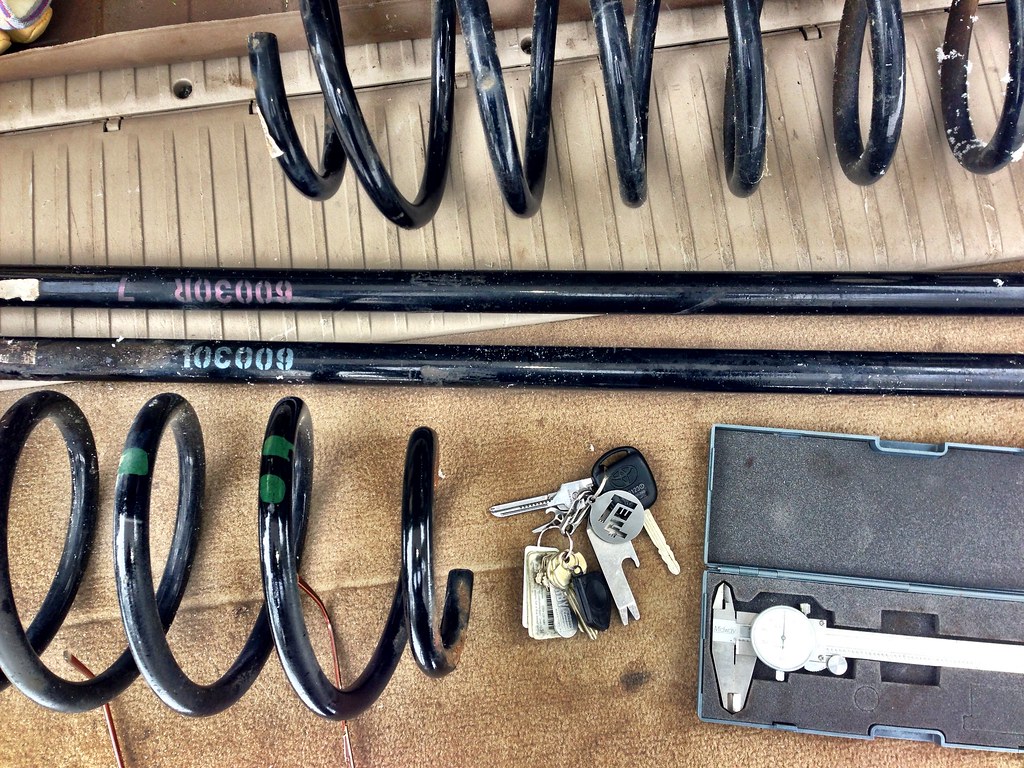

yoop has a thing for canuck merlot so i'll take him up on his offer as i know how to pay him back. i will get a diameter measurement on the stock tbars and compare. i've read conflicting stuff about whether lx tbars are thinner or not.

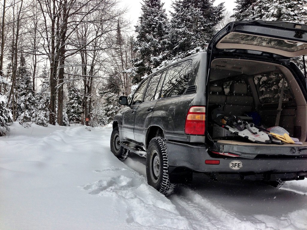

My morning adventure. 6" of fresh on top of unkown depth and consistency weird old snow on the road into our cabin, decided not to try driving in since I was alone. Snowshoes instead. (I've been stuck on this road twice before.)

My factory torsion bars are 28.7mm, compared to the 25.5mm ones on semlin's LX:
and the exciting conclusion:
