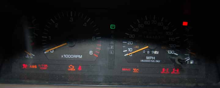

Heres my lights I get before start up with the driver's door open and the E-brake up...

Ok, see that is strange...
I know for sure I have the Low Oil light, because I had that come on like a week ago when I was a little low after a long drive through the mountains. I topped her off and the light was gone.
I don't remember ever seeing the airbag light, so I guess I'm going to have to pull the guages and replace some bulbs and report back.
