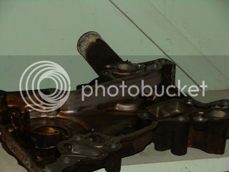

I was just going to say, sounds like your chain guides broke and chain is eating your water pump housing, which is exactly what happened to my engine :(

I drove it for 3 months after I got it, the sound got progressively worse.. the PO had driven it for a couple months before that I think with them breaking down.
If you could get a look at your timing chain cover, this is what mine looks like after I've done a little repair:
Either way with the guides being bad I'd think of it as a ticking time bomb
