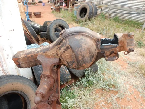

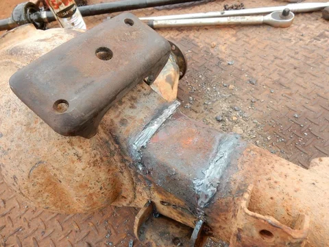

i had a donor HZJ75 front housing from a very rusty ex miner. one spring perch was totally disintergrated. cut perch from bent housing but all in all im losing faith in this rusty donor housing. once i hacked the old perch off discovered it is also rusted very thin under the spring perch.

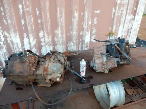

here a pic of the mess im in at the moment with both assemblies in bits!

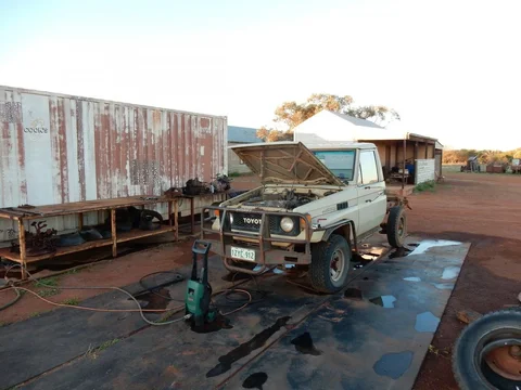

took her for first drive over to neighbours last night for beers 60mile round trip; went well.
cobbled this together with hj75 housing, centre, axles/cv'c and hzj75 diff flange. made the outer axles up out of the best bits I had to hand; this all pretty much interchangeable. I used hzj callipers and backing plates. new swivel kit, wheel bearings, rotors, flange seal and calliper overhall. scrounged up springs, shockies and enough bushes out of my junk. also swapped out the sump because it was a bit 'difigured' and very accessable. this old girl still needs love but first signs are good. the steering wheel is buckled from the impact; ive yanked it around ab bit still distracting to drive with; I keep turning the wipers on with my knuckles when I turn left! plan to drive and clean for a bit to get a feel for her. next on the agenda will be rear axle love, transmission oil change and straighten out a few 'quirks' to the cab. and fix some taillights. then maybe uni joints and new brake flex lines. reckon shes gonna be a nice ute.

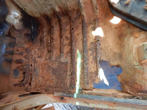

hj75 is a 1989 in my fav 70 colour. we bought it in the mid 90s and was pride of the fleet for many years. the floors rust out in all my 70s; lots of red dirt and mulga leaf get in under the floormat and holds moisture. the old bare floor 45s don't rust anywhere near as bad here.
