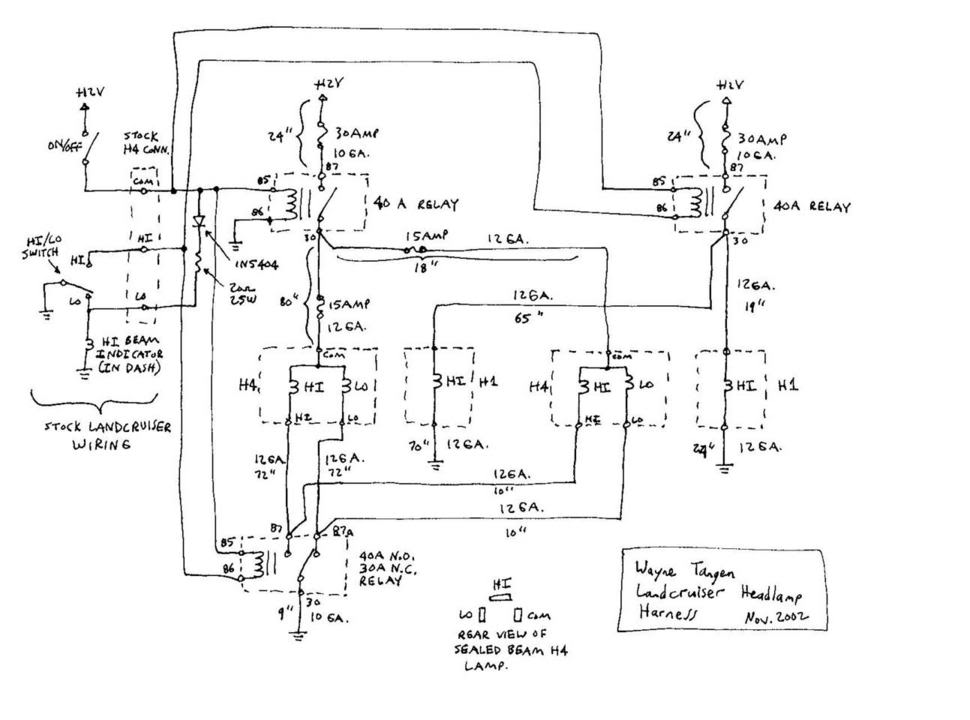

I found Wayne Tangen's wiring diagram for the FJ62 on the 3FE list and made the same harness for my HJ61 using 24V relays. Tyco part number V4FA-45H11. I am going to try the 20 ohm resistor to see if it works.
So that I can finnaly install these from Daniel Stern lighting. Cibie lows and bosch highs with performance bulbs as recommended by Mr Stern.
As I have found out the 61s have this weird neg switching like the 62s and most NA lenses ground through the housing. So you either wrap them in electrical tape or you blow fuses. The harness solves this problem. It also upgrades the poor toyota wiring.
