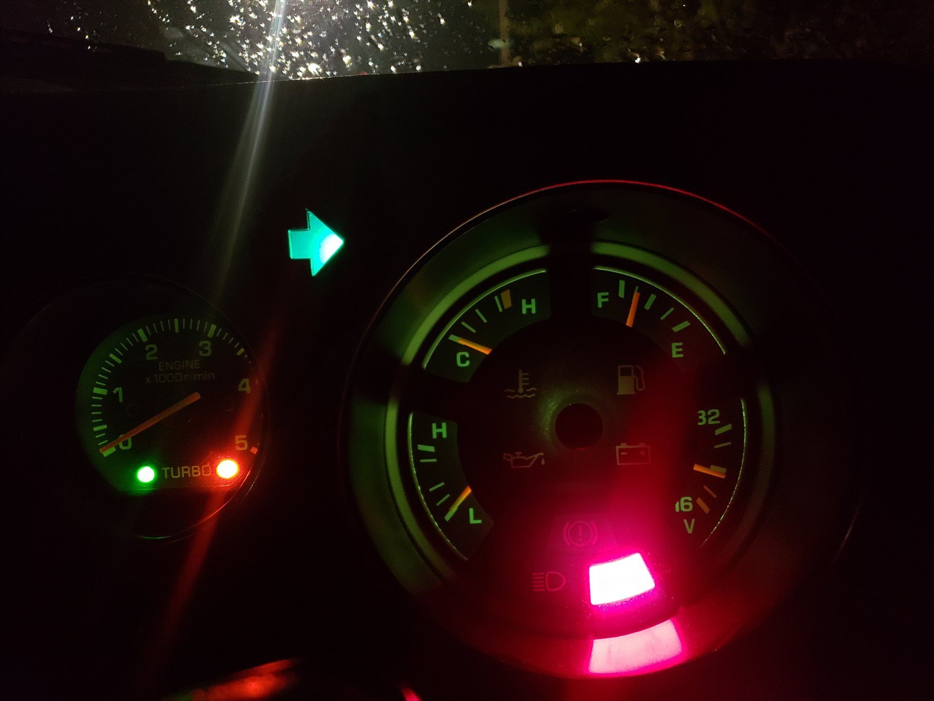

HJ61 died while driving.
Oct 26, 2019
4
12
Dalton, Georgia
Any ideas on what I should be looking for? I got out after it died, its been running fine these past few days, but when I touched one of the ground terminals it was pretty hot. Other than that nothing else looks to be out of the ordinary.
No action when key is turned, but hazards work? Fusible link on positive battery post may have a bad wire. Mine would randomly shut off too.
check the connection on the butterfly valve actuator. when my 12HT gets hot, or I have sudden power draw (turn on a lot of lights at once), it will lose power to the butterfly valve and it will turn off the engine.
