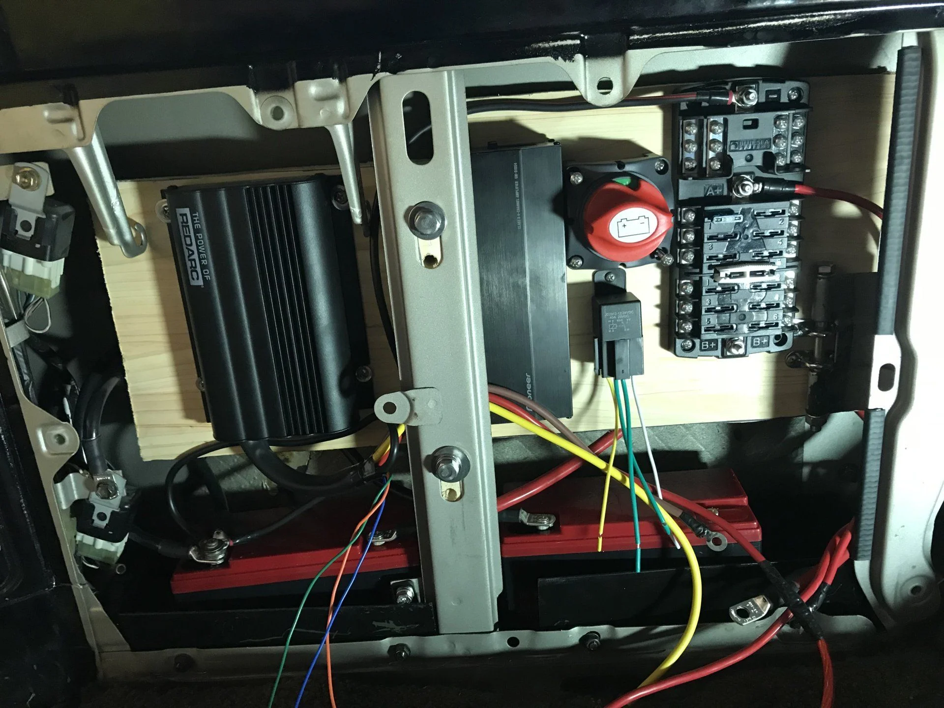

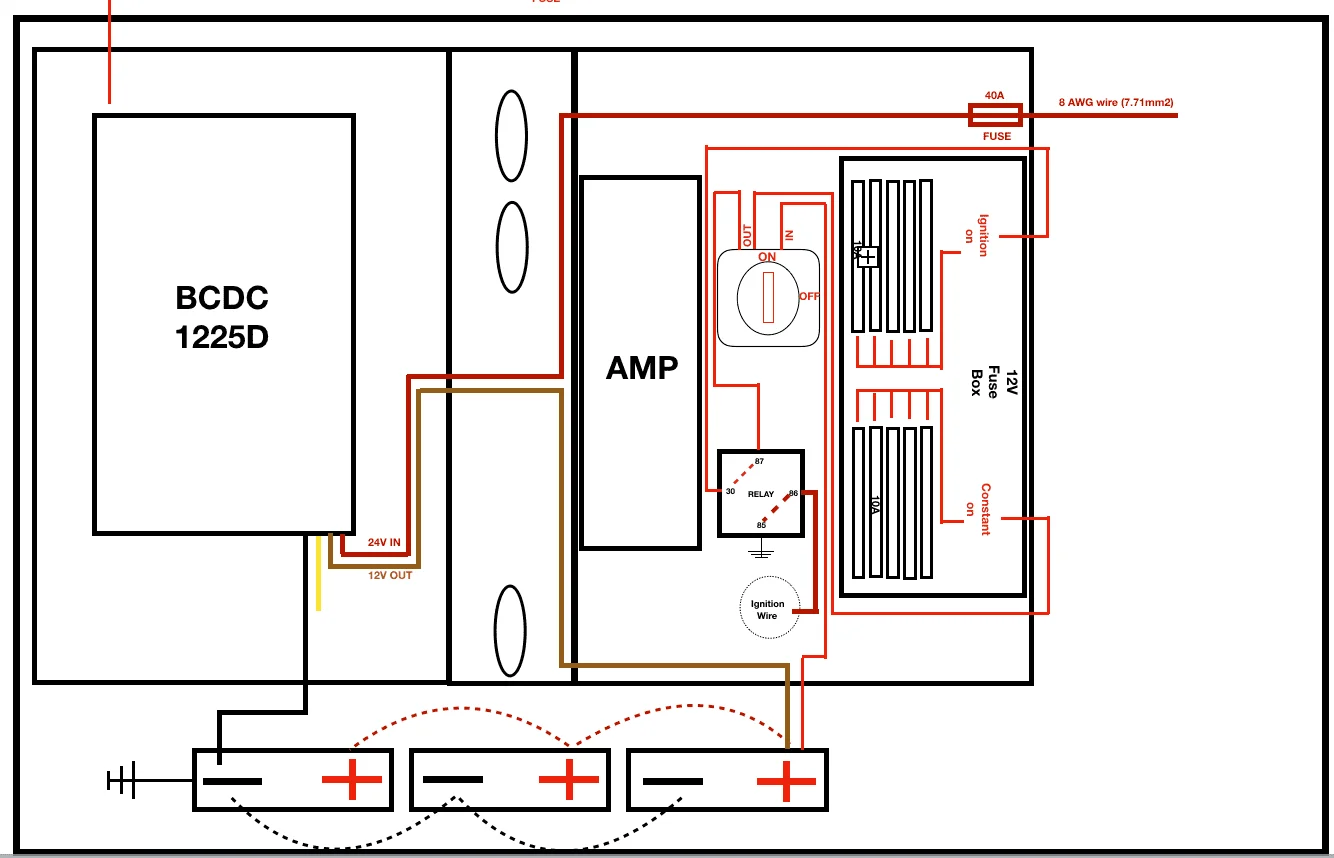

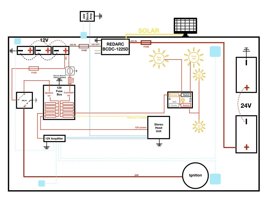

I recently installed a REDARC BCDC-1225D with a small battery bank into the rear left interior panel. Here is the wiring diagram and some photos. What do ya guys think? Anyone see any issues?

Im not far off a similar installation. Was thinking about putting the redarc in front of the radiator to keep it cool and the battery under the bonnet on a custom shelf.
It looks like s good installation and cant fault the drawing downstream from the redarc. Does the cable from the front of the truck lose anything due to its length?

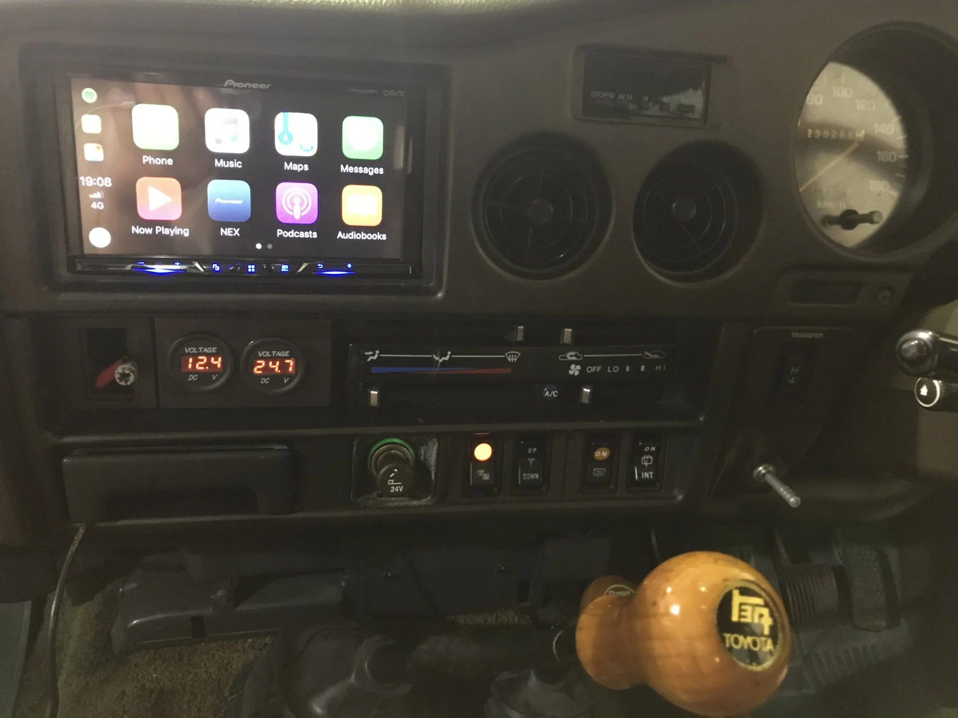

I really don't know if it loses anything, not sure how to test that. It was about a 5 meter piece of wire (8 awg) the way I ran it, so should be fine. I haven't noticed the REDARC producing much heat at all. I only have a small amp, head unit, and small LEDs hooked up to it, so it really isn't working hard to keep the 12V batteries charged. I ended up moving the amp under the dash, above the glove box. ( where the old stock DC converter went) I moved it from where the picture shows. pain to get in, but cleaned up nice
