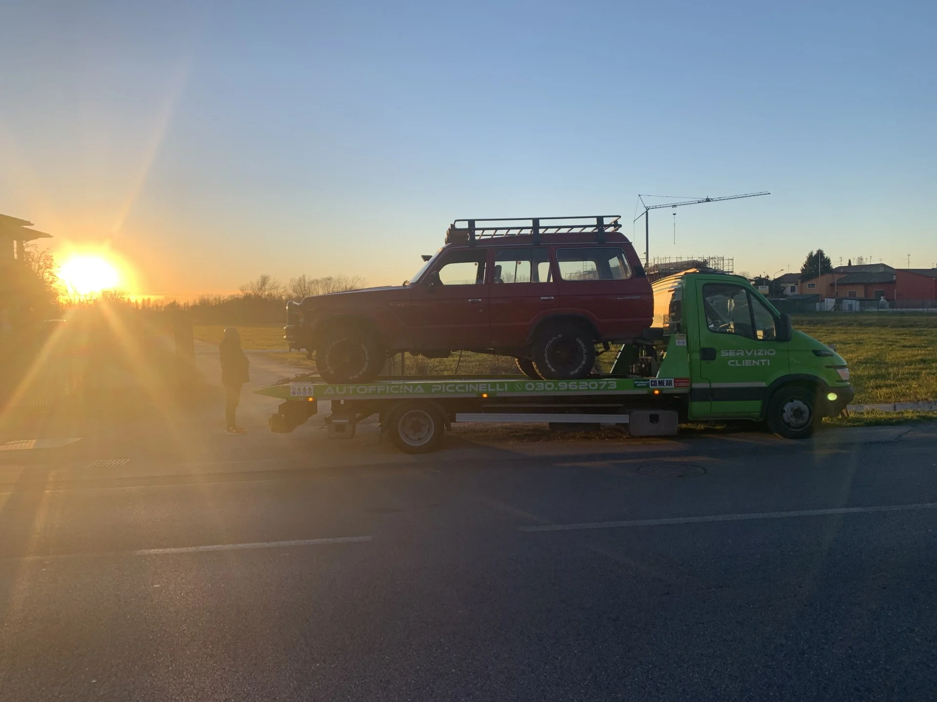

Update:
I failed today, kinda. I was able to remove the sedimenter and flush it successfully. The “in” line didn’t really free flow too much, so I’m guessing maybe I have something blocking the system further back? The motor idled well at about 650 rpm in the drive until warmed up. I took off down the road and made it maybe a half mile before the engine stalled and wouldn’t restart. My mechanic friend came down to help and neither of us found success. Ultimately the big red bastard wound up being towed so a professional can sort it tomorrow.
Never nice seeing it on the back of a truck..
Agreed. Hopefully my mechanic can get this fuel issue figured out. I’ve put a lot of time and work into this rig and just want to enjoy it for a bit. We are planning to take it from Italy to the UK in a few months when we move, hopefully all of the wrinkles are ironed out by then.
