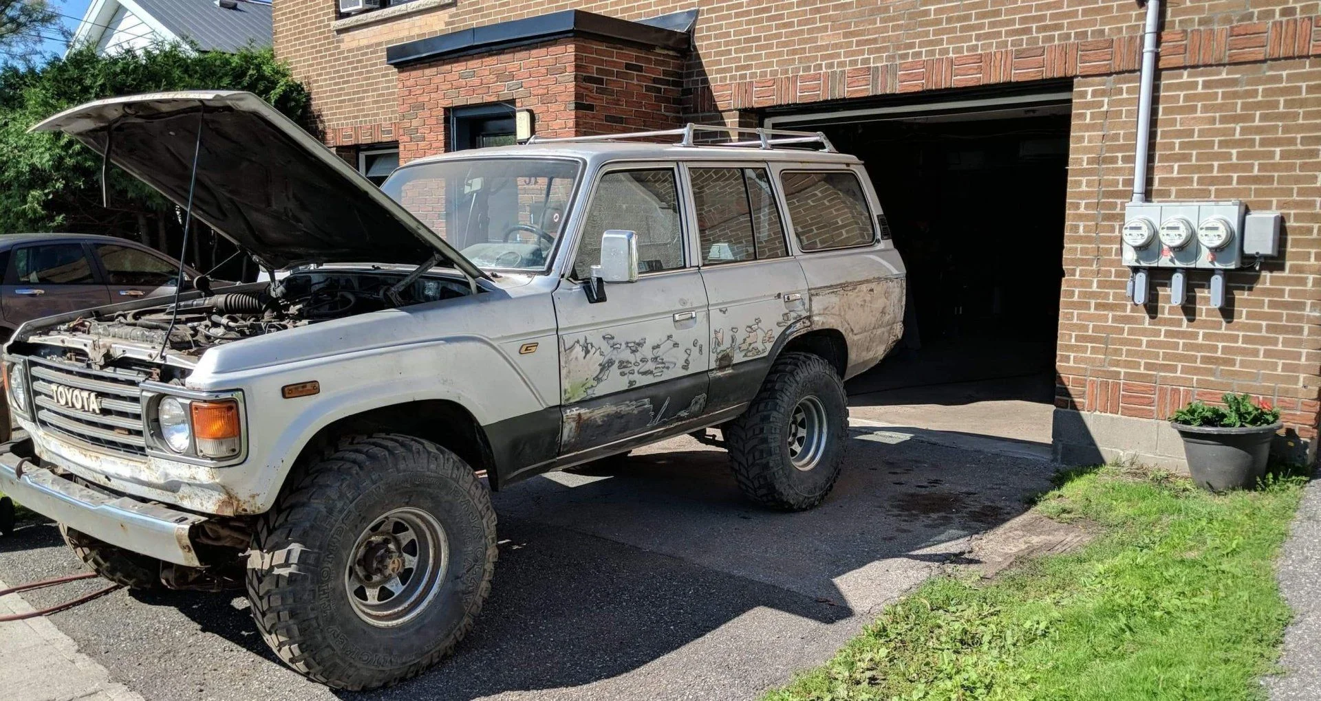

WOW, body looks pretty good back there for Canada. Keep the pic's coming.
Yes the floor is in perfect condition every where expect for the front section.
Rust proofing and spending the last years that it was on the road on Vancouver island helped alot to preserve it I think.

Interesting how your rockers are rotting. Mine are perfect but its rusting in other places yours isnt. Wonder why they rust in different places.

Quick heads up, your anti inversion spring shackles are “inverted” (upside down). The way they are sitting could put serious strain on the spring leaves under compression.
That's good to know thanks. Will definitely switch that this week.Its a ome suspension lift kit that the PO got installed before abandoning it in his driveway, pretty happy about that , wouldn't want to damage it.

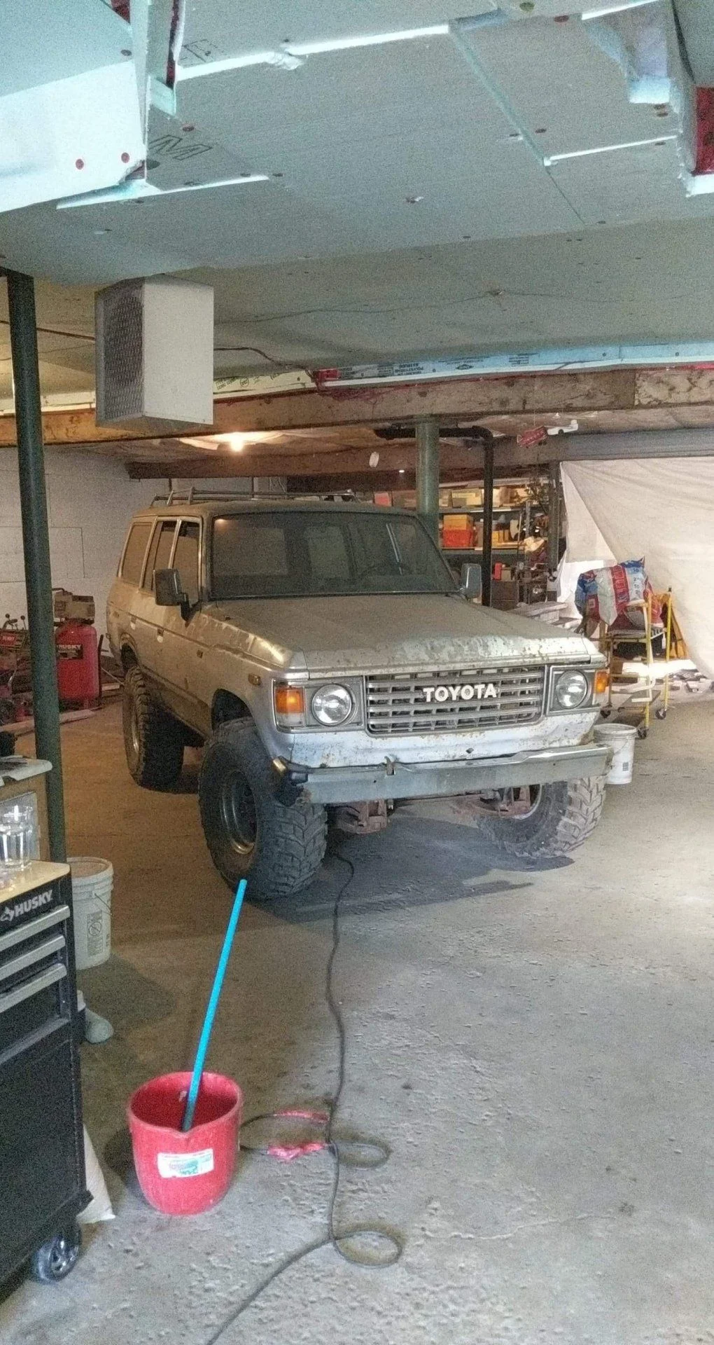

Did some good progress.
Getting ready to epoxy prime this thing then body work and final paint.
Installed some Mickey Thompson Baja claw 35x12.5x15.
Surprisingly , no rubbing so far , tried flexing it as much as I could around the house and no rubbing.
