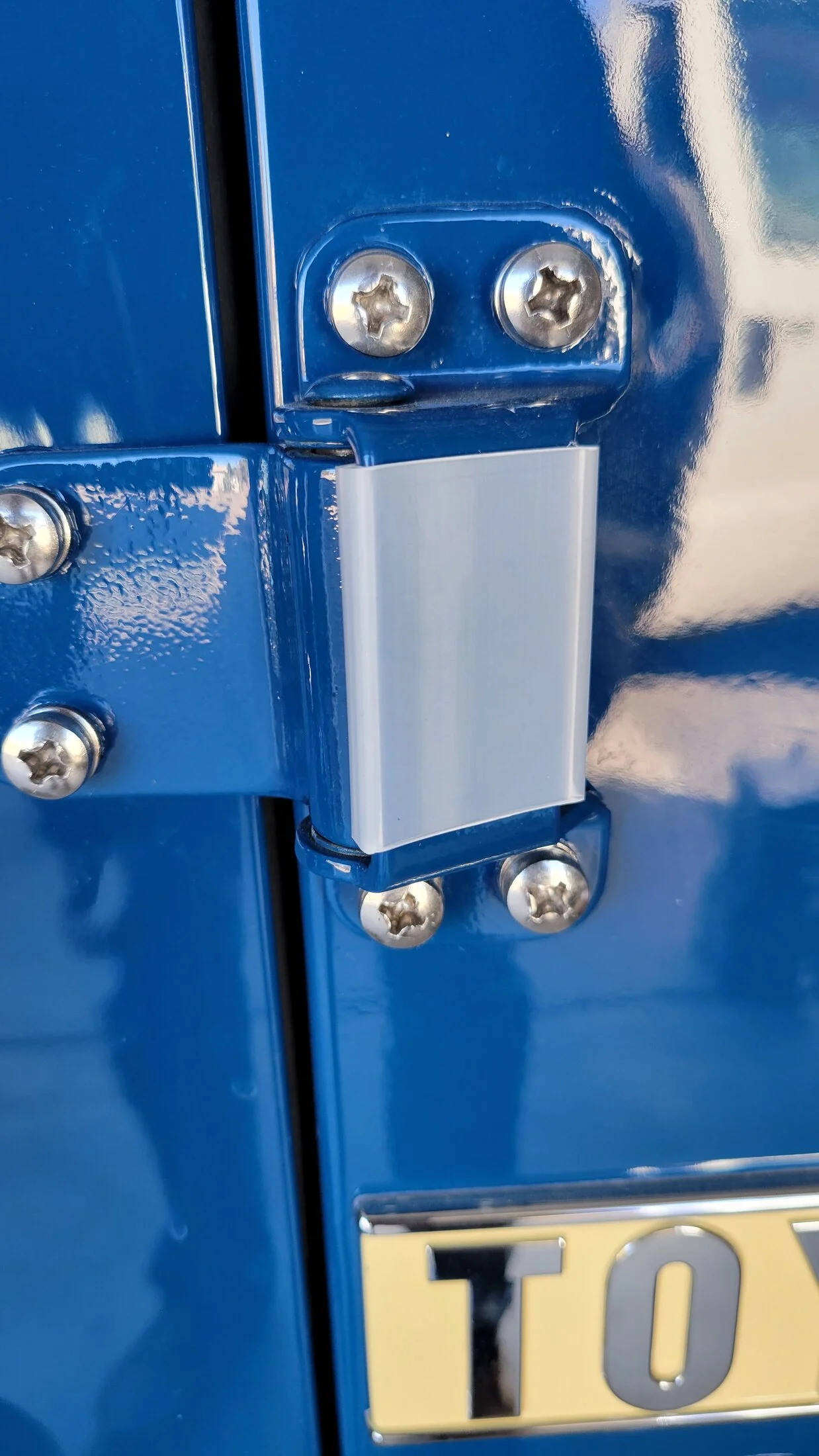

Would anyone know where I can get a hinge protector for the ambulance door of my FJ40? I hate the way when you open it all the way, it marrs paint.
I recently saw this on a picture from an online auction and had to save it and ask y'all here about it.
Thanks for any help.

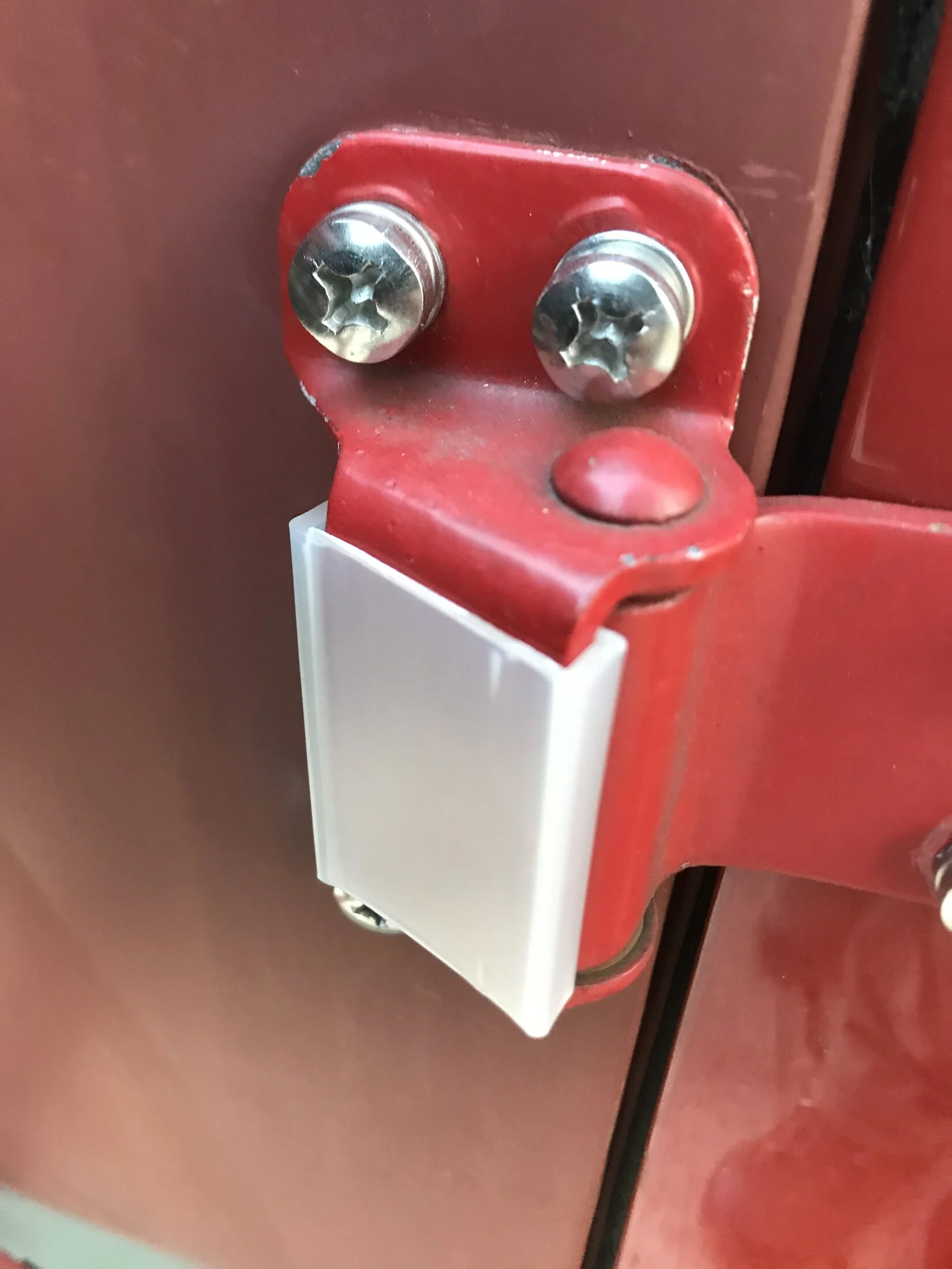

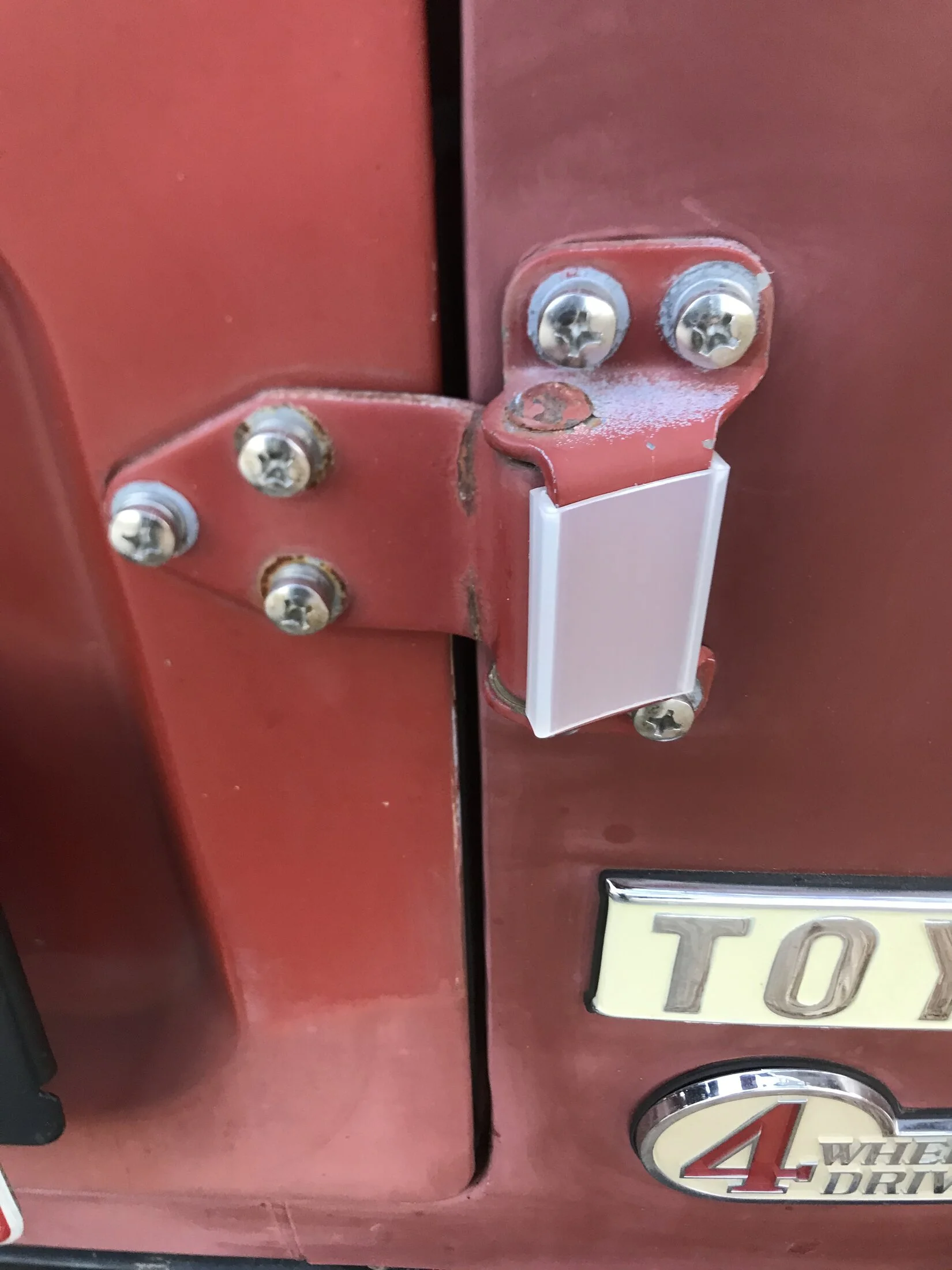

It's part 68959-90301 I got mine from frontier toyota for $5.40, your local dealer may be able to order it
I think some rubber edge protector trim would look nicer, but this is more secure and there was no question if it would fit.
I sure appreciate it! A clear one would be wonderful. I'll check it out!
Ordered 2 for less than $8. The shipping cost more than both 😀 Crazy how that works, but oh well. I sure appreciate the help! Can't believe those didn't come stock at some point. I've just thought it was something I had to put up with, and be careful with over the years. Am super stoked that this is a thing! Thanks all!
Toyota Parts Deals has this listed for only 78 and later models. Did the hinges change after 77?
I got the 2 I ordered and went to put them on, and they only fit my blue '83. Evidently the hinges are wider on the older models? The brown '78 I have is wider by half to 5/8". Who'da thunk?
