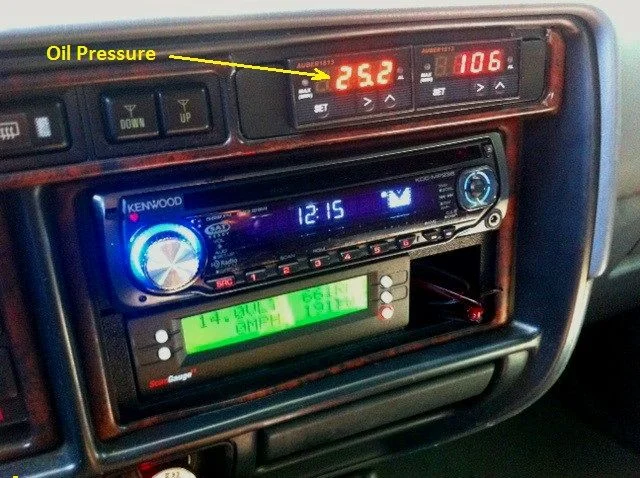

'Auber gauges'. I use them for oil pressure and trans temperature.
I retained my OEM sending unit so I would have the normal function of the dash gauge, but can also monitor the oil pressure 'real time' with the Auber Gauge.

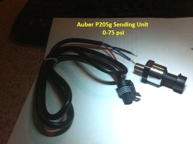

@flintknapper those just might fit the bill. Thanks! Can you point me in the right direction to find the output characteristics for the oil sender?
I used the Auber 205g with mine, but there are other sending units available as well (less expensive). If you plan to replace the OEM sending unit with one of these be aware...the threads on your vehicle are not standard tapered pipe thread and you will need to use a thread adapter. I relocated my OEM sending unit and added the Auber unit using an adapter so I could have both the dash gauge and the digital gauge.

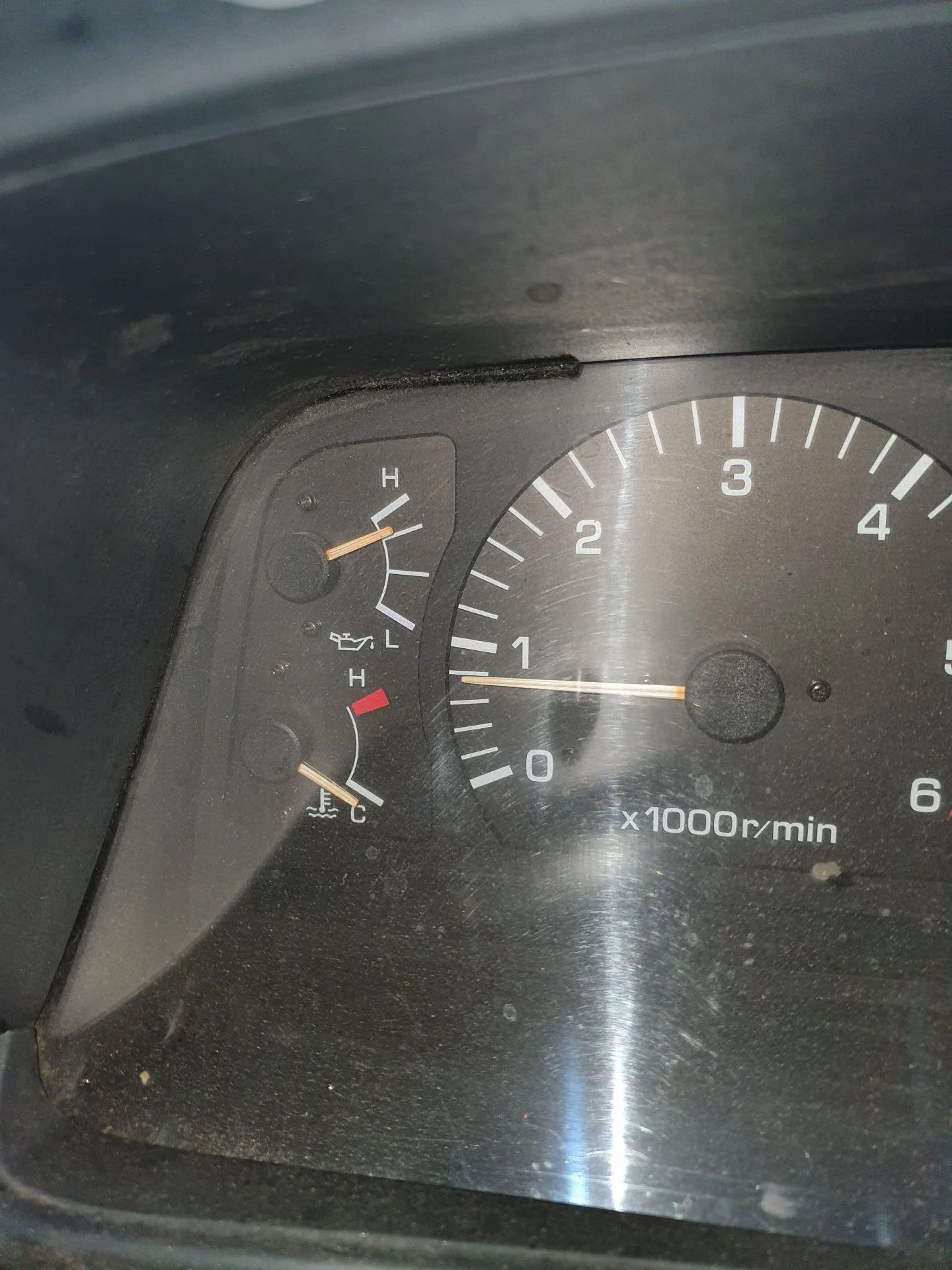

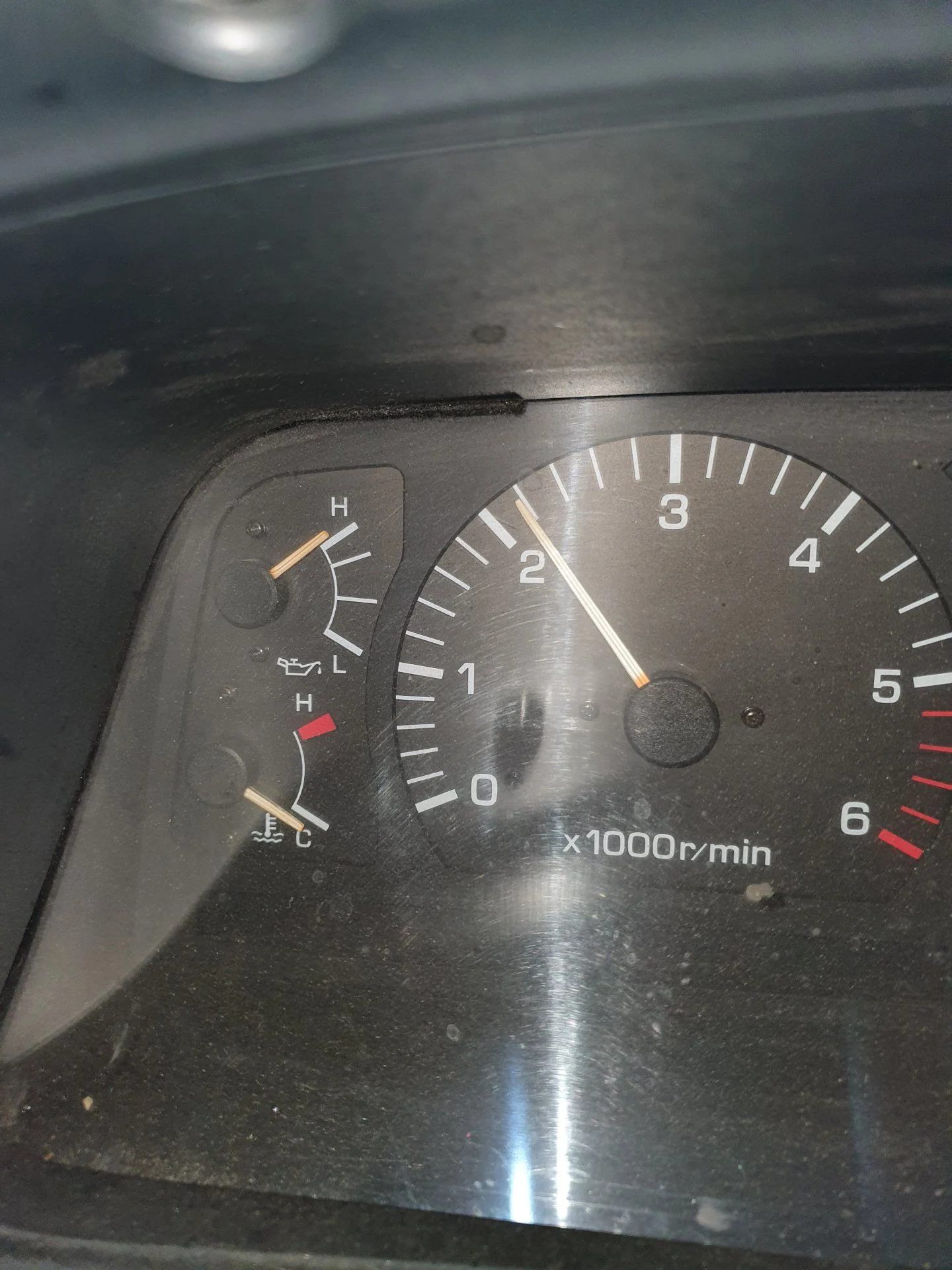

Hello, I noticed that the oil pressure gauge on my '96 was all the way at the top mark while driving and barely came down at idle. We installed a pressure gauge and it read 60psi at idle and close to 100 psi at 3000 rpm! We replaced the oil pressure relief valve and spring. That helped some but it is still varying between 15- 30 psi at idle and around 75-78 psi at 3000 rpm. The dash gauge is still at the top mark while driving. Could the oil pump housing bore be scored in the area where the relief valve sits (causing the relief valve to stick)? I have been told that replacing the oil pump requires pulling the head and half the engine apart to replace. Any ideas what to try next? Thanks.
Your initial reading (if accurate) was certainly cause for concern. Your present readings are not terribly out of line.
The pressures at idle (while a bit elevated) are not troublesome. The readings at 3K rpm are about 10-15 psi higher than mine but I would want to compare that reading against a second pressure gauge to confirm the accuracy before considering any actions to take.

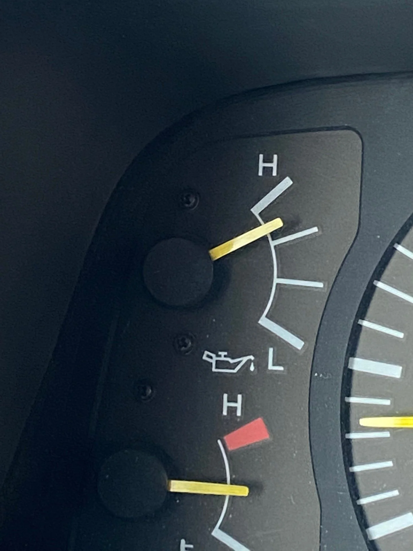

After driving for 20 minutes I noticed my gauge is reading quite a bit higher than previously.
Engine is purring like a kitten.
I've run the engine for about 45 minutes since gasket replacement. Just dumped the oil, and refilled with a fresh load of 10w30, and new filter.
I'll do this again as I had water contamination in the oil due to head gasket failure, and i needed to run it to shift it a few times.
Ordinarily, I would not be terribly concerned that it's reading high. More puzzle about the sudden change in reading, and slightly worried I may have a blockage due to contamination or sludge.
Engine is not up to temp for these pics, but readings were the same yesterday when it was at temp.
Should I be worried about a blockage from water contamination?
Dumped oil was a little dirty, but nothing that concerned me, and nothing solid in it.
I would think listening for any squeaking would be the only way to know there is any starvation at this point. I haven't done a headgasket on a 1fzfe but is it possible to put the gasket on upside down and block oil pathways?
No, that's not possible.
Then unless you are really clogged up with gunk, and you would have been able to see that while you were in there, I would expect things to be ok. might check the oil sender connection to make sure nothing is interfering with it and the wires to it giving a false reading.
I had the same situation (water in oil) and also changed the oil after my head-gasket job soon after running the engine for about 50 miles. Sure....it's possible that some SMALL obstruction has occurred someplace but unless you are seeing a really high reading at warm IDLE....I would not be too concerned about it.
IF you didn't go through your oil cooler when doing the HG job....you might run some SeaFoam in your oil (at recommended portions) and let it help clean/dissolve anything that might be causing elevated pressures (if indeed there are any).
Hooking up a mechanical gauge and checking the actual pressure would tell the real story.
