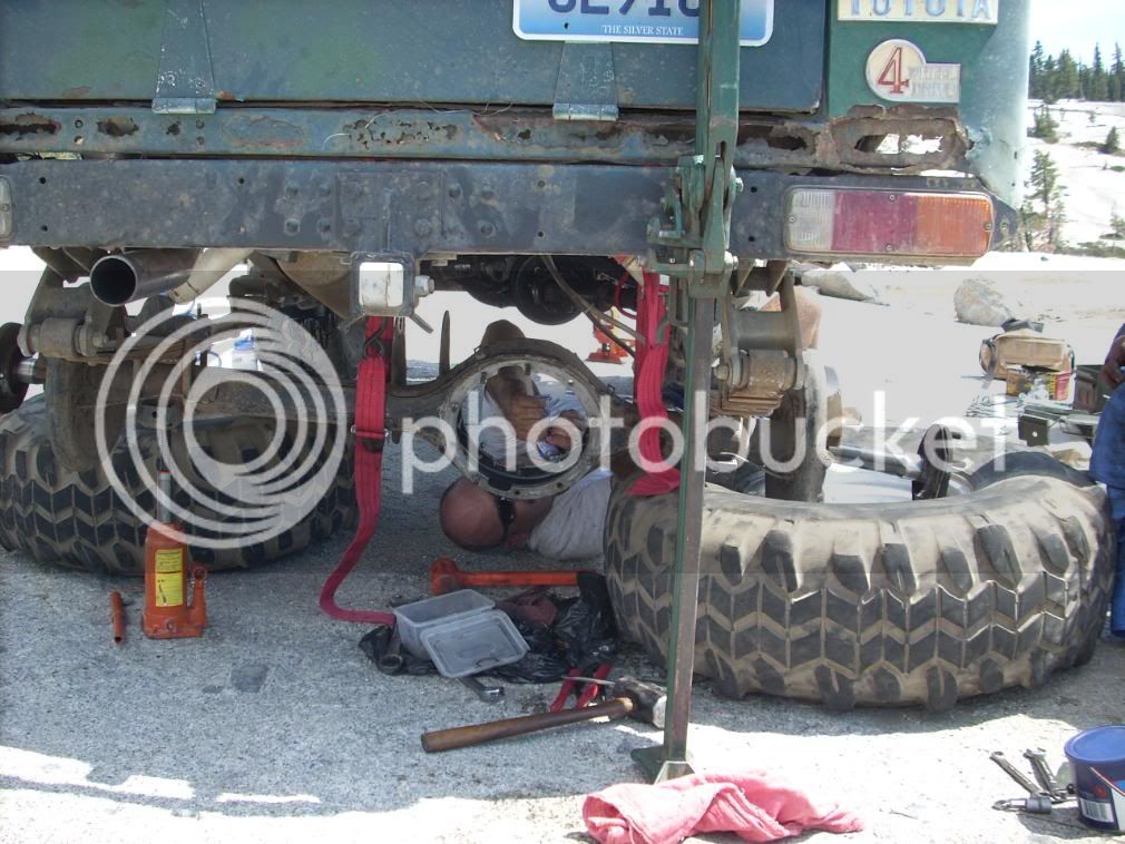

I disagree I use mine all the time to lift my truck, just not the 100. As you so rightly point out it's not the right tool for that job.
However it works very well for lifting more utilitarian body styles, BTW 48" is all I've ever needed with my lifted FJ40:meh:
Please note that the truck is not supported by the Handyman jack it is supported by the wheels under the brake drums. I would never get under my truck or allow anyone else to do so if it was only supported by any jack

Unless I'm missing something, this is exactly the wrong way to use a hi-lift. I see a bottle holding the axel up but no supports for the body frame. You should never get under a truck that is held up this way. I see the wheel that may stop things in a slip but I would not feel comfortable with it. It looks like you made the best of the situation but damn.....

Dear Everybody... Please use this picture of an example of what not to do.

I lean toward extra safe, but honestly that picture isn't very risky. He's completely shored up by the wheels/tire/axle on the PS, wheel/frame on the DS, and the front is on the ground.

The passenger side will be supported by the tire (after what looks like a few inches of drop) but the rear on the drivers side will hit the ground. Not accounting for tire compression or shifting about half of that rear axle, and all of the drivers rear spring pack is going to hit the ground at 9.8m/ss unless a body part is there to slow it down.
As a trail fix in an emergency when there are no other options we do what we have to do. As an example of how a Hi Lift is a good lifting device not exactly.
