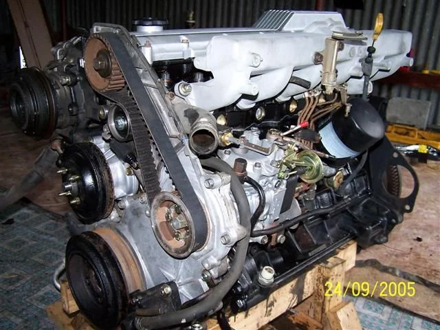

They are both about the same cubic capacity 3B= 3.9 litre and 2H= 4.O litre.
The 2H has slightly more power but the 3B is better suited to turboing.
The 3B with factory turbo is called a 13BT and the 2H with turbo os a 12HT.
The 1HZ is the current non turbo 4.2 lt 6 cyl diesel and performs like a good F motor with 23 mpg. It really sips fuel offroad at low RPM,maybe 1 and 1/2 gallons per hour in low range.

The 1HZ
