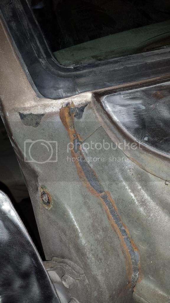

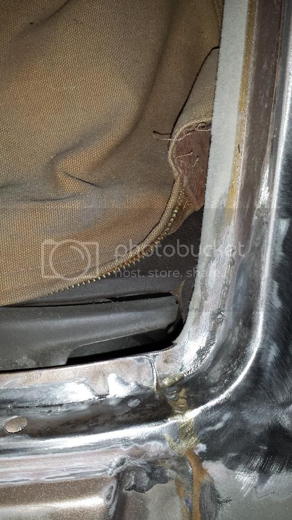

As it often goes with projects, one thing leads to another. Case in point, in a exterior search for rust, I noticed a small discoloration at the base of the A pillar just under the top of the fender.
I couldn't tell if it was anything to be concerned of, so I pulled off the fender.

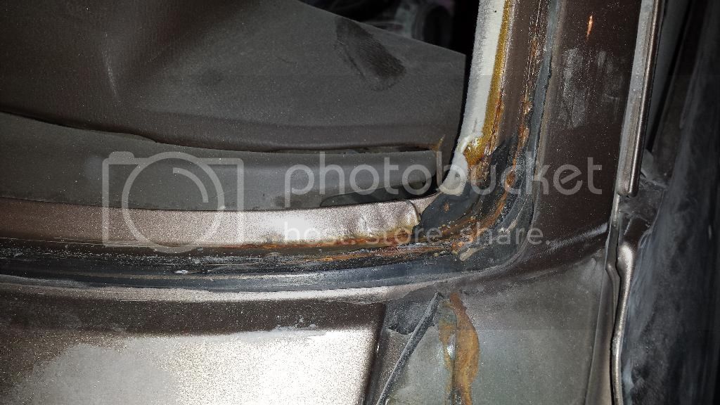

Turns out that the sealant was pretty much gone and it was starting to rust a bit. Seeing the rust creeping out of the weep hole at the base of the windshield got me nervous about lurking rust there, so I pulled the windshield too. Sure enough, a bit of surface rust there too.

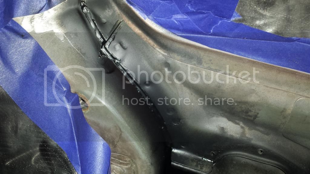

A touch with a wire wheel and it was gone. I sprayed ospho into the seam and let that dry for a few days to kill any lurking rust. For some added insurance, I flushed the weep hole system on both sides with some more Ospho, and then used some rust reformer/ encapsulation paint on the corner.
I cleaned off the old sealant and surrounding area with some brake cleaner, and then reapplied 3M auto seam sealer, then topped it off with the rust reformer/ encapsulation paint.
As some added insurance, I covered the entire area with some fluid film before reinstalling the fender. Should be good to go for another 25 years!

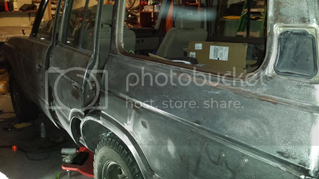

But...as I mentioned, one project leads to another. I figured since I had the seam sealant out, I'd re-seal the rain gutters, while I was hacking away at the rain gutters, I figured that I might as well remove the dealer installed rack and vinyl ridge bars. Since I now had jacked up roof paint and the exposed holes in the roof in need of being filled and, I figured I might as well strip the roof and repaint it. And of course...if I stripped the roof, I might as well strip the entire cruiser and repaint.
So...now I have a real project on my hands. :hhmm: All the glass is out, handles off, emblems off, etc. I have a customer that runs a local paint and body shop that is going to help me with the paint process when the time comes to spray.
Once my wife saw what I was doing, it took a few nights to find a comfortable position for sleeping on the couch, but I'm getting used to it now.

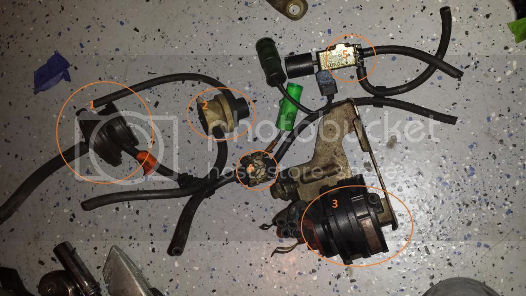

Of these 5 vacuum items that came off the driver's side fender area during my desmog, which do I need to retain for use post de-smog? ( I've looked through the de-smog thread, but can't find a good picture of the fender area.)

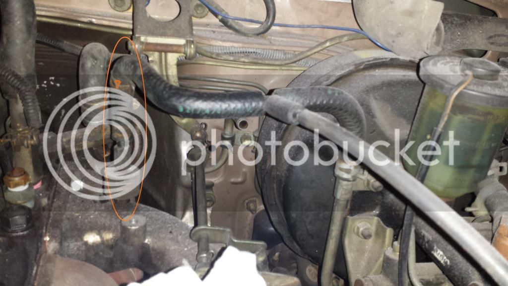

Secondly, is this where this hose goes? I took a few before pictures before dis-assembly in January, but can't find a shot of this hose that wasn't blocked by the carb.
Yes that's where the brake booster vacuum hose goes...I have no idea why there is a "T" on it, but yes, that's where it goes...to the accordion/bellows looking thing on the manifold.
As to the smog items...it sort of depends on what "level" of desmog" you're doing...one of the items pictured is the HAC - High Altitude Compensator...it adds 7º-8º of advance to the timing once you travel over 3900 ft. in elevation. Although, I have to say...I've forgotten more about my old HAC delete desmog (in that thread) than I remember.
On that "Cooler" circled in orange, there is a "T" off it for a vac line to the A/C Idle up solenoid on the drivers' fender. If the truck came without AC, then it's just a single port for the Vac Booster.
Can't tell from your earlier pix of you have A/C or not.

Interesting...I have an AC'd 87 and no "T" on my booster vacuum...can't speak for what was done to this rig before I owned it though...
IDK if you're talking about the same thing though...I'm talking about the "T" barb on the rubber hose, not the fitting on the manifold...

It does have A/C, so I guess that is where that hose goes, any idea which of these items is the A/C idle up solenoid?
Looks like # 5, but I can't really tell if that's it or one of the other VSVs.
You still have the stock Aisan carb? If you don't, you can't use the Idle-up function for the AC.
