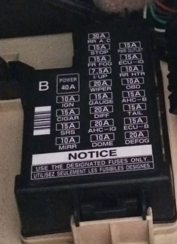

The fuse for the radio under the hood is good. But there is no power to the connection in the dash. I don't have a fuse cover for my drivers side kick panel, but I don't think there would be a second fuse there, but since I don't have a cover the research has been challenging. If someone could send me a pic of their fuse cover it would be appreciated.

The driver side kick panel does not have a fuse for the radio/stereo. It does have fuse for the cigar lighter, which for some reason or another according to the wiring diagram is connected to the amp which powers the stereo. See attached wiring diagram.
The cigar fuse is a 15 amp, 2nd one below the main 40 amp power fuse on the left side.

My amp is definitely the source of the problem. I am not getting power to the right leads at the head unit. Both the kick panel 15A cigar fuse and the 20A Radio fuse are good. I am guessing something in my amp got fried with the stuffing of change in the head. Next question......What do I do to replace the amp. Try to hunt out a working stock amp or get a new one?
