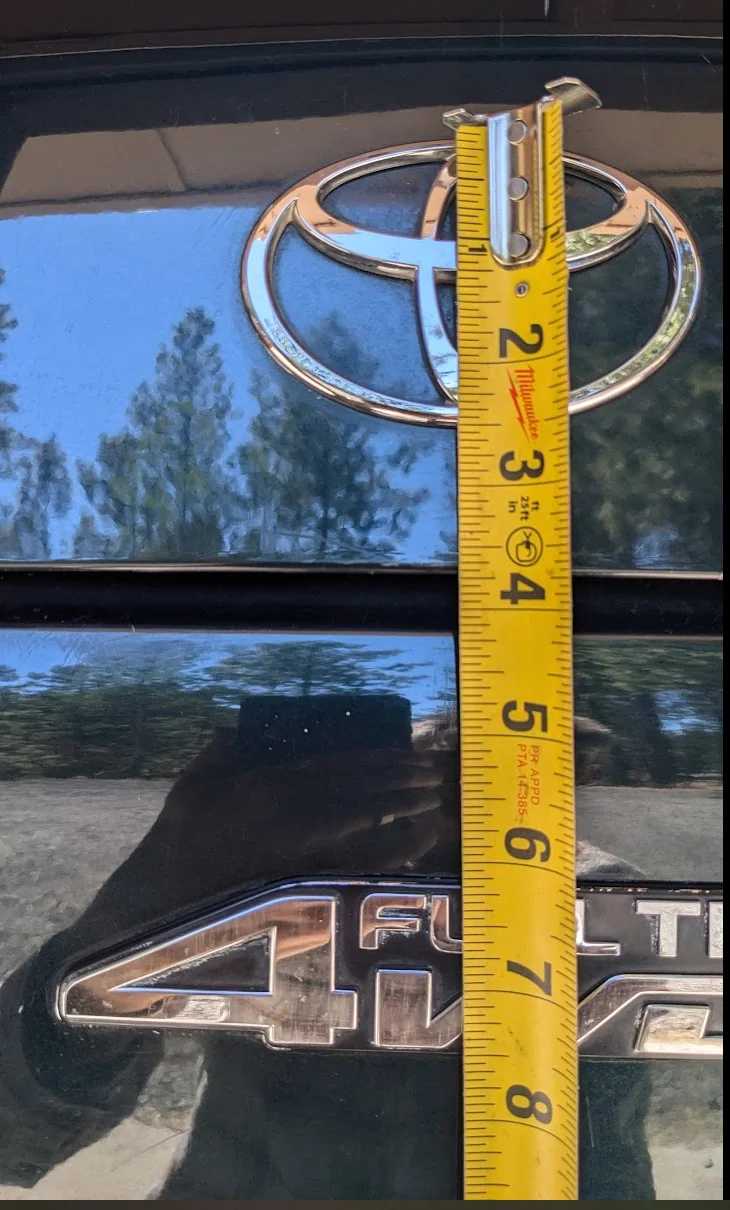

This is from my 94'

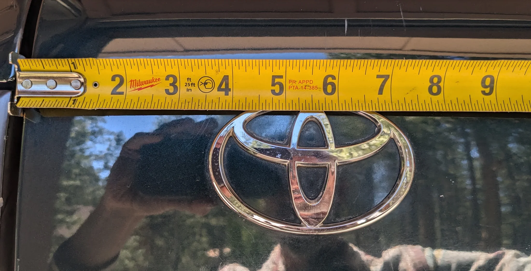

5 and 1/2" from the left edge of the hatch to the center of the sombrero
3 and 11/16" from the bottom of the hatch to the top of the sombrero
1 and 1/8" from the bottom of the hatch to the bottom of the sombrero

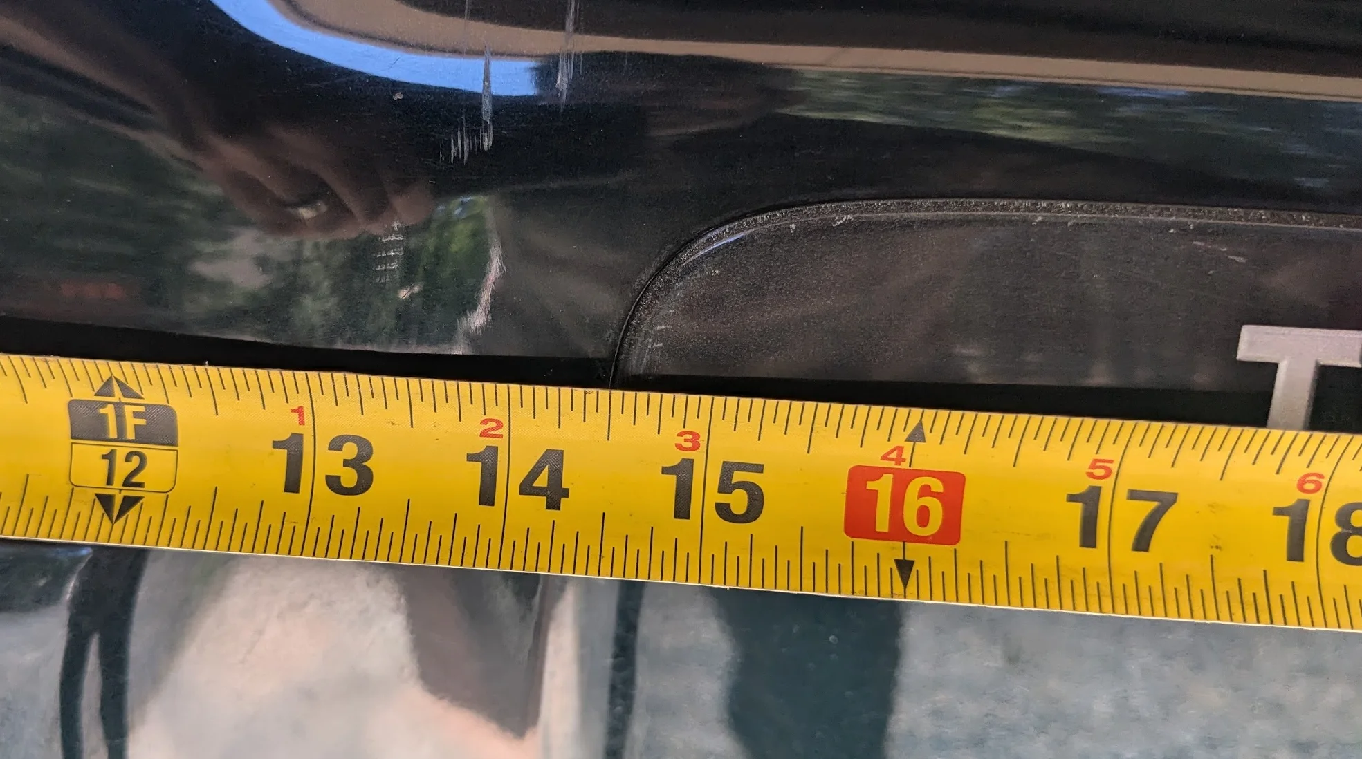

The land cruiser emblem is about centered between both sides (14.5" from the left of the hatch on mine, almost 14 and 5/8 from the right side)

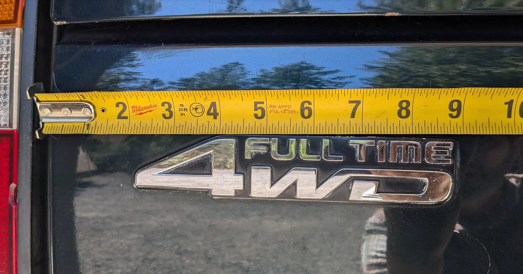

The right side of the 4wd logo is 8 and 7/8" from the left side of the tailgate
The bottom of the 4wd logo is 7 and 1/2 inches below the top of the sombrero

ZackR, you are a saint! Thank you so much.
Extra special thanks if you just stepped out and measured these just now!
Got me something fun to do this weekend.
