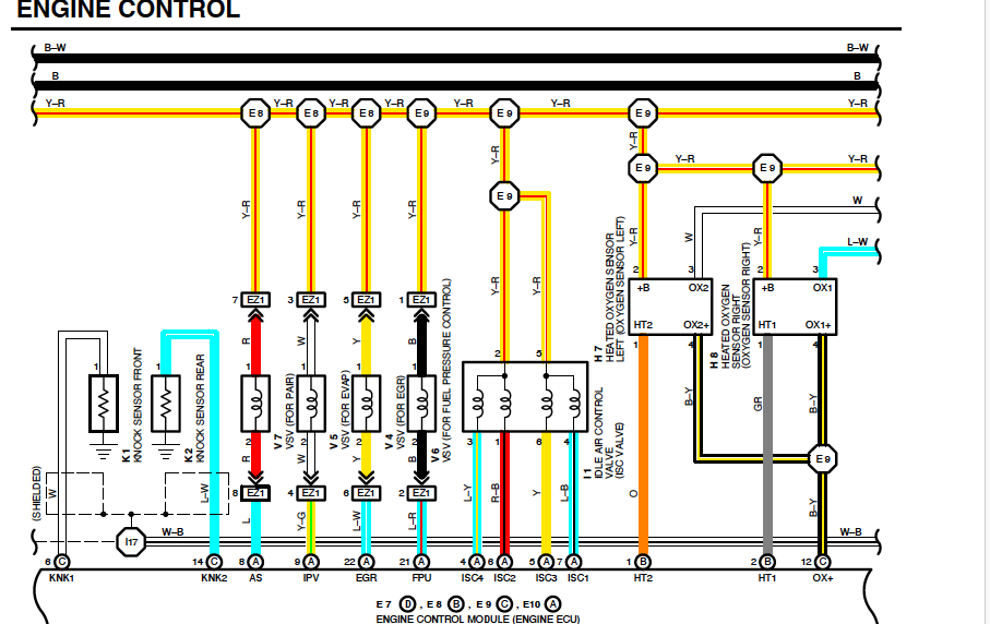

The EWD doesn't show the full sensor layout, at least no the one I have. It also doesn't have the layout of the wire colors for the NGK sensors of course,
Are you saying that the sensors you have don't have 4 pins? I'm not sure what the confusion is. The pinout is clear on the EWD.

The problem is with the right side sensor, and for whatever reason the wire colors on the truck side don't match what the diagram shows.
My wires are as following:
red/yellow, black/yellow, blue/white, grey
I also can't find a diagram that explain each wire color on the NTK sensor (heater, power, ground etc) so if anyone had that that would be a life saver.
