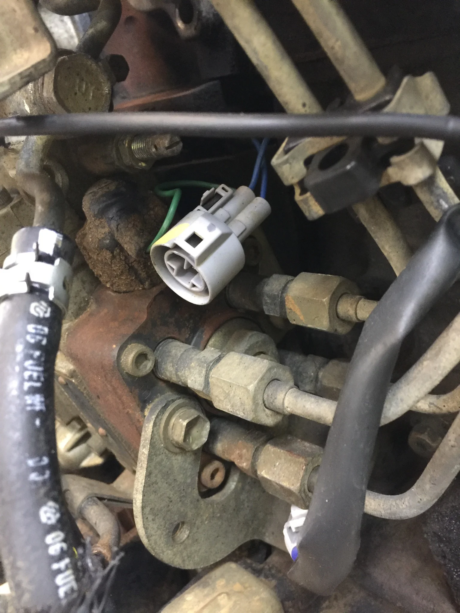

Hopefully nearing the end of my Hilux engine journey. 2LTE is out and a shiny newish 5L engine is here and ready to be swapped. My diesel mechanic is a great guy, but not much experience with these JDM engines. He's been a great sport and agreed to do the swap but is hoping for clarity on these issues:
★Injection pump connectors are different

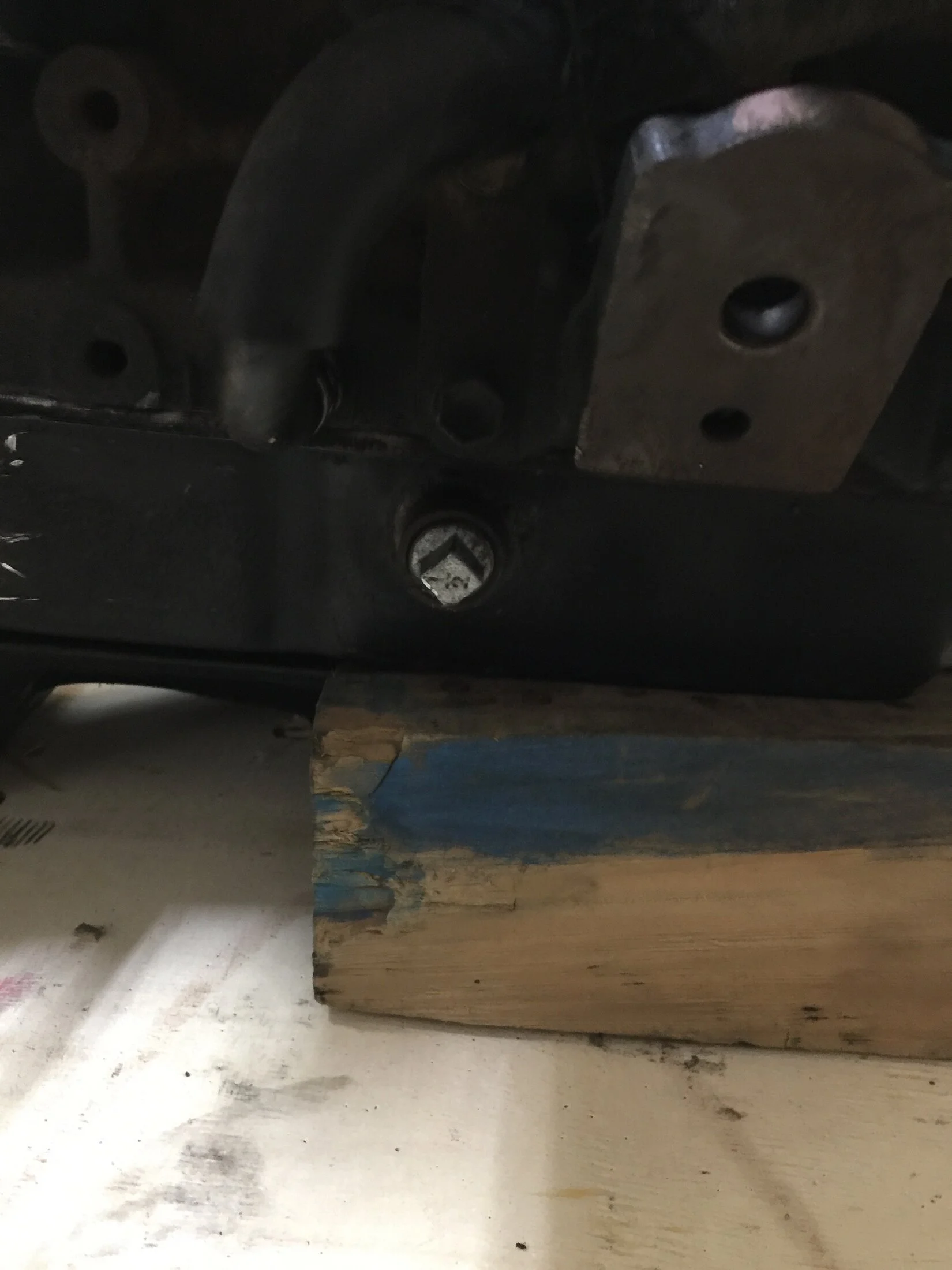

★There is a drain on side of oil pan on 5L

Grateful for any recommendations on how to explains solutions to these concerns to my mechanic and move forward and make the swap as easy as possible!
Pump plug and pan
The terminal in the grey plug on the 5L IP with a green wire running to the rear solenoid on the pump gets a constant 12V when the starter switch is on 'IGN' and 'START'. The two blue wires are for the tachometer pickup.
That's obviously not a drain, how would oil drain out when the plug is above the oil level?
Just leave the plug in there.

I appreciate your non-nonsense reply! Very helpful for my overthinking mechanic. Any thoughts on how to connect the tach over from an engine that doesn't use an ECU?
That I don't know, Does the old pump have a similar tacho pickup? I'm afraid I have no knowledge of the implications of running a mechanically injected engine in an EFI/ECU vehicle with an auto transmission. Hopefully someone else can chime in.
2 blue wire from pump is the tacho pickup. ur ori tacho will work but wont be showing accurate rpms as the ohms are different.
