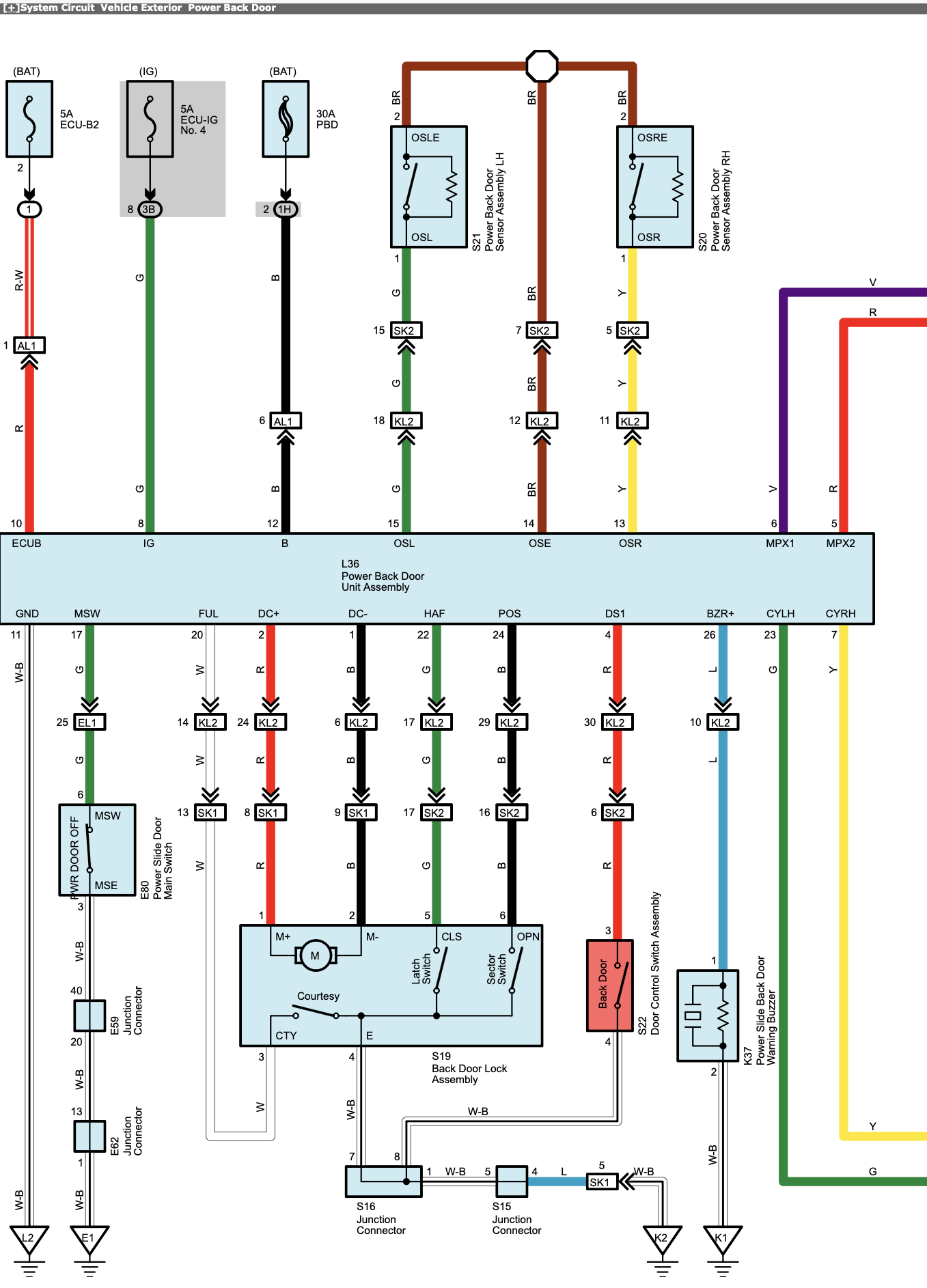

Different systems, I think. This is the diagram for your switch, and it doesn't have anything to do with the puddle lights and such. It's only wired to the back door lift unit. You don't have the power lift gate disabled do you?

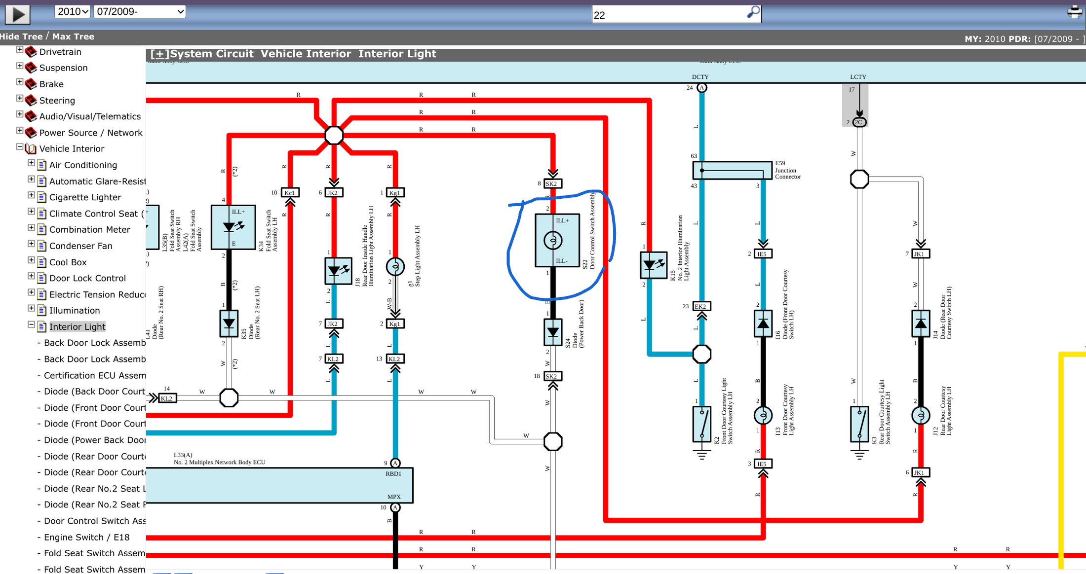

Hey @bloc, I got thrown at first too. So that connector (S22) is actually on two diagrams, the one for the Power Back Door (which I think you listed), but also the Vehicle Interior->Interior Lighting one. The PBD appears to trace wires 3 and 4 of the connector which continue to function fine, but it's the Interior Lighting one that traces wires 1 and 2 that don't appear to be carrying voltage anymore. I could trace part of it and saw the wire harness connections for SK1 and SK2, but started getting lost in the diagram for what was flowing where/connected to what etc. Let me know if it makes any better sense to you.
