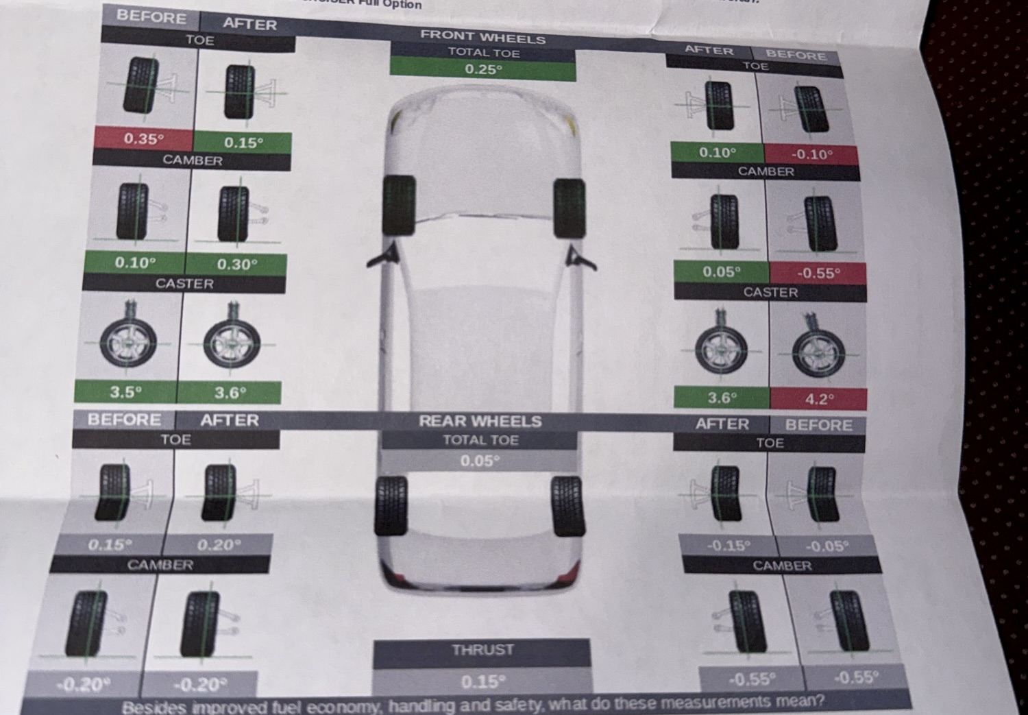

Symptoms started years after mods above: Steering wheel wobbles or shakes (and some times it's like steering itself) and pulls right only when accelerating hard from stop or from slow speed. This is not happening at highways speeds even on hard acceleration. No weird noises. Everything looks good underneath.
Actions taken:
- Replaced Passenger Side CV joint (I thought this fixed it but I was wrong)
- Replaced UCAs
- Rebalanced/Rotated tires multiple times
- Replaced tires (last week) and rebalanced them
- Have aligned at least 6 times with Caster Ranging from 2.8 all the way to 4.2 - no change (see attached latest alignment)
- Shop hand tested front end for wobble to check joints and no symptoms
Video of wheel wobble/shake - the click you hear is my red bull sliding on the cup holder :)
Latest alignment
Thank you for any insights you may have!

Well, it turned out that a year ago I was on the right track, just the wrong side. The driver side CV was internally worn out. It was replaced with oem and now all is well…
So, in the future, note, wobble on acceleration only, CV is the culprit. The problem is, which side??
