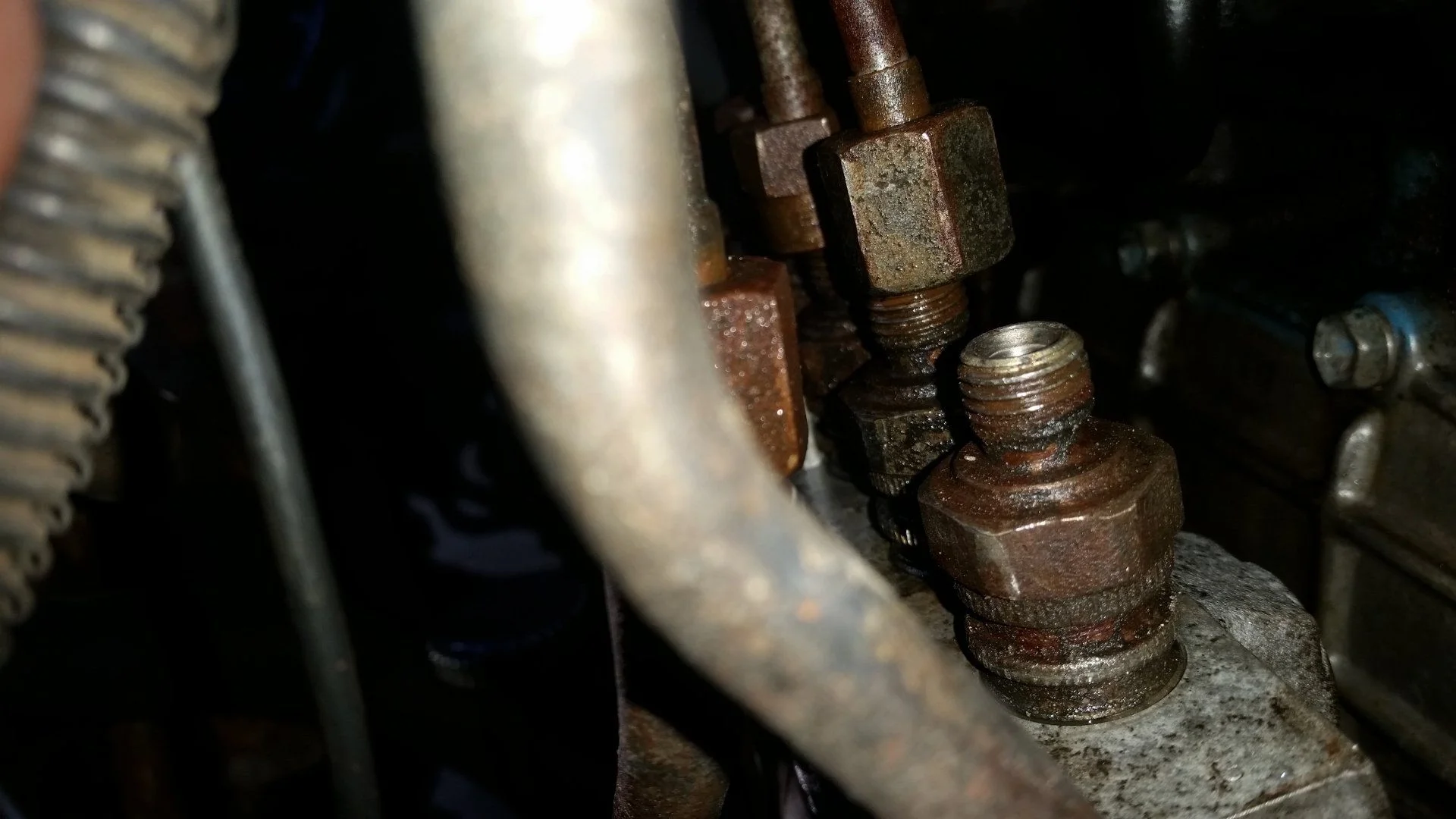

I just had a new(er) 2H put into my FJ60 and it runs great but is blowing black smoke on acceleration. All evidence points to the injectors/injector pump. I am trying to remove the injectors to be tested/rebuilt/replaced but they seem to be different from all diagrams and instructions. Any help would be appreciated.

did you post a picture of the injector pump or the injectors cause that looks like pump to me but I admit, i'm not getting off the couch to go check my engine.
It shows, but you are talking about removing injectors and it looks like you are wrenching at the injector pump which is not where the injectors are.
That picture is the injector pump
Injectors are on top of the motor
Also.. if you have black smoke on acceleration, I'd wind the fuel back a touch before I jumped to injector rebuilds.
