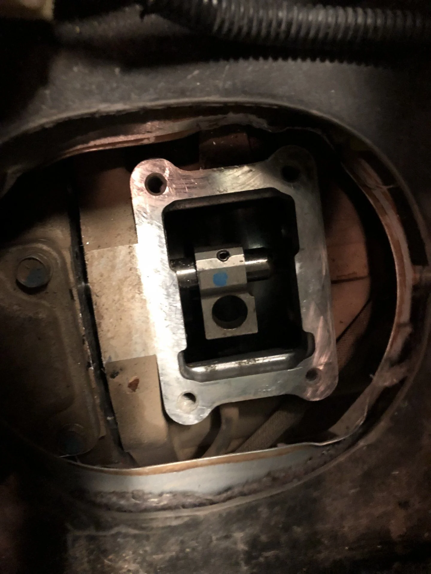

For the life of me I can not figure out how to pull the tcase off the tale end of the transmission. I have undone all the bolts. It comes off a little bit, but no joy.
I have undone the shifter per one write up I found , but that did not work.
In the picture you can see a little cyclinder like dowel that goes from the shifter to the tcase. This is what I believe is hanging it up. I cannot get it to disengage.
Hard to see but it looks like the shift dowel passes through the transfer case and goes all the way up into the rear of the transmission? Can you get under that roll pin with a magnet? I'd try punching that roll pin out (catch it with a magnet) and see if that doesn't solve it.
I linked the pdf to the overhaul, including removal. You have to remove that pin.
