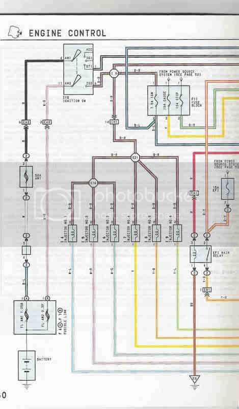

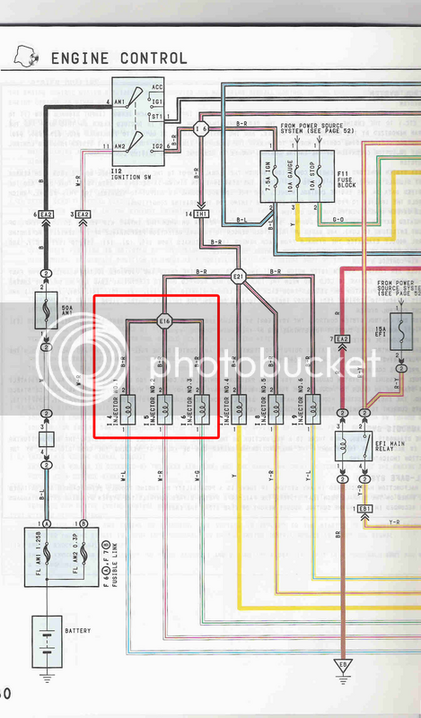

While I am sitting here going through the FSM then the electrical diagram I found something that was quite shocking (at least I think so).
There is a splice point that connects the hotwire to the injectors for 1,2, and 3. It is located really close to the EGR valve in the harness.
I circled it in red in the one of the right just to point it out, left a clean one if you care to print a clean one. The splice point is listed as E16 which is fed off of the splice point E21 which happens to run from the passenger side firewall around the back of the cyclinder head.
I am leaning towards the harness being the cause. I really hope this helps.
Thanks Proven!
I will print this out and give it to my mechanic tonight. I am towing it down there after work tonight. I wish I could habd him my FSM too. Gotta order one of those, wonder if CD is still in today?
