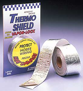

It is now awaiting me getting some heat shield. I am thinking header wrap and some heat proof Zip ties.

Good to hear that you've got it fixed. Dan nailed it in post #6.
You can get this stuff at Summit or Jegs or most any speed shop.

I took over some header wrap, nice thick asbestos stuff. I also took over a shiny starter shield that should give the exact same effect as the above stuff, but he can lay it on nice and thick. The starter shield came with come clamps to hold it down nicely.

It's done now and there is a very high probability that this is a long term fix if you got the right heat tape.
Asbestos wrap? ? ? ? I hope not. :frown:
-B-
Asbestos looking? Pretty standard header wrap. I'll post a pic of the finished product, should be nice and shiny.
