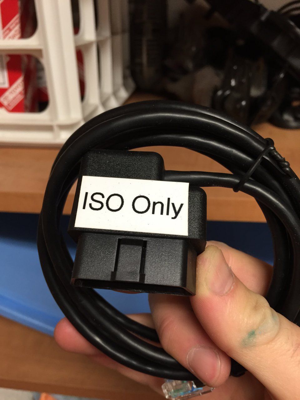

Forgot to mention earlier that when I called Scanguage about this issue, they were very aware of this scenario, and recommended that I use an "ISO only" cable instead of the cable that the SGII came with for my specific vehicle. The tech stated that that way there is no confusion between the SG and the OBDII port and the CPU, since our trucks use an ISO protocol. They sent it for free, I have not tried it yet.
Surfdc: so using something other than an "ISO" cable can mess things up, different pins sending different requests to the ECU?? Can you post up a side-by-side photo of an ISO connector and the connector you used when this happened?
View attachment 1000890 View attachment 1000891
Wrong!!! FZJ-80's use the J1850 variable pulse width (VPW) OBD-II standard, _not_ ISO. So for the OBD-II connector that's pins 2 (Bus positive SAE-J1850) and 5 (signal ground). The Scan Gauge II also uses pin 16 (+12v) for its power. I've built several custom cables for an FZJ-80 OBD-II port to connect a Scan Gauge using these 3 signals and they work right every time. ISO came later.
And, like George said above, while it's technically conceivable that a poorly designed OBD-II "reader" could cause abnormal operation of your vehicle, it is _highly_ unlikely. While there are a few OBD-II commands that can cause a running FZJ-80 engine to stall, these commands are not part of the normal PID parameter set (see http://en.wikipedia.org/wiki/OBD-II_PIDs) but rather vehicle specific "mode 30" commands. I have played around _a lot_ with the FZJ-80 OBD-II and have never found any command that I could send to the OBD-II interface to have a lasting effect on vehicle performance. The only (qualified) exception is that you can send commands that cause emission-related tests to be marked as "incomplete" that then may take several driving cycles before they are complete again (this is a normal part of the OBD-II standard).
Another point: there are no connections on an FZJ-80 OBD-II connector other than the J1850 interface pins. The connector that Surfdc shows in his pictures for his "iso only" connector are _not_ only for the ISO OBD-II standard.

TrickyT, You are right, and the tech on the phone was wrong, our trucks use J1850 VPW, not ISO. So that cable they sent me was a mistake, and in looking at it, has different pins than the female connector on the truck so I bet it would not even work.
Now that we know our truck are J1850 VPW, I'm going to assume you are asking if we use something other than a "J1850 VPW" cable can mess things up? i have no idea. :confused:
