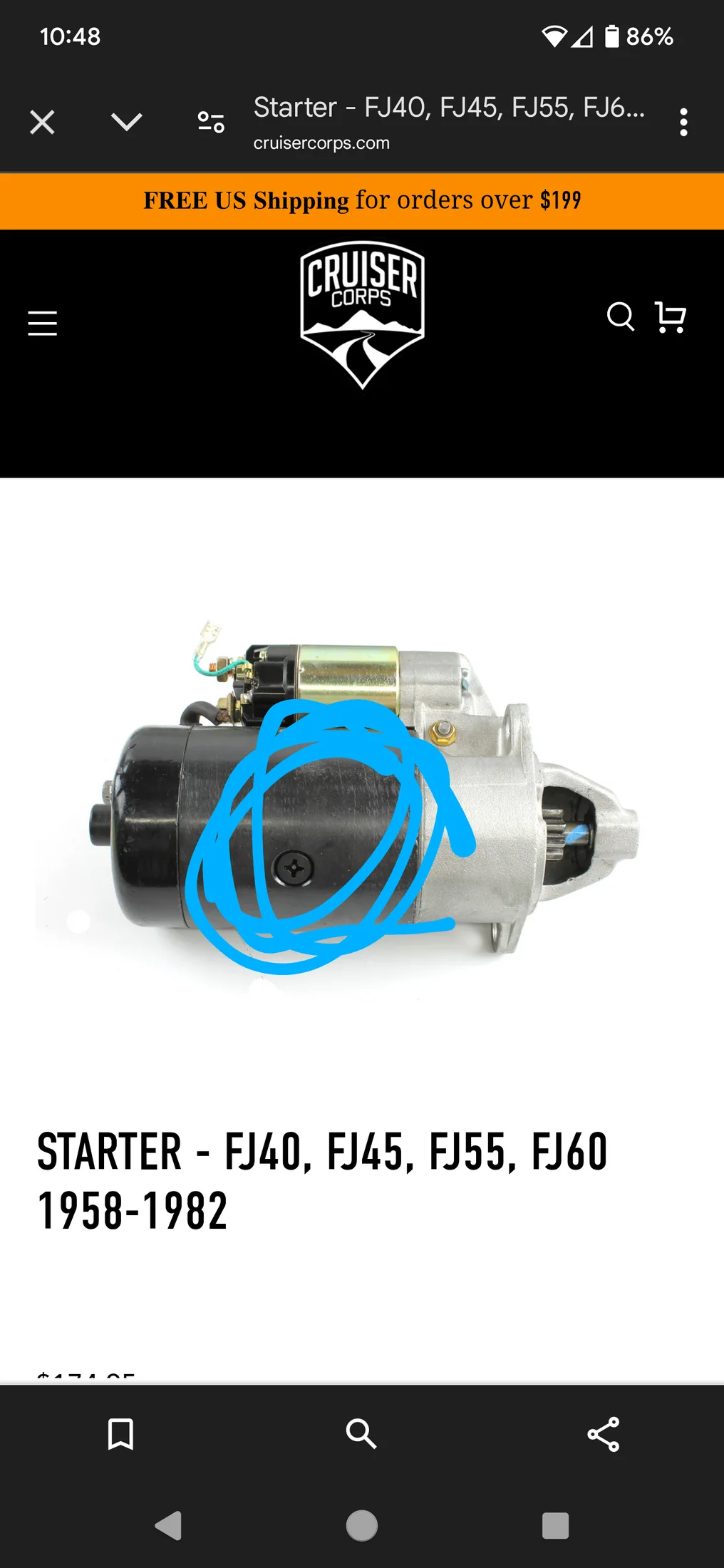

The first thing I did was put in a brand new starter.
I’d make sure that the starter was retraced/not jammed or bound up. Remove if needed. Then try and turn the engine over with a breaker bar or similar by hand. Pull plugs if needed to make that easier. Go around at least 1 full revolution, feel for if it changes (harder or easier) in any places. If it moves freely, put starter back in, try spinning motor with starter. Then if that works, start checking electrical and fuel.
If it does not turn over with starter and plugs pulled, next step in my mind is pull valve covers and start looking for valve train bound up, broken pushrod, dropped valves. You could also drain oil and make sure it’s not metallic, no chunks come out, etc. that would indicate bearing or other failures.
