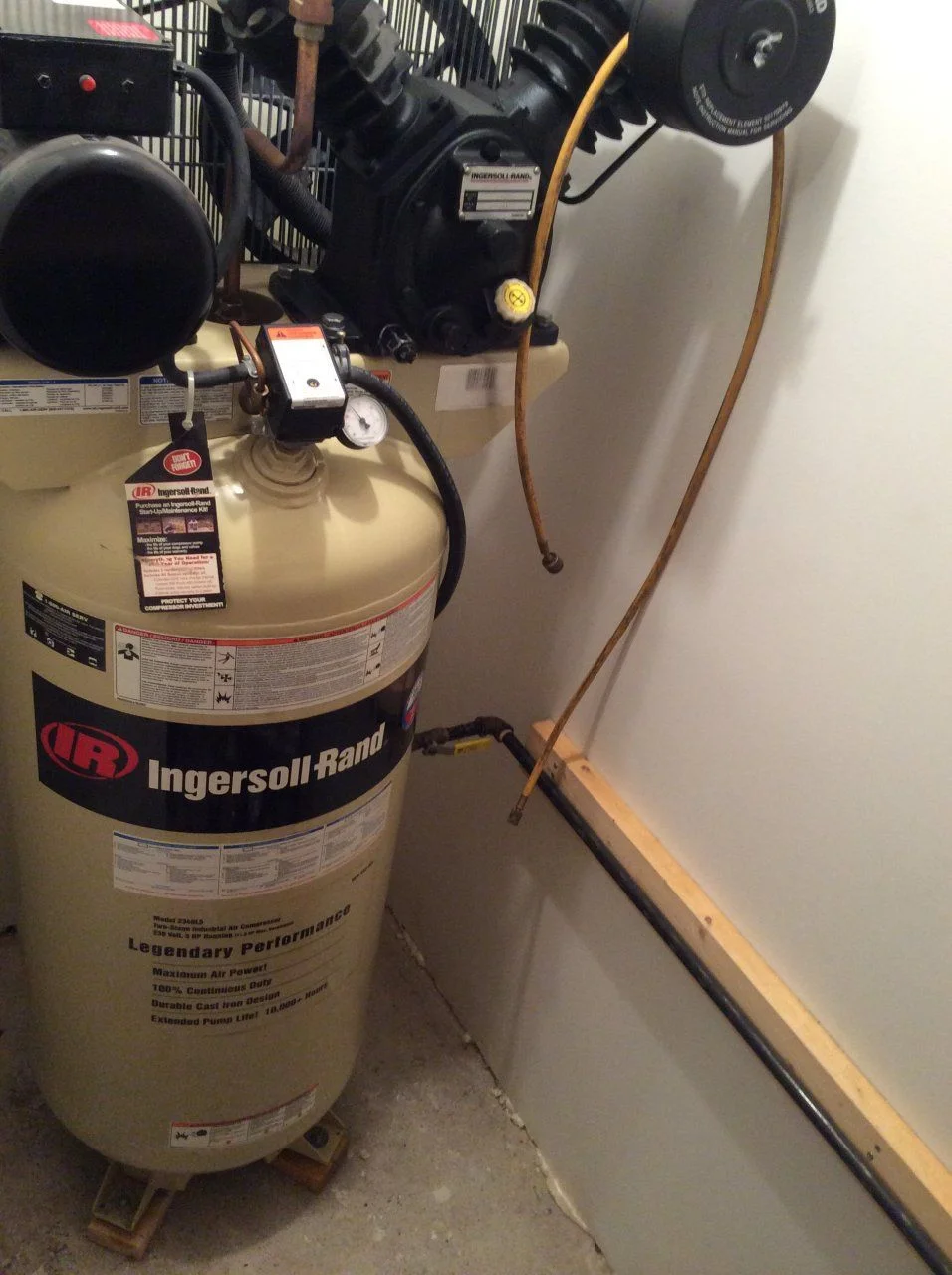

I've had my Ingersoll Rand now for over ten years now with now issues. Rated at 100% duty cycle with 14.8 CFM @ 90 psi. I've read some negative reviews, so quality and assembly could be an issue. Seems using correct wire gauge to electric motor is important to avoid motor burning out. Pump seems to be made in India according to a review in the link below. Maybe mine was built at a time when quality was better. Sometimes, it is better to buy all older model hopefully with all American made components.
http://www.aircompressorsdirect.com/Reviews/Ingersoll-Rand-2340L5.230-1-Air-Compressor/rv705.html
BTW, I got mine at Home Depot. Looks like they still sell them.

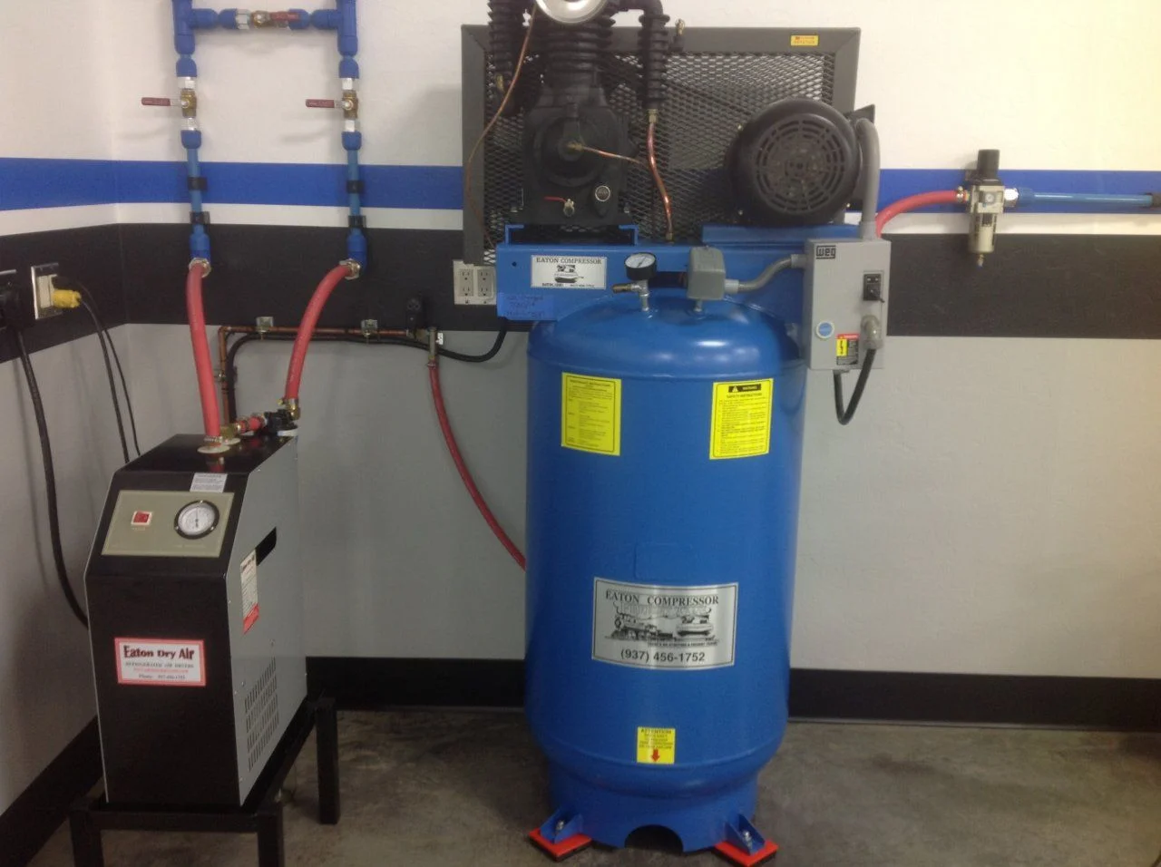

I've been running a Eaton for the past decade with zero issues as well. It has a constant run feature as well. I have recommended at least three Eaton's to friends over the years and they too have had no problems. I recommend you install a timed (adjustable) auto dump for the tank if you plan on long running durations. Clean, dry air is paramount to any shop size for a trouble free air system. I plan on adding a hour meter to my compressor for maintenance reasons.
