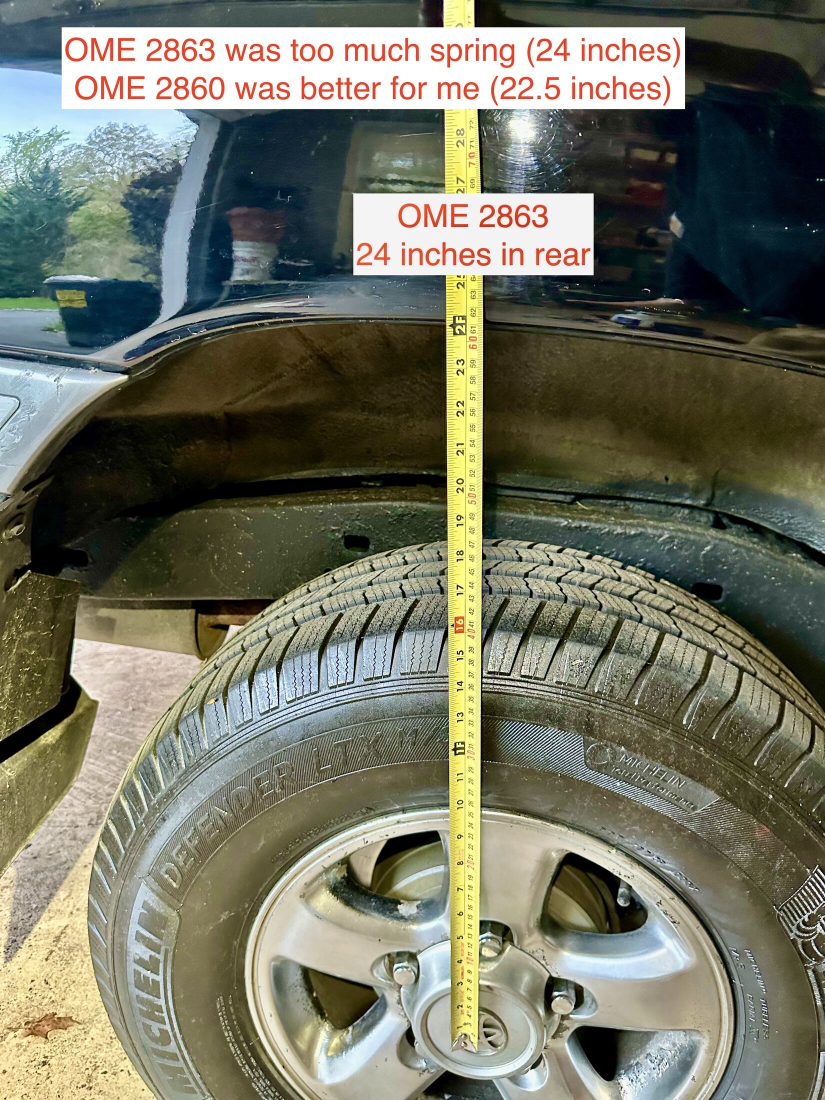

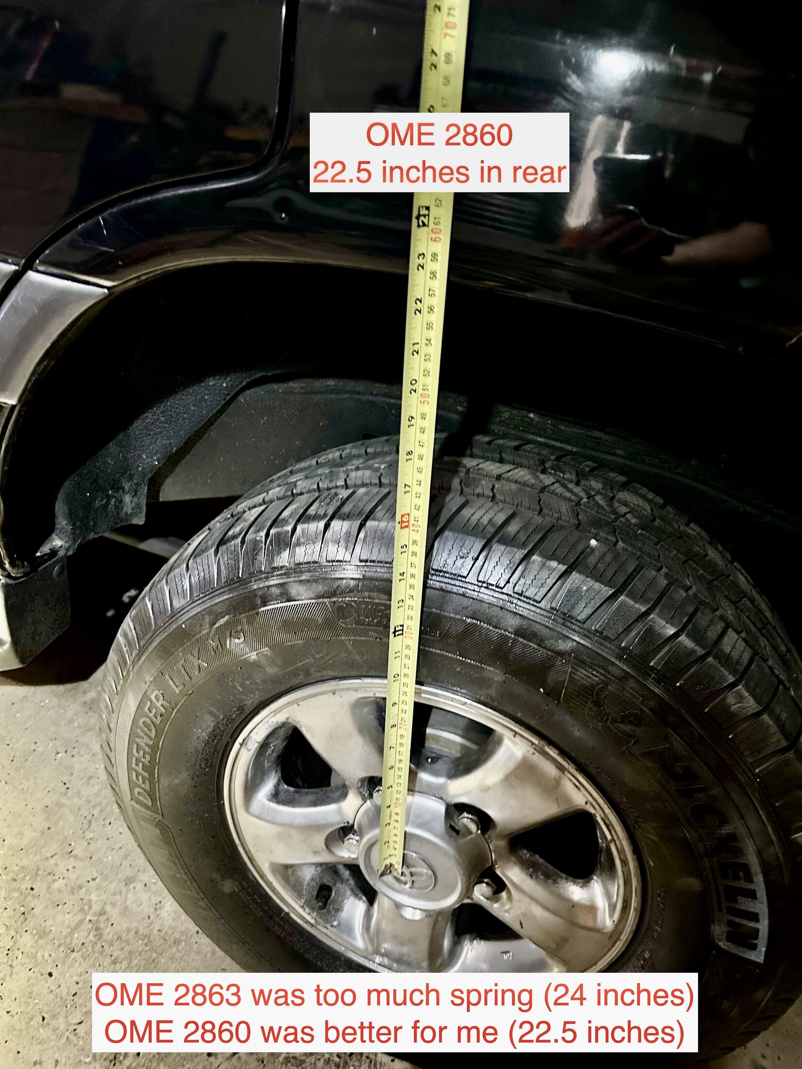

Here's what I just concluded on my 2002 Landcruiser. I have ARB bumpers on the front and the back. The original springs were shot, so I started with OME 2863, but the back was too high and couldn't get more out of my torsion bars (and not sure I wanted to anyway). Spoke to ARB tech support and told me that the 2863's were "oversprung" for my setup. So I just finished replacing them with the OME 2860's, which the tech suggested and they are much better. They will likely settle more over time, but the ride was dramatically improved after the initial 3 mile spin just now. The 2863's gave me 24 inches (hub to fender) in the rear and the 2860's were 1.5 inches lower at 22.5 inches. The front is sitting at 20 inches.
