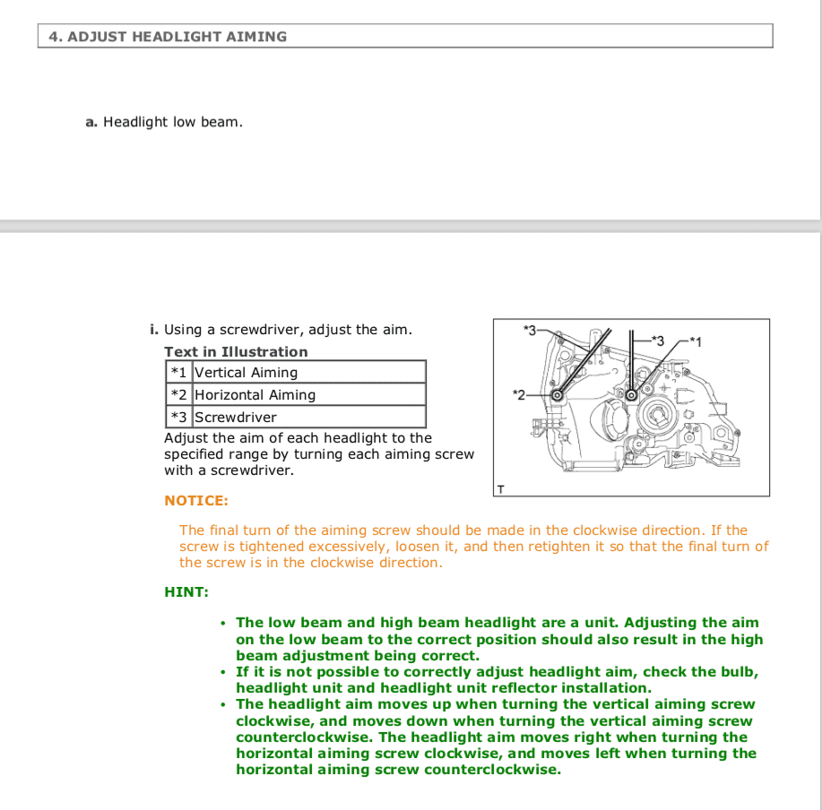

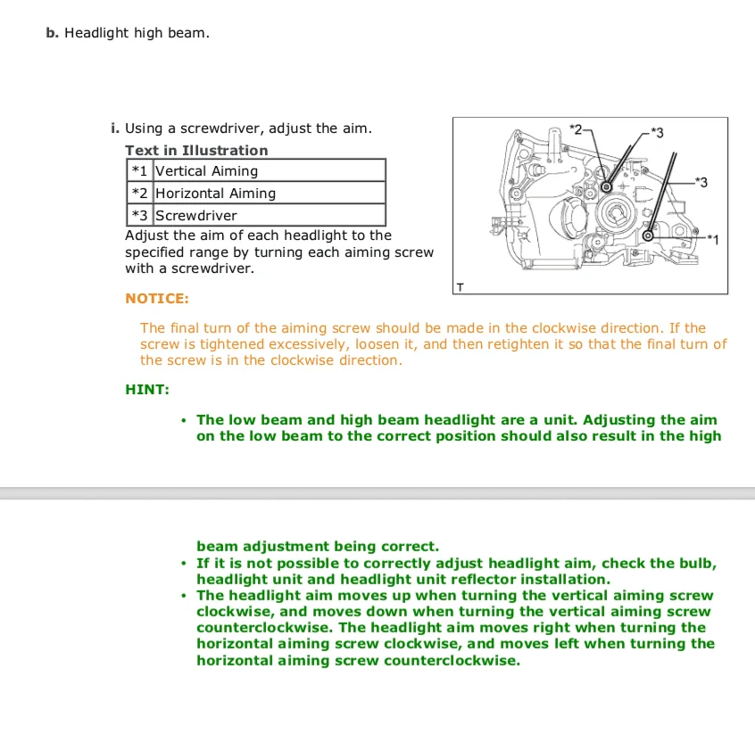

Have you ever adjusted them? Here are 10-13 HID adjustment instructions
HIDs do dim over time too... you may want to replace bulbs.
