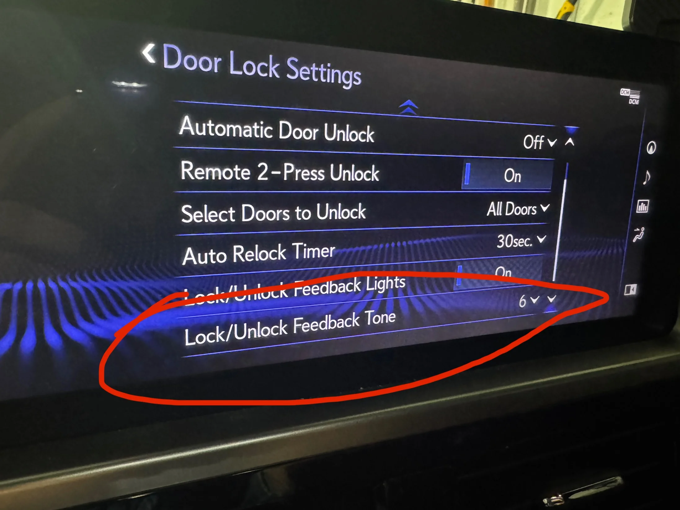

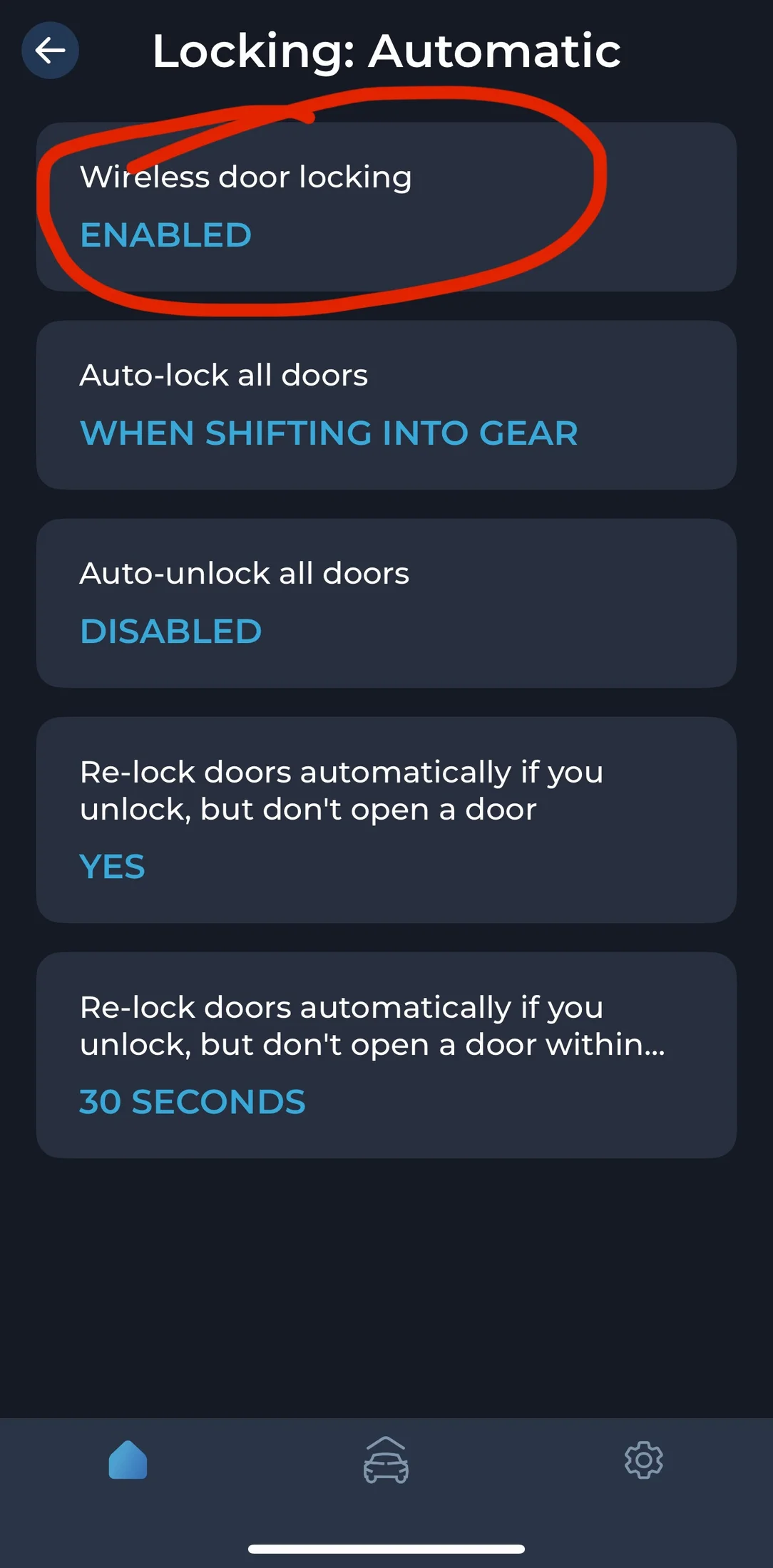

Hey all! I FIXED the issue! I wanted to share this fix as it was very annoying. I spent hours researching this fix and I wanted to share the knowledge.
Do all of this at your own risk!
1. Download Carista app
2. Either use their dongle from their website or you can use an OBDLinkMX+ like I have
3. Connect your vehicle after connecting the dongle > connect via bluetooth
4. Launch the Carista app and search for your car
5. Go to the customize settings once Carista is logged in (you will have to pay for the Carista app, I just paid the $14.99 price as this was worth my time. I promptly canceled the subscription afterwards)
6. There's a setting under Locking: Automatic called Wireless Door Locking - change this to ENABLED. Mine was disabled
7. Turn your car ignition back off and exit the vehicle. Lock the vehicle and then use your remote "remotely", it should now work
I hope this helps out anyone who's having a hard time with this issue. The $14.99 it cost me for the app was well worth my time and effort. Now, I don't have to go to the dealership!
See photos below, one shows the Lexus vehicle door lock customizations and the other two are the Carista app settings I mentioned above!
