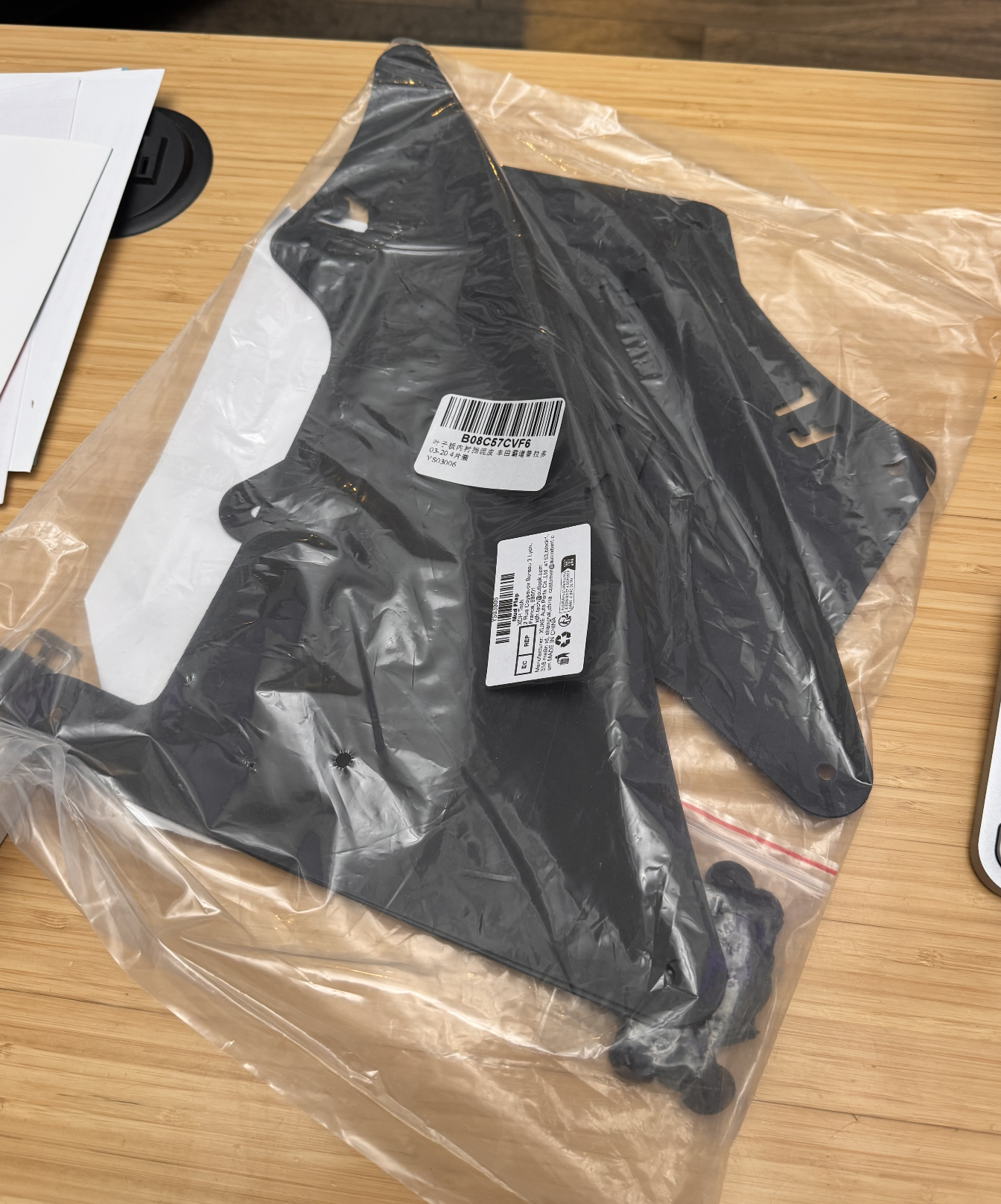

@MantaproXT11 You've inspired me to get my s*** together on my mud protection. $25 on Amazon.
